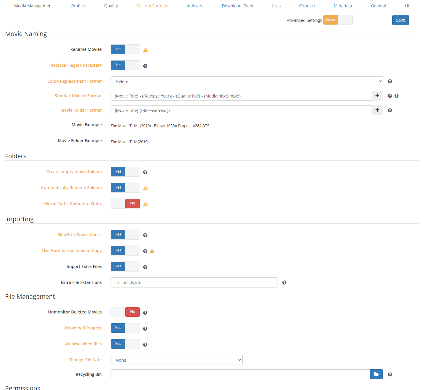

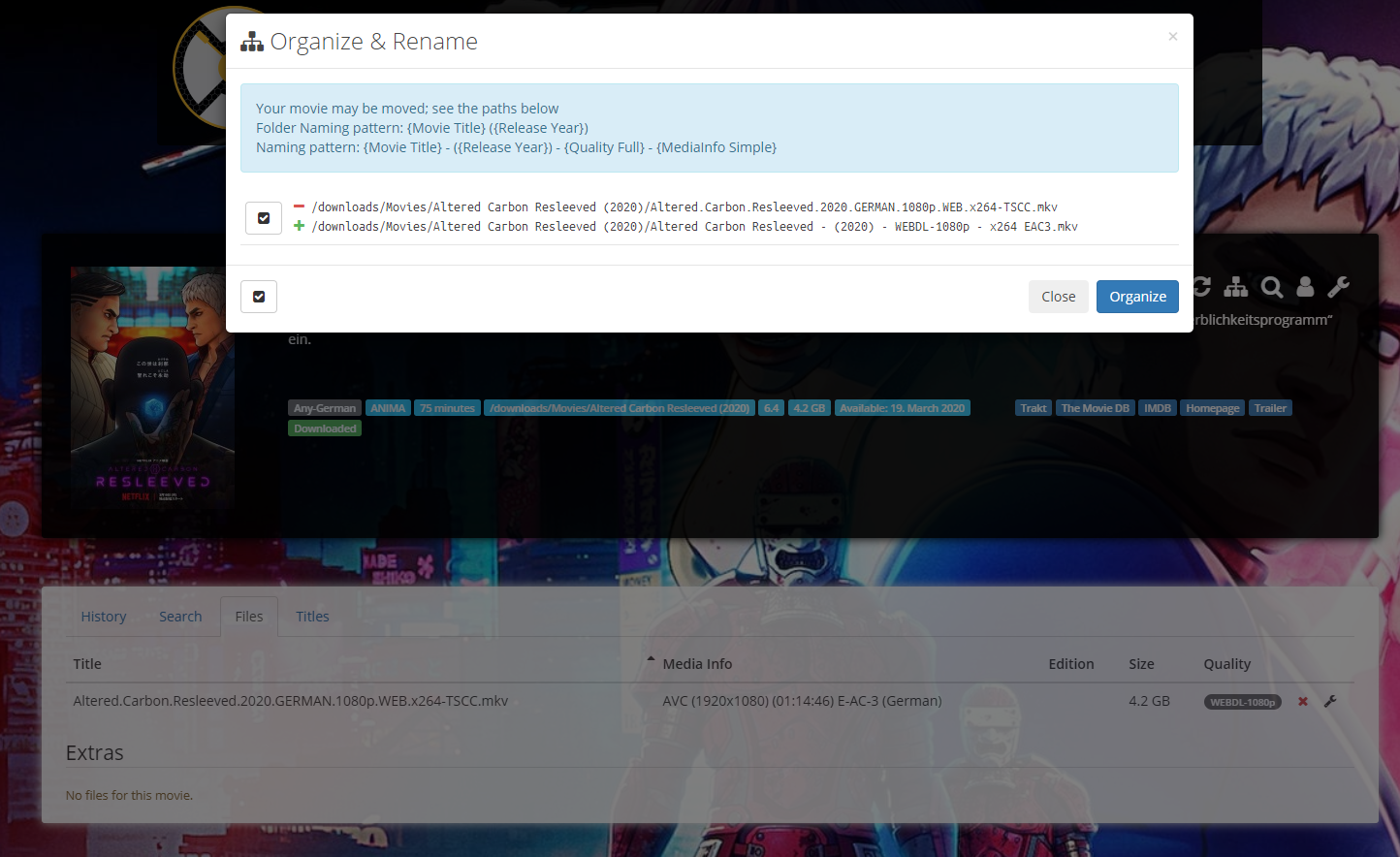

Can someone explain me, what is prevent Radarr from changing not only the path where the movie is stored during the import, because the video files itself are not getting renamed, based on my naming settings. Everythings works fine, when Radarr finds a movie via Indexer:
1. find the movie via Indexer, 2. Download via Sabnzb, 3. move files to the correct folder, 4. rename it, 5. delete the completed history in sabnzb. 6. sends signal to Plex Media Server to update the folder.
I have to change the naming one by one. Is there a function to mass change the file naming (batch function)?

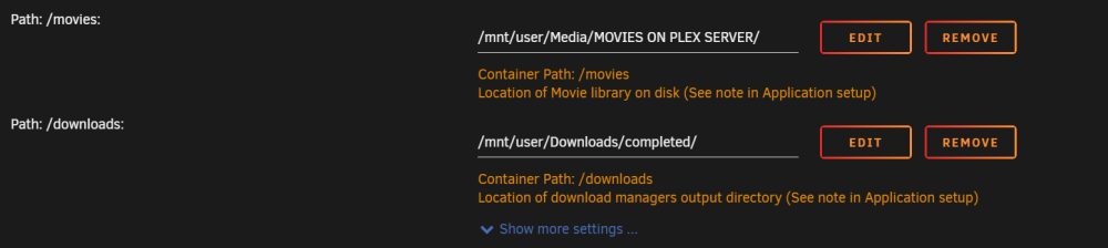

I am using the binhex-delugevpn container and have a mapping from /downloads (I changed this from the default /data as I thought that was the issue) -> /mnt/user/downloads. In radarr, the same mapping exists. I have the deluge client set up in "Download Clients" that has a category of radarr. Deluge properly starts the download and then moves the completed download to /downloads/completed in the container and finally to the category folder (Label plugin in deluge), to /downloads/completed/radarr. Nzbget works the same way moving category "radarr" downloads to /downloads/completed/radarr but while these get picked up by radarr, the completed torrent directories do not.
Any ideas? I can't seem to get this sorted out. FWIW, even when removing the extra move to /radarr (by ignoring the category/label in deluge) and leaving the completed downloads in /downloads/completed, radarr does not seem to pick them up and I have to manually move, rename, and import them. I thought about switching torrent clients altogether but since all the VPN based containers are all from binhex and behave similarly, I realized I should try to find the root cause of the issue first.

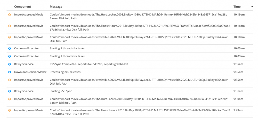

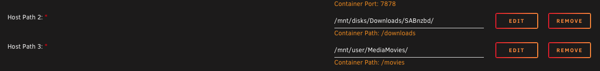

Imports with "Disk Full" errors

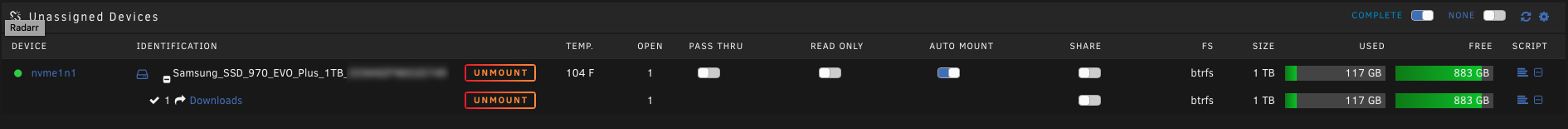

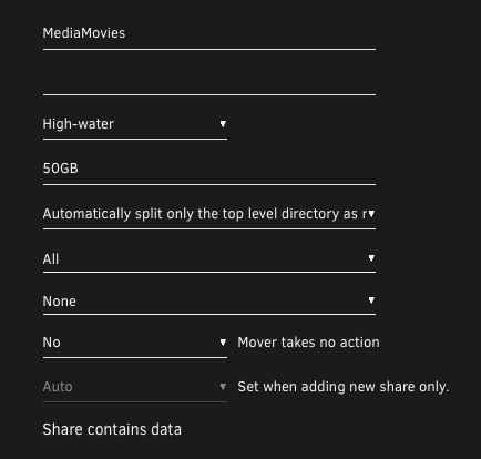

I have a bit of a head scratcher on my new server. I was hoping the community might point out what I’m doing wrong (or not understanding).
In my previous server, I had a typical configuration - the cache drive was the dumping ground for downloads from SABnzbd and then files would get moved off to the array and squared away by Radarr. I didn’t like the cache drive both holding /appdata/ and being this wild west of a download area - once, the cache filled up, the files weren’t moved off fast enough and I suffered cache corruption and had to restore from backup.
On my new server, I went a different direction. I have two NVMe 1TB drives and I decided to host the cache on one, but move the downloads off to the other as an auto-mounted unassigned drive:
1256869931_Greenshot2020-08-1810_29_06.thumb.png.5762ecf66c492595acc5490e5509707c.png
For the MediaMovies share, I set cache usage to No, because I did not want incoming files which were destined for the share to go through the cache - my thinking was, Radarr would take it’s downloads directly from the Download drive and move them on to the array as it was situating them.
As you can see from the Docker config for Radarr, /downloads is pathed to my unassigned drive folder, and my /movies path is the array share:
What I find happening is this - downloads are indeed downloaded to the dedicated NVMe drive, then Radarr seems to be having a problem moving them on to the array - I keep getting “disk full” errors when the array has plenty of space:
It’s probably something fundamental I’m misunderstanding - does anyone have any ideas or guidance?
Instead of these screenshots and text descriptions, a much more complete and unambiguous way to show us exactly how you have your dockers configured is to post their docker run commands as explained at this very first link in the Docker FAQ:
And here I thought I was being super descriptive and thorough. Oh well. Perhaps I will do as you suggest, but I don't really think it's with the Docker config. I've moved the share back to using the cache and I can see what's happening now. It's the Mover.
The movie already existed at one point on the array on Disk 2 - which is now full. So when the Mover runs to try and move it off the cache, it chooses Disk 2 to copy it to because it sees the orphaned folder on Disk 2 - ignoring the share setting minimum free space set at 100GB (Disk 2 has 10GB left) and the move fails because the upsampled movie is larger. When I actually go in to the specific disk and remove these orphaned folders, then the Mover chooses a different, non-full disk and the copy succeeds. Odd. I even tried setting that share to "Most Free" allocation, and the Mover still chooses the full disk to try and move off the movie.

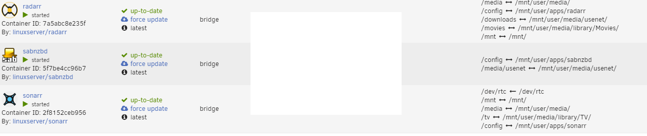

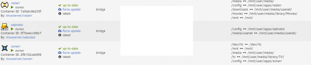

Ok so I have looked through the FAQ and alot of the recommendations and will caveat that I'm probably missing something obvious and boneheaded.....
Anyway, Radarr will not move files from the completed folder for SAB.  Sonarr has no issues and it appears everything is set up identically.  Additionally when i try to manually add it says no files are available for import.
Here is how each of the three dockers are set up:
Let me know what else you might need to help me figure this out.  TIA!!
Bump for some assistance please.
