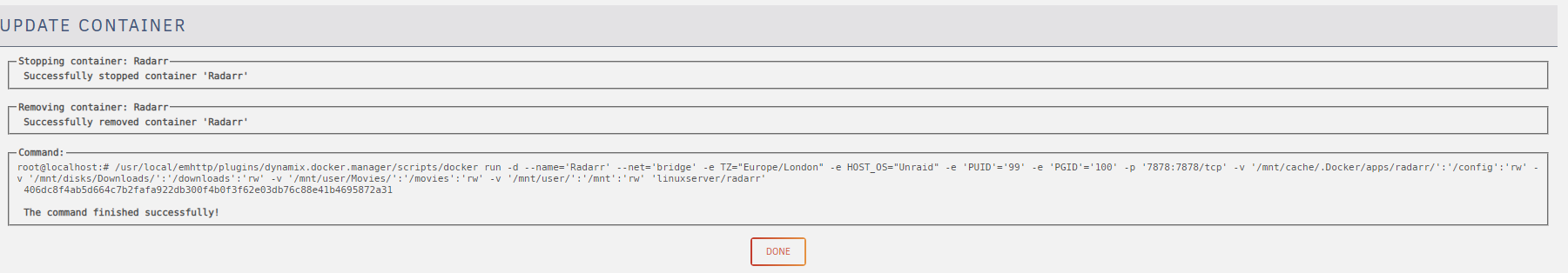

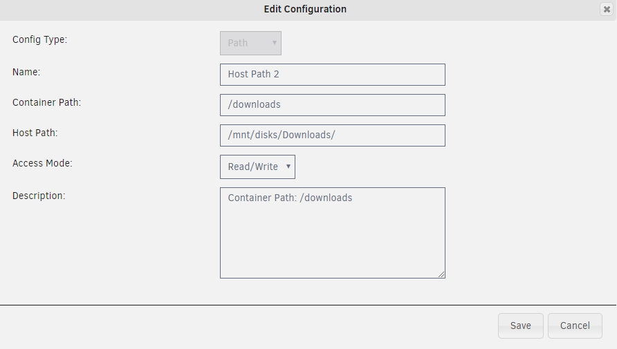

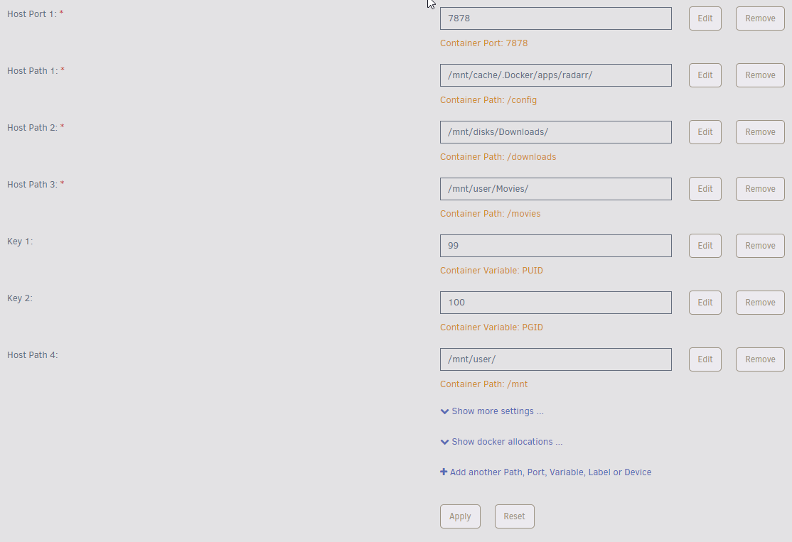

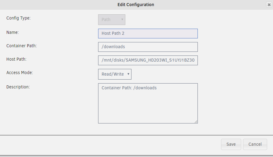

wondering if anyone could help me, I'm using unassigned drive for my downloads, used to use some old samsung drive. Now I have a new drive with Downloads share. I've managed to change the paths in all other dockers but for some reason Radarr refuses to do it.
I'm trying to change:
Container Path: /downloads
from: /mnt/disks/SAMSUNG_HD203WI_S1UYJ1BZ300571/
to: /mnt/disks/Downloads/
Doesn't matter how I do it, Edit, typing it in manually... it won't change. Even tried to remove the docker and add it again from template, still won't change the path. Tried to stop the docker and changing it to no effect, as soon as I get back to UpdateContainer it still showing the old path. Any ideas?
I think your new destination should be /mnt/user/Downloads/

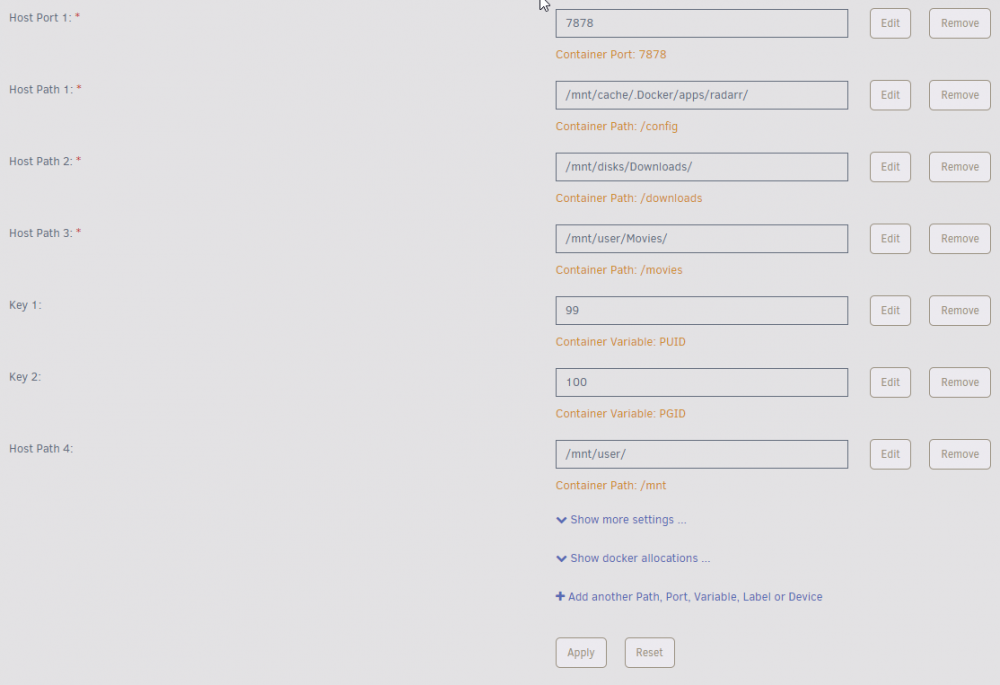

Thank you for the reply, this is how I have it in every other docker and that's what appears in dropdown menu. I don't have /mnt/user/Downloads/  I have /mnt/disks/Downloads/ and that's what Unassigned Devices is mounting. Regardless path is not a problem, docker not saving given path is a problem. Also for some reason when I click on the path it still shows my old Samsung drive which is no longer in the system and has since been removed from unraid.

So you change the setting, radarr starts (I see /mnt/disks/Downloads in the docker start screenshot) But when you update the container, it reverts back to the old drive?
Have you tried to remove the container and re-add it?

Yes this is exactly what happens, I change the path, click Apply. When I go back to it it still showing Samsung, not a new path. Tried to remove the docker and add it from template, same thing. One more thing to do is to add it completely fresh but I'm worried about Radarr not keeping it's settings. I can backup the settings and database within the app but was trying to avoid that. Do you think that's my only option?
You have a screenshot with your variables, just delete the container, delete the template and add from the apps menu.

Ok what I've done was:
1) Deleted the container
2) Deleted all files in radarr config folder
3) Used COMMUNITY APPLICATIONS to add Radarr
4) Filled all path exactly the way I wanted (/downloads to /mnt/disks/Downloads/)
5) Clicked Apply
when I go back to Update Container.... Container Path: /downloads is showing /mnt/disks/SAMSUNG_HD203WI_S1UYJ1BZ300571/
Grrr, help :/

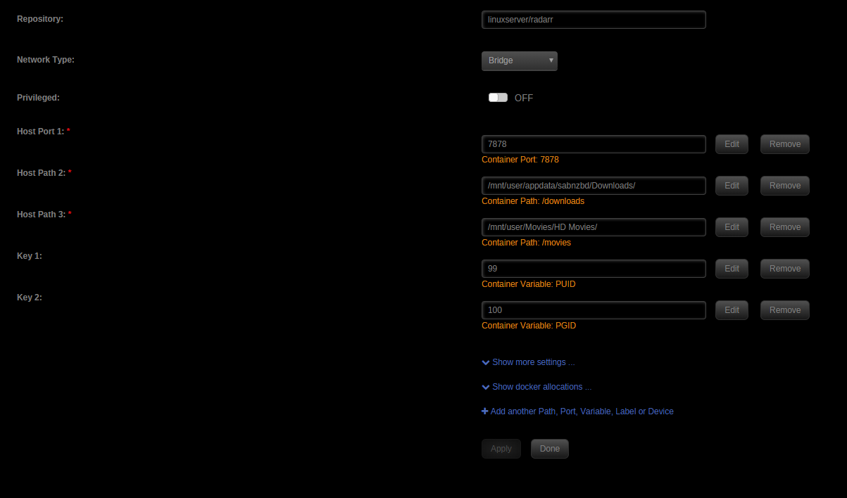

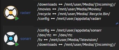

Hardlinks and by extension renames cannot traverse different file systems or mount points. You're moving from /downloads to /movies which in the container are different mounts so it will always to a copy delete instead of a renames and a hardlinks is also impossible. To do what you want you have to redo your templates for all the apps (radarr and download client) to instead pass through ,/mnt/user and reference all the folders in the app settings based upon that.
I just started playing with radarr, and have everything working ok-enough... except for imports.  My radarr is also copying files rather than moving them and can't figure out why.  Everything is mapped on the same share so it "shouldn't" be an issue of mount points.  And, the mounts are essentially the same as they are with sonarr, which works perfectly ok.  I've tried toggling the use hardlinks setting in radarr with no difference.
What am I missing here?
Also, any ideas on why radarr is not detecting some movie files and keeps them as missing?  The files are there but they are not scanned.
Edited by Energen
Because you've got it trying to hardlink from /downloads to /movies, which are different mount points within the container.  Doesn't matter that they are both on the same share

Ah I see, so if I set them both to /mnt/user or /mnt/user/Media, as previously mentioned, that would be considered the same mount points?

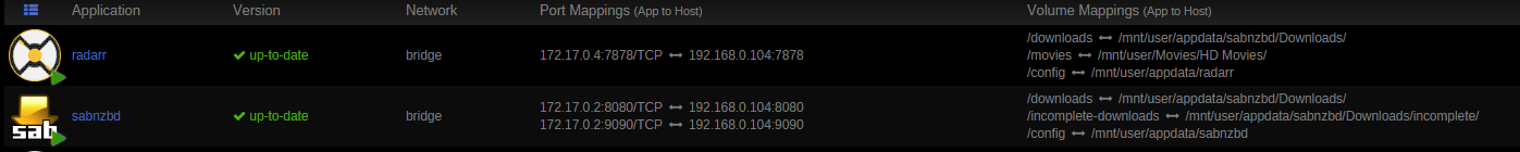

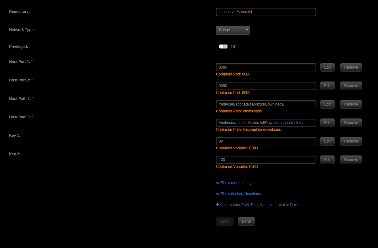

Sab is currently saving the files into /config not /downloads.  Probably in the paths section of Sab's UI, you're telling it to save it to downloads not /downloads (IIRC, sab has a message that says that all folders are relative based on its home folder.  To set a non-relative folder you need the leading slash)
