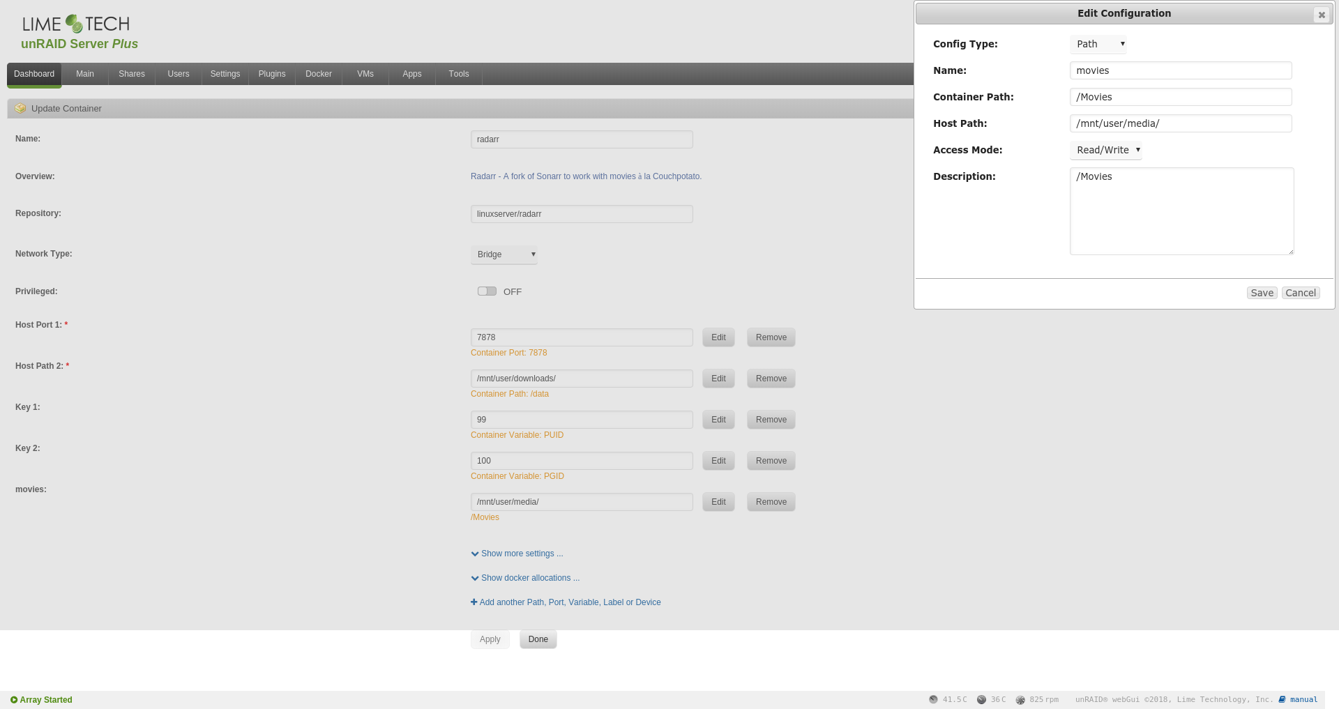

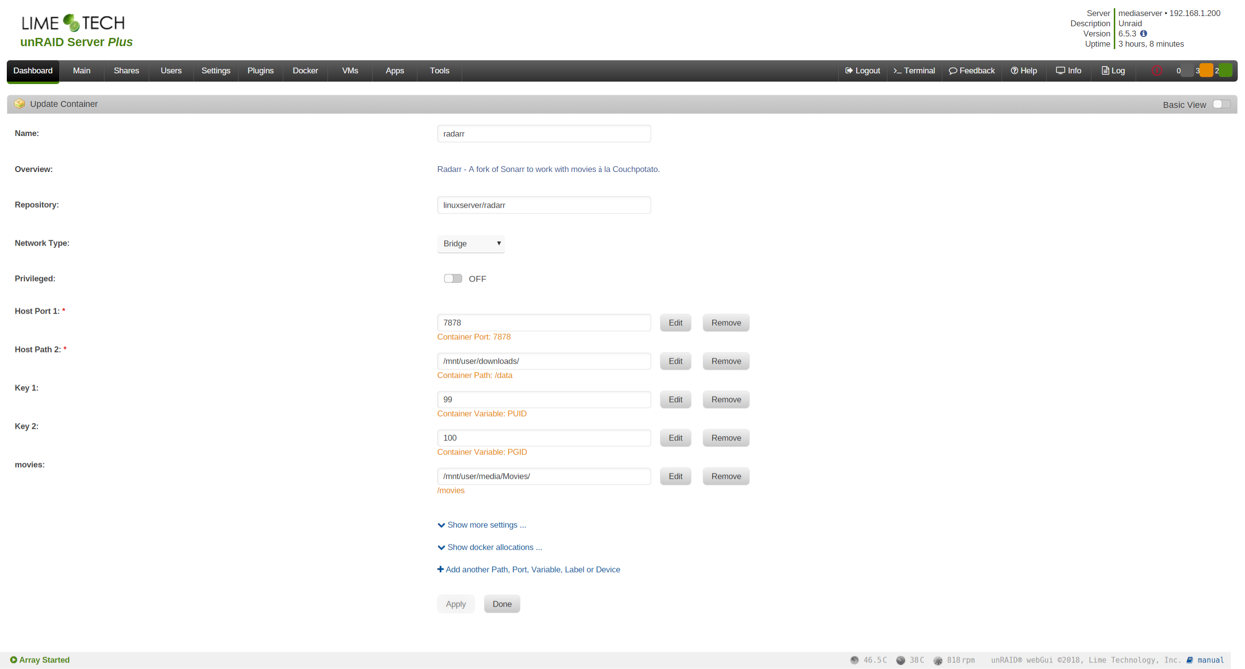

hi guys,
I'm getting really frustrated trying to sort an error, everything seems to be working fine, however, this error is always present no matter what i try.
screencapture-b4fd9fb505226e1d2422be93a9c2f61cb5f9fe8a-unraid-net-Dashboard-UpdateContainer-2018-07-22-20_08_11.png
I never used it, but you have an error in your volume mapping for /media. I guess radarr is looking for a Movies folder inside /media, but you used /mnt/user/media/Movies as the host path. If you want the movies folder to be available in /media, you must change the host path to /mnt/user/media

On 7/22/2018 at 8:08 PM, Greygoose said:
hi guys,
Did you use @binhex's version at some point?  he uses /media by default.

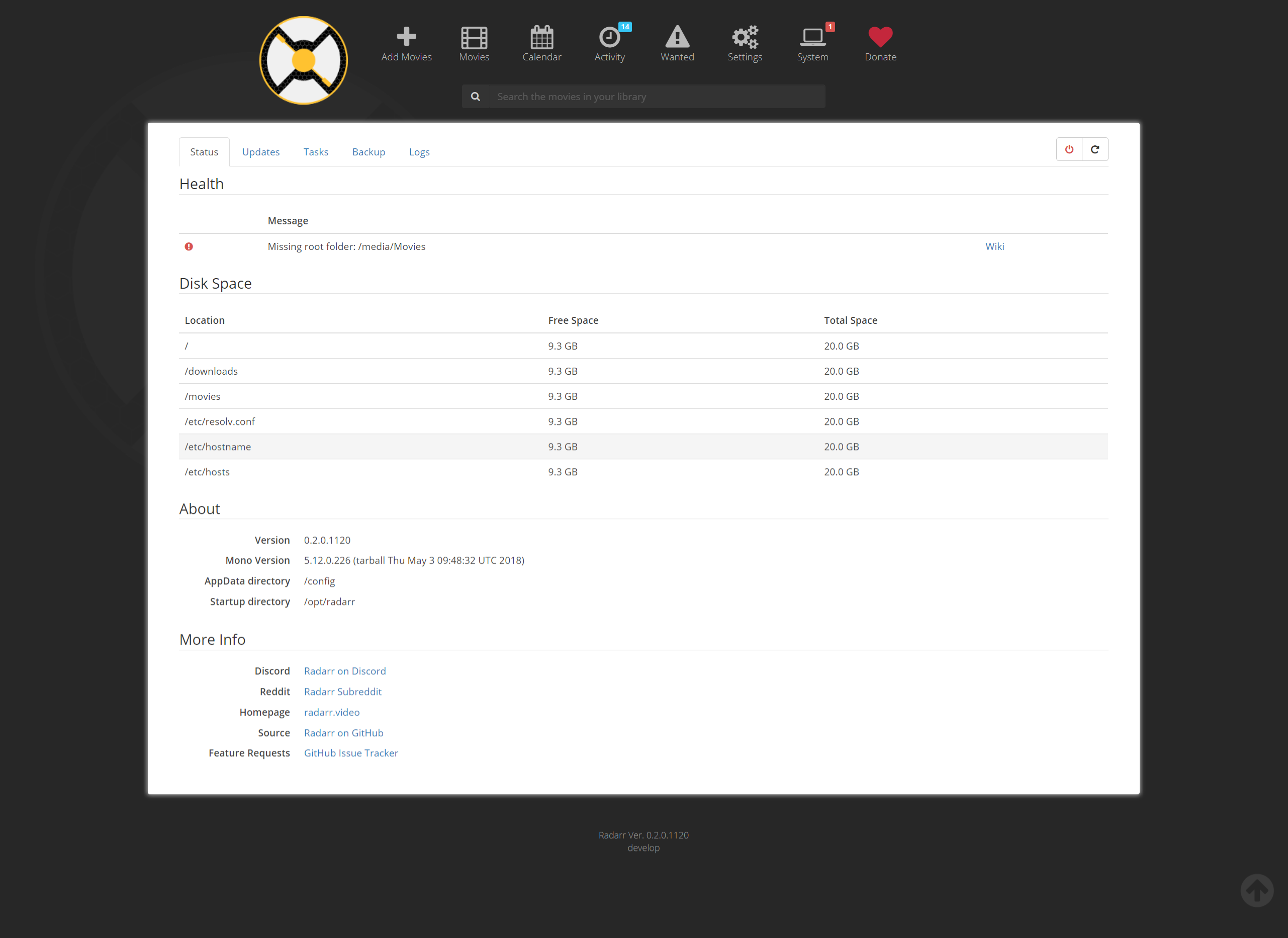

59 minutes ago, Rick Sanchez said:
Worked for about an hour and now I'm getting the same error, on your recommend settings...
Import failed, path does not exist or is not accessible by Radarr:

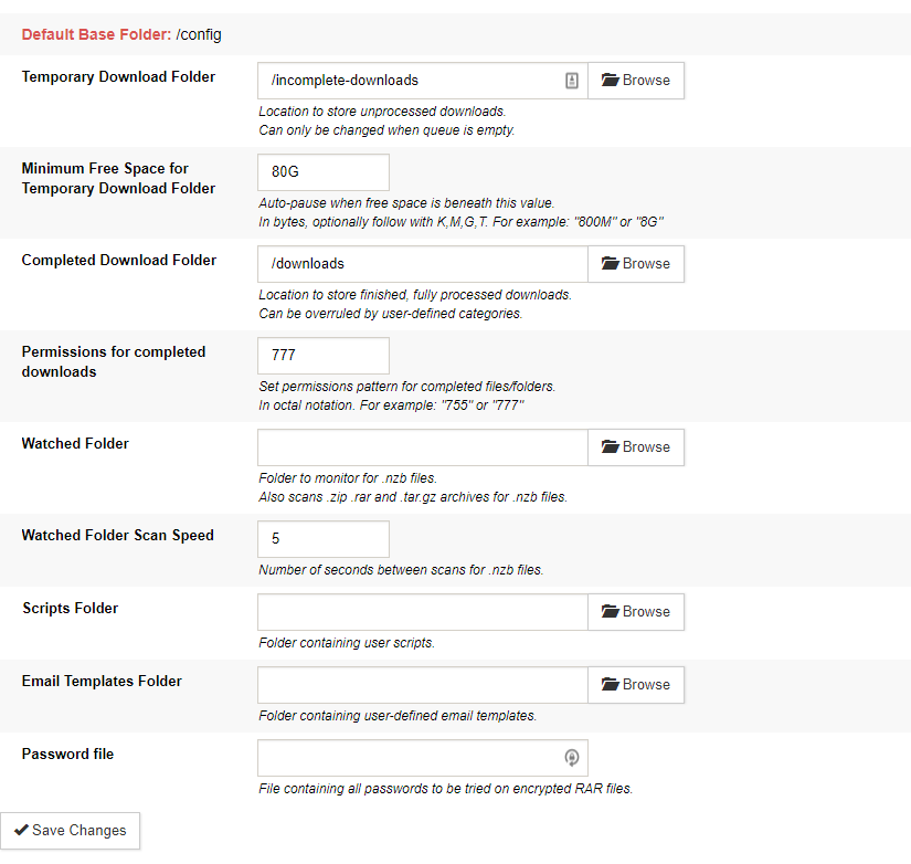

Post your docker run commands for both containers and screenshots of your sabnzbd and radarr configurations.
Sonarr
Radarr
Edited by Rick Sanchez
/downloads
It is not a continuous error. It seems to appear randomly and states it is not accessible.
New downloads or old ones already queued before you made the adjustments.
/downloads
I did, I have changed my host path to the following but im still getting the error
screencapture-b4fd9fb505226e1d2422be93a9c2f61cb5f9fe8a-unraid-net-Dashboard-UpdateContainer-2018-07-31-18_31_05.png
It's a remnant of that, no idea how to fix it, might be worth asking the Radarr guys.....
