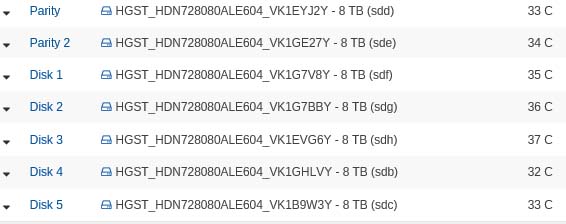

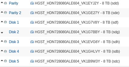

Noticed a STRANGE display anomaly this afternoon ...
The following snippets are from my 3 servers ...  (all have been updated to 6.4 in the past couple weeks)
This one has some disks spun up, some spun down, and shows the correct indicators ...
This one has all disks spun up, and also shows the correct indicators ....
This one has all disks spun up (note the temps are displayed) ... but is missing the "green ball" to show the spun up status.
... but the same server DOES show the white ball to indicate spun down status (note I spun up disk 2 after spinning them all down to see if that would change the spun up indicator back to normal -- it did not).
I've never seen this before -- and the server that had this issue has been working just fine.
FWIW I powered down the server and then rebooted it, and the display is now working normally.   Just curious if anyone has any idea about what might have happened.

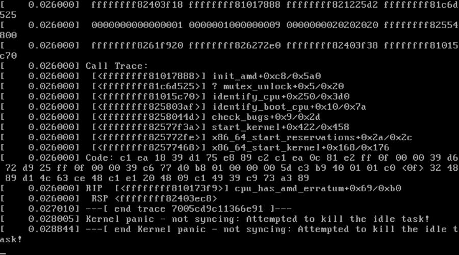

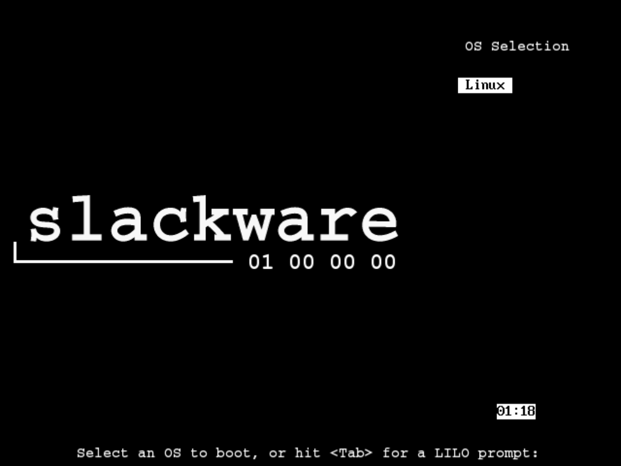

hello, so i have a pb with an upgrade to 6.4.0 from 6.3.5 .
a VM slackware  64 14.2 has a kernel panic at startup.
the server is new, i just created 2 VM , a debian and a slackware, they were up and running on 6.3.5 .
that's all i did not even started to do something with them just created an started.
with 6.4.0 , the debian VM is still running ok.
but not the slackware. the boot screen is ok , the kernel start but panic immediately.
if try to create another VM ,  i have the grub page and nothing more after.
here diagnostic and screnshoot.
Pascal.
Templates
aserv1-diagnostics-20180126-1411.zip
