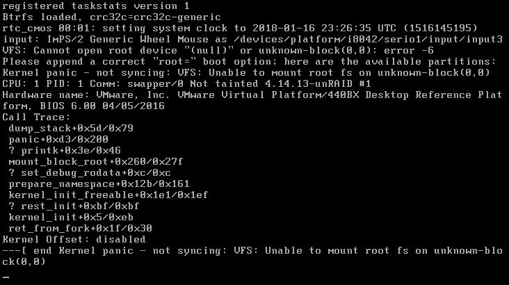

I upgraded today from rc20 (I think), and when I rebooted my server, it never came back up.  I can't connect to it via the IP, nor with Putty.  I hard rebooted it (a couple times), and still cannot reach the server.
I then connected my monitor, and I can't see that it's even trying to do anything.  None of the HDMI ports display anything on my monitor, they all result in the monitor saying no input found.
I've removed the USB, and downloaded directly from limetech servers, checked the MD5 is correct and ran a check disk on the USB.  I've put it back in the server, and booted, and I still get nothing on the monitor.  not with the motherboard HDMI (which is what used to work), nor from either of the 2 video cards.
I really don't know what the next troubleshooting step is here.
Do you see or can get into the motherboard bios? If not the problem isn't unRAID, if yes when do you lose video output?
And here was me being parranoid and removing some of the "known" problematic plugins mentioned in this thread prior to rebooting o.O
Anyone else using ESXi have issues updating?
I get the same error whether I try and boot into safemode or not.  Everything was running fine before the reboot/upgrade.  I'm on ESXi 6.5.0 and PLOP.

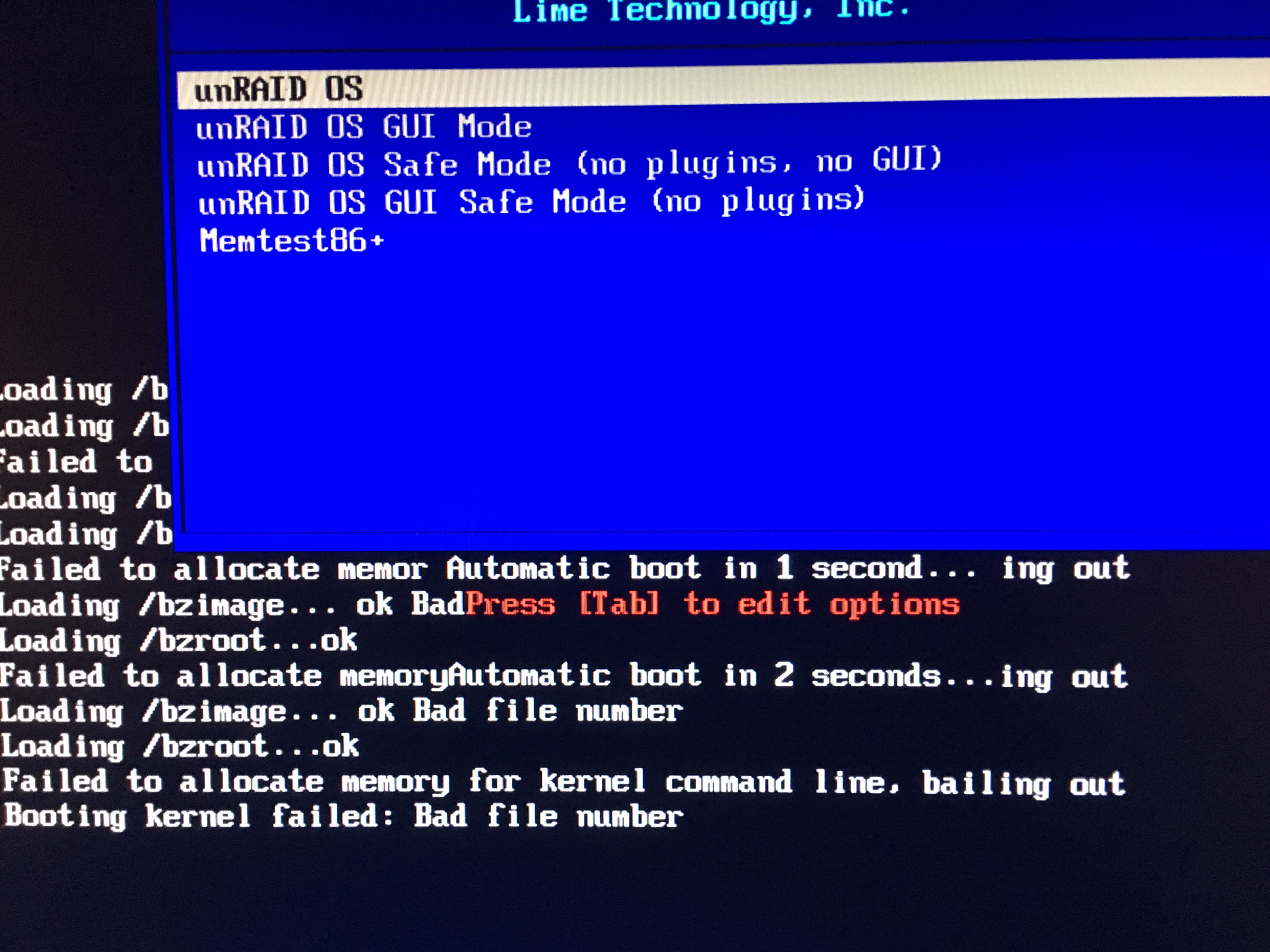

Failed to Allocate memory for Kernel command line, bailing out
booting kernel failed: bad file number
-UnRaid Trial- 18days remaining
  1. Created a 6.3.5 USB using the USB creator tool for windows. Started the Trial for 2 weeks with MBR BIOS boot.
  2. Saw that the new stable 6.4.0 was out, used the WebGUI to update
  3. Reboot required
  4. Upon loaded WebGUI enabled UEFI in the Flash media on main page (so far so good) Reboot
  5. (Set Server BIOS settings to default) Changed my Servers BIOS system setting to boot to UEFI
  6. Deleted previous UEFI boot menu paths (Windows, ESXi..etc)
  7. Created a UEFI boot entry pointing to /EFI/Boot/Boot64.efi (1st attempt I did not create a UEFI boot path same result)
  8. Rebooted server
  9. UnRaid Boots up in UEFI
  10. Auto boot count down
  11.      loading bzroot...ok
  12. "Failed to Allocate memory for Kernel command line, bailing out
    booting kernel failed: bad file number"
I had this same issue prior to starting the trial creating a 6.4.0RC19 Boot usb. Just I knew there was not going to be any support for a BETA now that 6.4.0 is stable any Ideas or possible solutions.
I should also note that all of the boot options including memtest all have the same failed message as above.
I can only Tab to edit >/bzimage initrd=/bzroot_
I really don't want to be stuck using legacy boot mode. Thanks in advance to any suggestions or help.
[EDIT] 01/16/2018 @9:55p
So after a little research apparently This is an old issue from 05/2015 with Syslinux and Dell Poweredge R410. T420,
 R320 servers, Though why would esxi Work, it is also syslinux? I also Started a New thread in General Support on this topic, If you would like to help or provide any leads please head over there. Thansk!
> the message comes from main.c when allocate_pages() fails.
> allocate_pages() is just a wrapper that calls BS->AllocatePages.
http://www.syslinux.org/archives/2015-April/023398.html
http://www.syslinux.org/archives/2015-May/023466.html
https://github.com/geneC/syslinux/blob/master/efi/main.c
I
Dell PowerEdge T420  | 24gb ECC Ram | 2x 12core Xeon E5-2420 | 5 Drives (1TB parity | 3TB | 500GB cache)
Edited by h3xcmd
