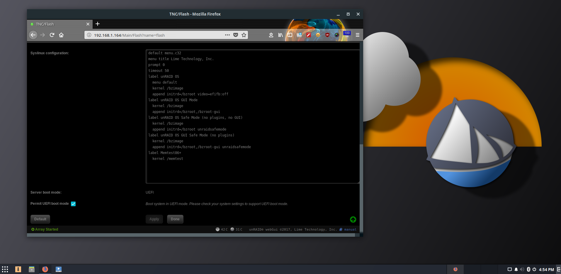

On 1/14/2018 at 9:44 AM, limetech said:
Try adding to your append line in syslinux:
video=efifb:off
From: https://www.redhat.com/archives/vfio-users/2016-April/msg00236.html
Please report if this solves the problem.
I'm confirm  it working for me , I can boot up my 2 VM with UEFI enable with out video problem
