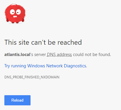

Https. This is starting to feel like a mess. Https redirects to the local domain name ("atlantis.local" for me) and then my browser throws an error, which is attached. I will use http for now because I have to, but what is going on?
It worked perfectly until I used mc to backup all the data off of disk one. Been doing this since, despite me adding the ip address to my hosts file.
I have the same issue. Made a thread about it here but no solution so far:
You have a different issue, though both or our are issues are related to ssl.
Added ability to set your own TLD in the next release, including setting it blank.  Prob will solve this for you.
That sounds great, thank you.
I'll try to look into the cert stuff on my side more later. Seems weird with a the router and dns both set to allow it that it's failing to do provisioning.
