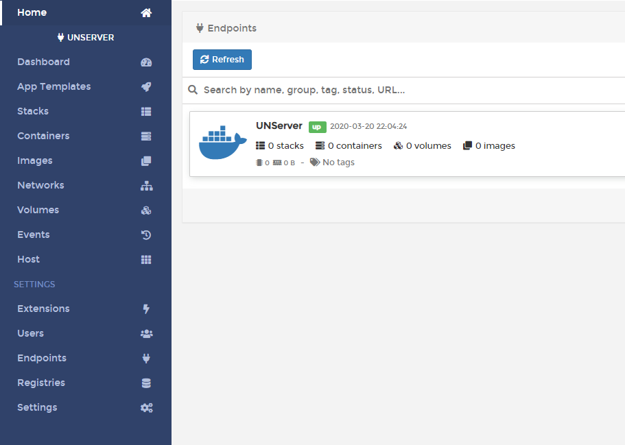

March 21, 20206 yr I installed the docker and was able to change my password but it won't actually connect to anything within UNRaid's dockers? Anyone have any ideas?

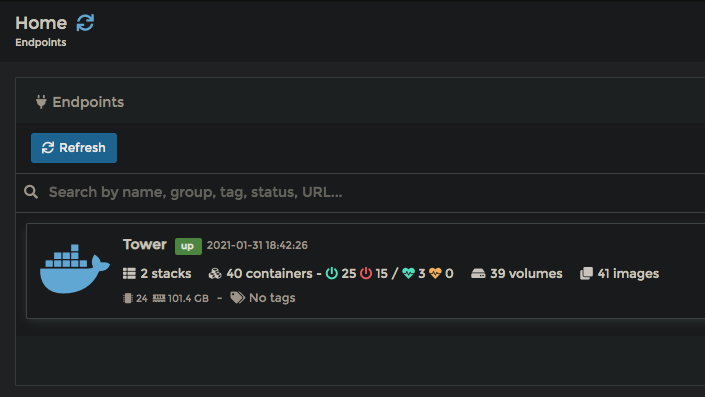

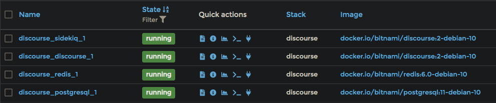

January 31, 20215 yr This template's docker-compose is limited to versions below 3 because it actually uses libcompose to interpret the docker-compose.yml scripts which is limited: I got it to work using a recent Beta that supports version 3 of docker-compose scripts because it uses the actual docker-compose binary: I just had to change: Repository -> portainerci/portainer:2.1 Docker Hub URL -> https://registry.hub.docker.com/r/portainerci/portainer/ Now I can use modern deployment stacks for stuff like discourse and artifactory. Edited January 31, 20215 yr by frakman1

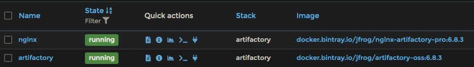

January 31, 20215 yr On 1/17/2019 at 3:41 PM, SFyffe said: What is the default user account and password for Portainer? I tried passing in --no-auth as an additional argument but I can not get past the login page for the WebUI. Thank You. @SFyffe There is no default password. You get to set it when you first log in. The username is still admin. If you still can't get it to work (you already set it to something but forgot it), you can reset it like this: 1- Stop the Portainer Container 2- Run: $ docker run --rm -v portainer_data:/data portainer/helper-reset-password Unable to find image 'portainer/helper-reset-password:latest' locally latest: Pulling from portainer/helper-reset-password 79916c70cb9e: Pull complete 93e26fa95550: Pull complete Digest: sha256:735a809b1bfe14b5fae340d4b350bae97c2016371c47fb6e34d71a45e4512f79 Status: Downloaded newer image for portainer/helper-reset-password:latest 2021/01/31 23:53:17 Password succesfully updated for user: admin 2021/01/31 23:53:17 Use the following password to login: 825GwA.n~i(he*dF1)7BkXg3}0Z+Vj9{ 3- Start the Portainer Container and login with the above credentials Edited January 31, 20215 yr by frakman1

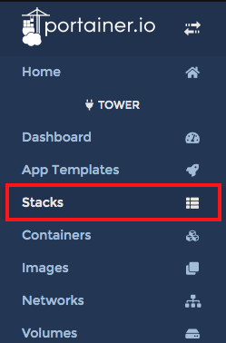

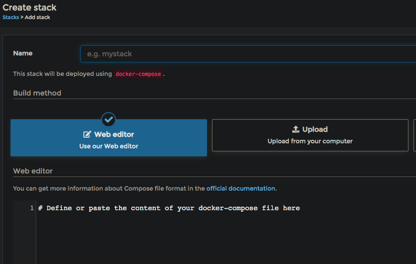

February 2, 20215 yr 17 hours ago, ffhelllskjdje said: How do you use docker compose with this? I have the beta installed like you instructed in this post. Click on Stacks in left frame. Then click on Add Stack Give it a name and use the default Web Editor to paste your docker-compose.yml file

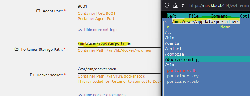

February 2, 20251 yr Dear all, im trying to understand the Storage Path, if i create a Volume in Portainer it creates it in /var/lib/docker/volumes instead of /mnt/user/appdata/portainer what can i do to tell the agent to create it in /mnt/user/appdata/portainer? Thank you
