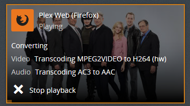

If you do get a Plex Pass (just pay $4.99 for one month to try it out and see what it can do for you) to enable hardware transcoding, you will see something like this on the Plex server Status screen when content is streaming:
The (hw) indicates the media is being transcoded in hardware from MPEG2 to H264
