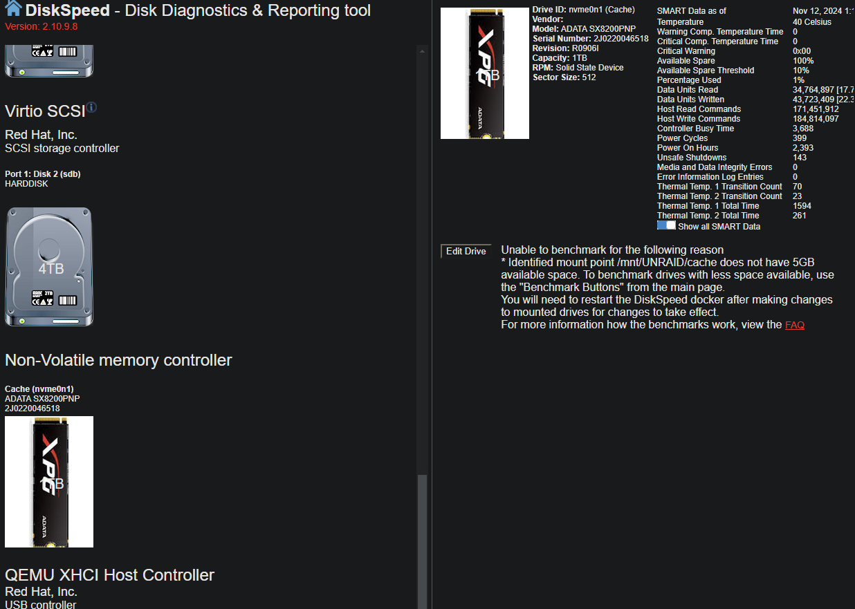

I can see all my drives but when I click on my Cache NVME to bench it I get the following error:
Unable to benchmark for the following reason
* Identified mount point /mnt/UNRAID/cache does not have 5GB available space. To benchmark drives with less space available, use the "Benchmark Buttons" from the main page.
You will need to restart the DiskSpeed docker after making changes to mounted drives for changes to take effect.
For more information how the benchmarks work, view the FAQ
I have /mnt/UNRAID to /mnt and also /mnt/UNRAID/Downloads to /mnt/user/Downloads.  The second one is where the cache drive share is, figured it was worth a shot, doesn't work with or without it either.  The drive is empty and has 1tb free.
It only needs /mnt on the host mapped to /mnt/UNRAID on the docker. Ensure you have it set to Read/Write as well.
You can also try clicking on the DiskSpeed docker icon and selecting "Console", then entering "df | grep cache$" and see what the free percentage is that Docker sees.
Seems to have started working now.  I did add another nvme though.  I'm guessing that if diskspeed is running off of the nvme I'm testing on, it will get much lower speeds 😆
It shouldn't, it does log things as it runs but the impact wouldn't be high enough to be noticeable, no more than the margin of error from running any kind of benchmark on any device over & over.

Hello guys, Is there anyway to check UNASSIGNED DEVICES ?
Normal attached disks (Sata for example), are working fine, but for some reason usb attached disks wont let me test the speed, its there any workaround so It will let me test the usb attached disks speeds ?
Thanks in advance.
The current version doesn't allow benchmarking USB attached drives. I do plan on adding support in the futureTM
