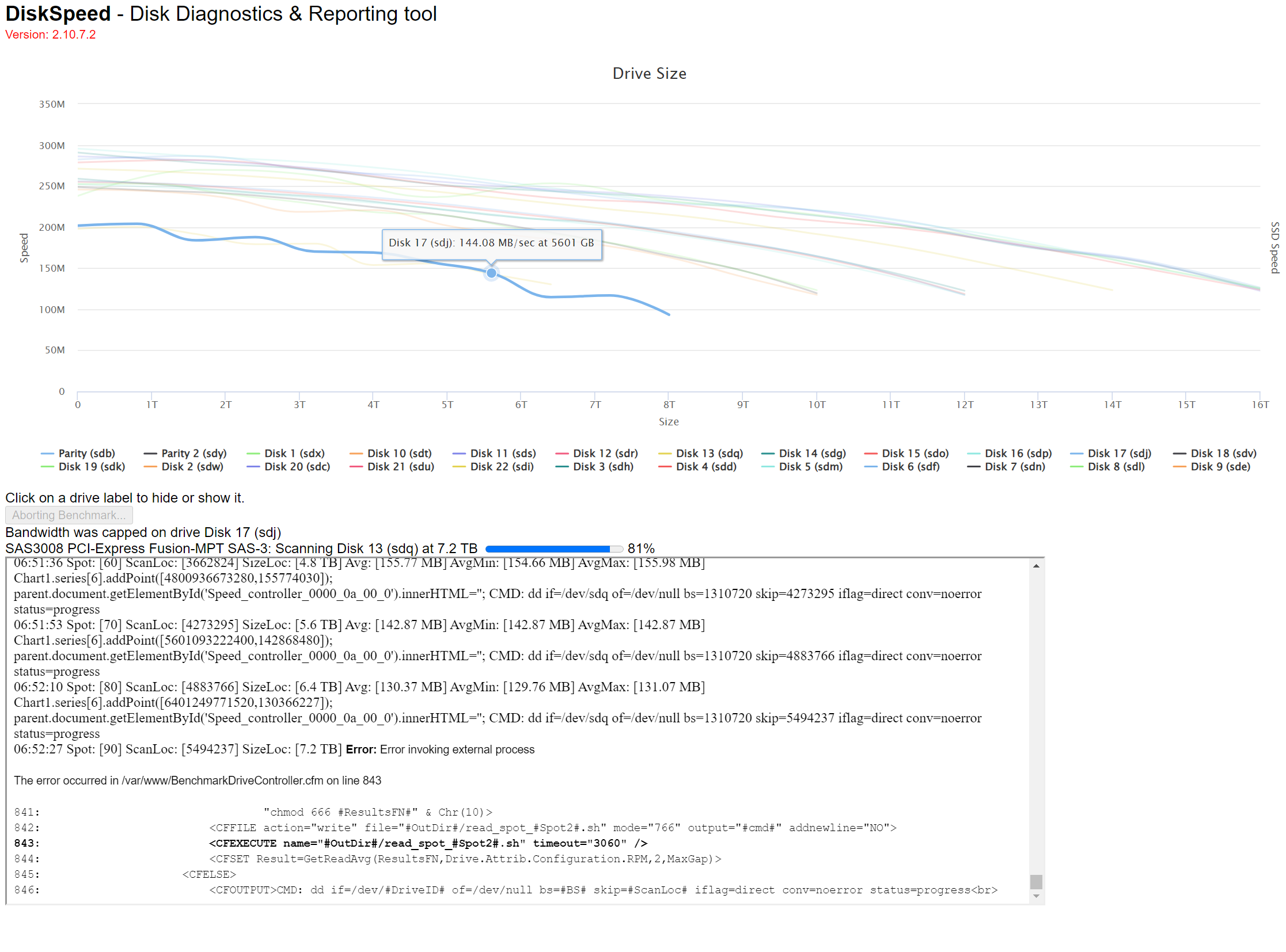

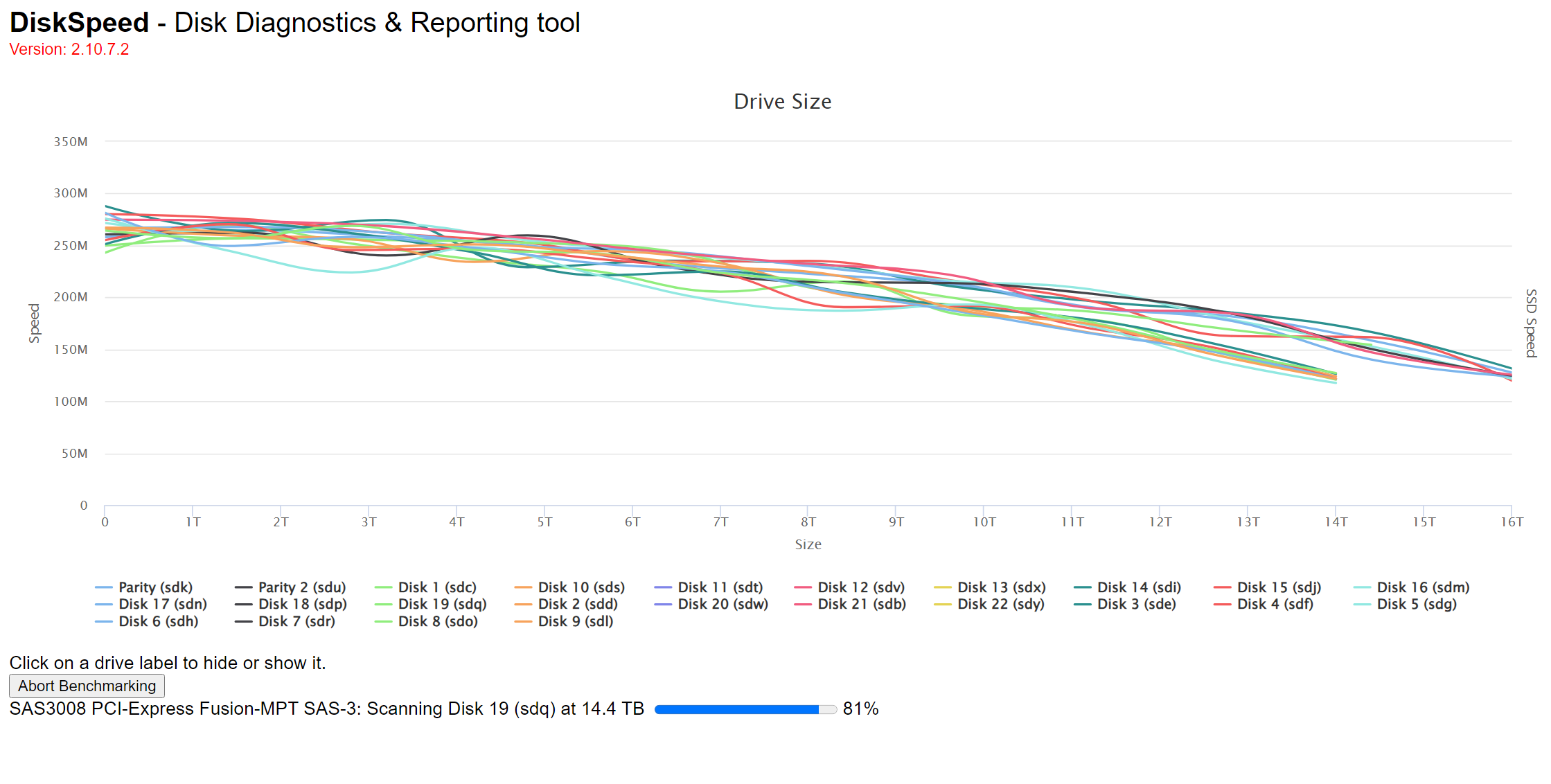

image.thumb.png.9d86b5e0ad710493221f002974a0568f.pngI have 24 drives in each server.
The above server still gets the error even with the speedgap box checked.
The below server, also with speedgap box checked, just stops/freezes.
The screenshots are where they errored (above) or froze (below).
You mentioned a 50 minute timeout...I don't know if that's exactly how long they ran for but it's really close to about an hour when I either get the error (above) or it freezes (below)....is there a way for me to increase to see if it makes a difference.?
Then I think that's the issue. It looks like the main process is timing out after the configured 50 minutes before it finishes doing all the drives on the system. I figured that would be enough but nope, looks like it's not. Didn't want to omit any timeout in case of a rogue runaway process - should never happen but when you deal with computers, the "never happens" can be known to happen. I'll update the timeout to 2 hours. It's possible that the Lucee app server is ending the process but before the "Show this error" is displayed so it looks like it freezes instead.

Version 2.10.7.3 has been pushed with the increased timeout and typo correction.

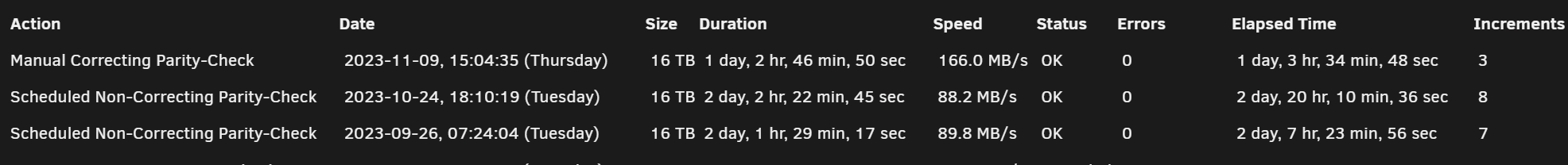

So the parity check slowed down toward the end so it took 26 hours instead of the estimated 20 hours at the start....but that's still about a reduction of 50%....I'll take that every day and twice on Sundays. 🙂
Thanks again!!

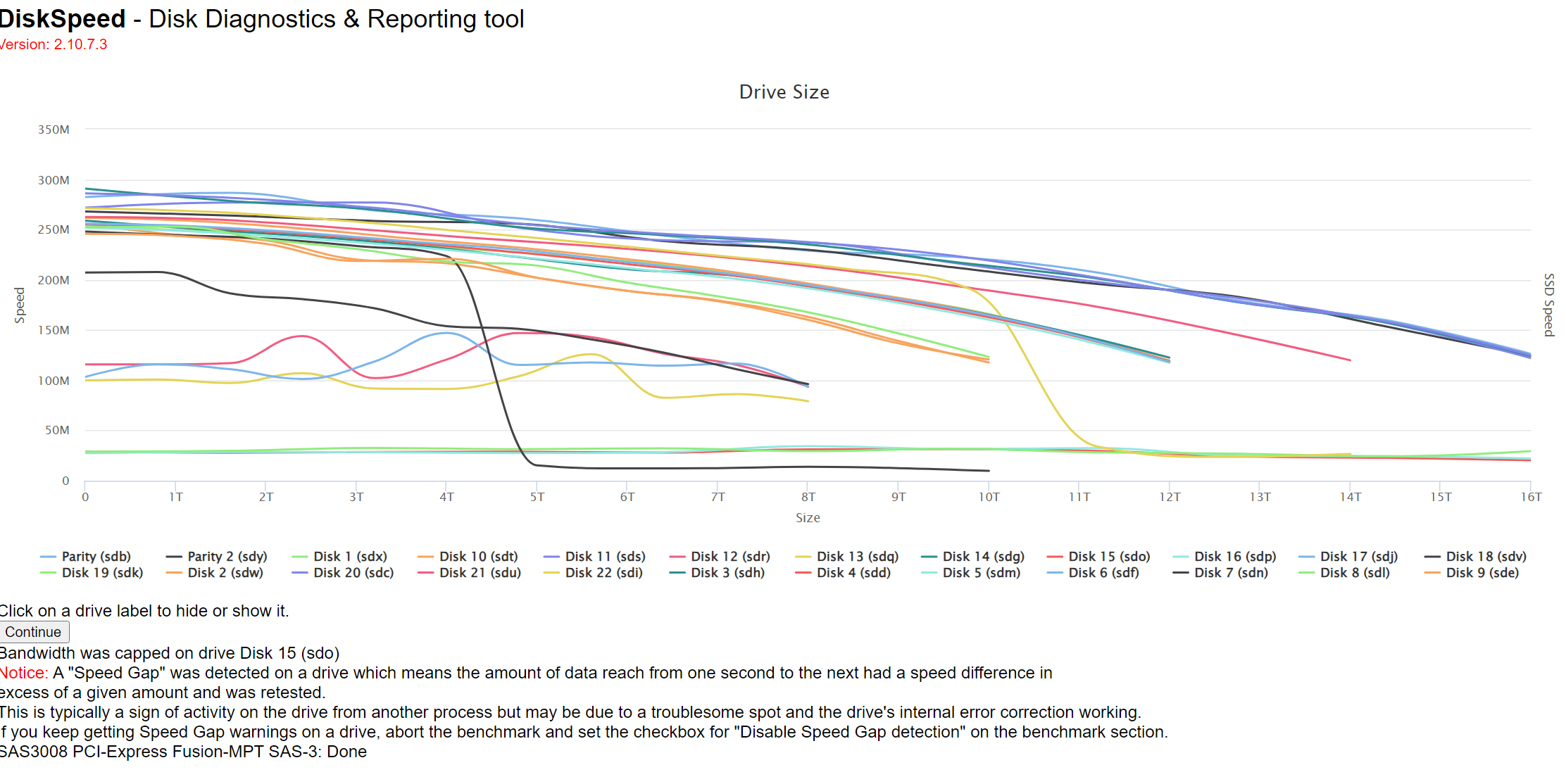

Having never studied/reviewed this type of output before, I have a few questions regarding the output as I'm not really sure how to interpret what I'm looking at nor any actions I need to take.
1) The sharp drop of the black and yellow lines is bad?   (start looking for replacements?)
2) The flat lines that remain below 50M the entire time.  Same as number 1?
3) When it looks like a piece of a sine wave like the pink line.  Is that the drive speeding up/slowing down and what is labeled a speed gap?
4) I'm confused with "Bandwidth was capped on Disk 15".   Disk 15 is one those 3 flat lines that remain straight across below 50 the entire time.
      a) Is that because it's flat it interprets it bandwidth being capped?
      b) It mimics 2 other drives with the same line, why would they not be listed?
      c) What would cause a drive going so slow to have anything capped?
5) The verbiage at the bottom "A speed Gap was detected on a drive which means the amount of data reach from one second to the next...."
     a) How to determine which drive?
     b) Is "reach" a typo in  "amount of data reach from"?  I'm thinking you meant "received", but if not, what does that mean?
6)  If you keep getting speed gap warnings, the solution is to disable speed gap detection, so why have the warning in the first place?
--This is my older server so drives on their last legs is not surprising
The blank line dropping fast between 4TB and 5TB or the yellow line between 10TB and 11TB? Yeah, I would say something's up with those drives, especially if they tested normally previously. Search for your drive on the companion website HDDB and see what others are getting with their scans.
Sometimes a drive will drop from SATA 3 to a lower speed. A full power-off tends to correct those but I've seen them come back later. Potentially a faulty cable. If they test the same by itself with no other drives also running benchmarks, it's likely the drive is in some sort of safe mode.
I'm not sure what causes the jumping line like that. See what others are getting in their drive to see if it's expected.
A "Speed Gap" is my term for when a drive is reading at a steady rate and then there's a big drop in the amount of data being read and then it goes back up to continue normally. Typically, this are the drives being accessed by some other process at the same time but it could also indicate that there is a spot that has remapped sectors.
A consecutive and non-decreasing rate of read speeds (within a small percentage) indicates the drive is capable of sending data faster than the data link can support. This can be easily seen on a older multi-drive controller loaded down with SSD's. If Drive 15 is also the one that looks like the sine wave, I don't have logic that clears the bandwidth indicator if it suddenly spikes higher than when the steady read occurred. There are likely other reasons for it, but I don't have such drives to add logic to detect them.
As to Point C, multiple devices going at the same time - but not likely to be the cause here. The Controller Benchmark does read all drives at the same time to search for controller capacity being maxed out. Could be something wonky with how the drive was designed. Could be a shucked drive that has platters/heads disabled. <shrug>
It's displayed during testing, but I can look into adding it to the overview.
b - should be "read", corrected for the next release.
To make sure you're aware of it if it happens, that one of the drives could be wonky or have unexpected behaviors.
