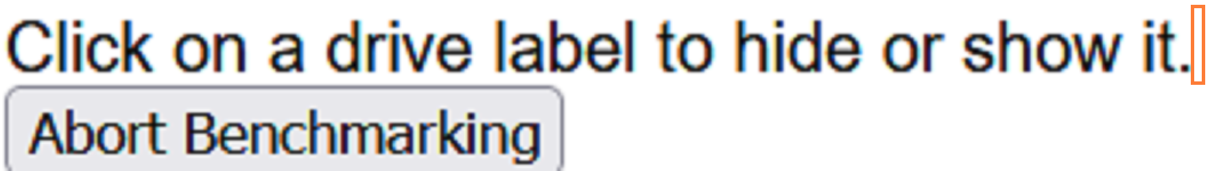

Click on the period (just to the right of it) at the end of "hide or show it" line when benchmarking to display the hidden iframes that are doing the actual work. If there was an error during the trim process, it will show up there. Copy-n-paste that error here (note you don't need the java stack trace if displayed)

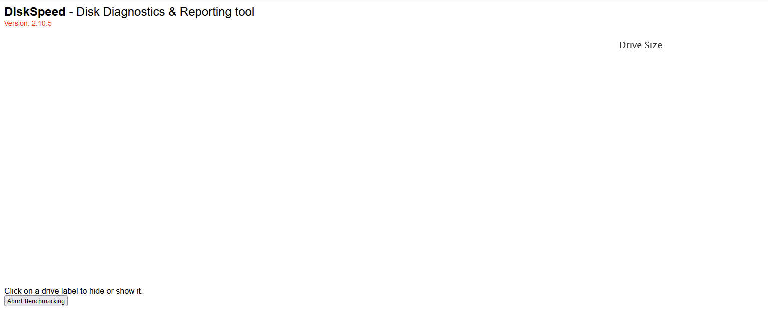

apologies for the delay... This is what I have got,... itàs been like this for more than half an hour...image.png.a2f11217145bed10c17d668d36c8ae86.png
It errored, probably your nvme drive doesn't support the trim function. If you click on that hidden link I mentioned, it would show the error message (same as in a recent previous post in this thread). I added a fix which will be on the next release. I'm working on adding more than 4 write threads but it seems to barf at 8 threads but works on others - trying to figure out why.
I wish I could but I have clicked all around without finding the link you mentioned
Hover just to the right of the period where marked here, the cursor will still have the text selection icon, if you see the arrow cursor, you're too far over.

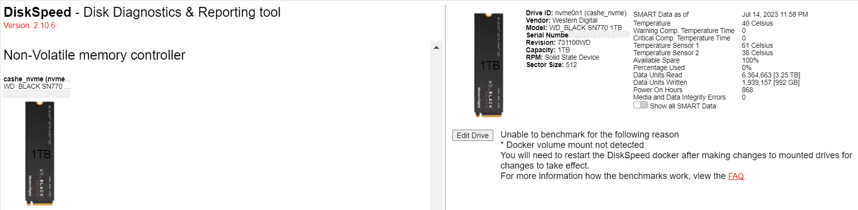

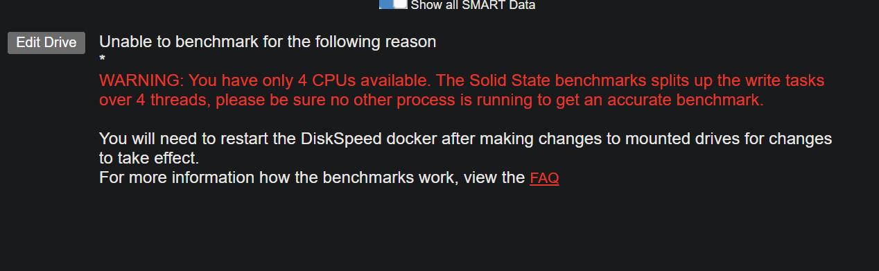

Assembled a new server and got 4 - 1TB NVMEs in a Asus Hyper M.2 card. All cards are mounted as individual cache pools. I added the path for SSDs but get this for the app-cache nvme. I can benchmark the other 3.
Identified mount point /mnt/UNRAID/app-cache does not have 5GB available space.
Also..the graph values and speeds don't make sense.
Edited by Fuggin

Is there anyway you could add an option to benchmark SSDs when the CPU core count is below 4?
All my unRAID systems run on old dual core CPUs. It would be nice to be able to benchmark the SSD I have in each one. That is used for a cache drive.

I've got NVME drives as a cache pool and I would like to benchmark them. I get the error:
* This drive is part of a multi-drive pool or array.
You will need to restart the DiskSpeed docker after making changes to mounted drives for changes to take effect.
However I can't find any info on what changes I need to make?

I'm also having the issue where the page appears blank during benchmark.
I've tried locating the iFrames just to the right of the period but there is nothing there. When you right click to inspect and go to the console tab I get this:
Uncaught TypeError: document.getElementById(...) is null
This is version 2.10.6.
Thank you!
Thank you!
I benched all my drives the other day and went to do one today and getting blank screen. This is the logfile from starting the container to trying to scan to stopping it.

@jbartlett i have 4 cores cpu (i5 4440) so i cant run benchmark on ssd ?
i was able to run in past , but now it show warning and no benchmark for ssd ...
Edited by Masterwishx

missing info on usage/disk format
Looks like the .12 upgrade is blocking access to NVMe drives.  I can benchmark any drive in the array, but none of the 3 NVMe drives I have in my cache & download pools.
Here is the error from the log file:
