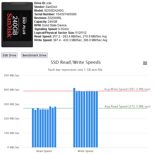

Decided to bench my SSD and NVMEs. Am i missing something or is the GB/s meant to read Gbps?
There's no way my 4tb samsung sata SSD can hit 4.4 GB/s, more like 440MB/s in the real world.
Also, what's with the X axis MB/s ? Shouldn't that read Gbps/s ??

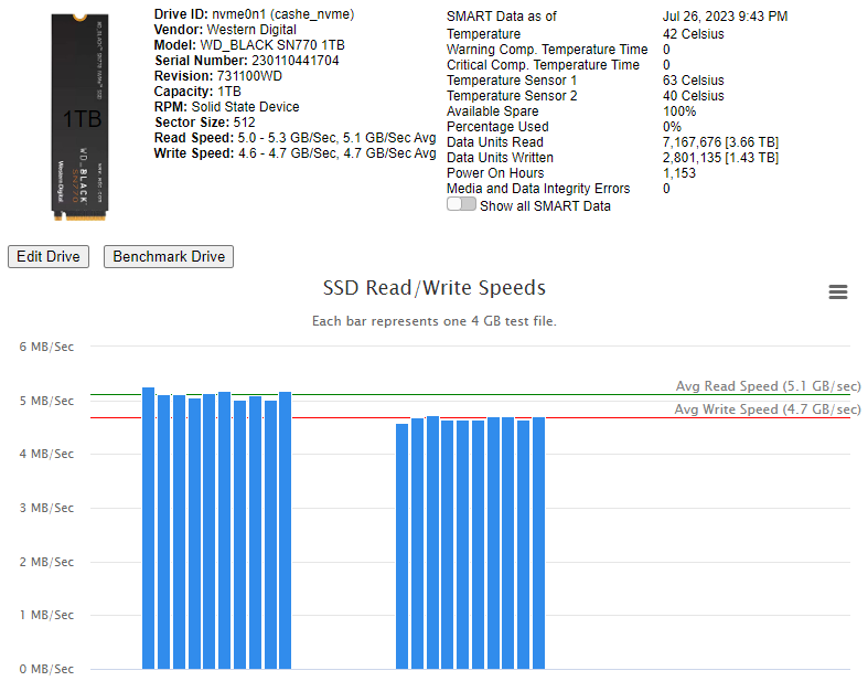

new build and just got word of DiskSpeed,,,  - great tool, so thanks a lot ;)
Good readings on HBA and mobo-attached SSD's, but the nvme on the gigabyte z690 gamingX is not giving me any diskspeed ;(
The drive is cashe-drive, xfs, used for docker/appdata
please advice next step - have seen other in this post getting good data from their nvme - so guess there is an obvious config I'm missing?
- or something I should check/post for further investigation?
It's odd that you're getting two different scales. If the report is still off like shown here, please submit a Debug file via the Debug link on the bottom of the main page.

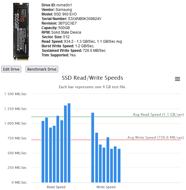

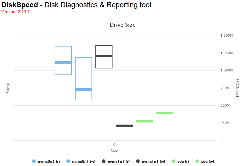

Benchmark tests show the read/write ranges of the SSD's along with the average. A tight bar can indicate a drive
that is consistent in its performance and does not utilize cache trickery.
I just noticed that the displayed read speed doesn't match the graphs, investigating. But the graphs are showing the correct values.
I'm working on adding a benchmark history for SSD's but I suspect this drive is going wonky on me.

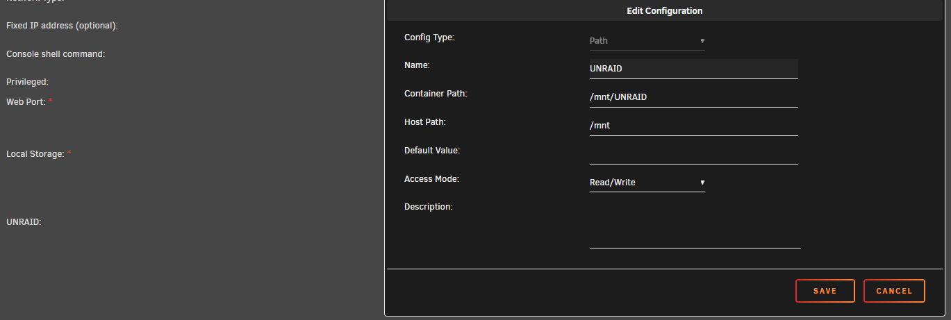

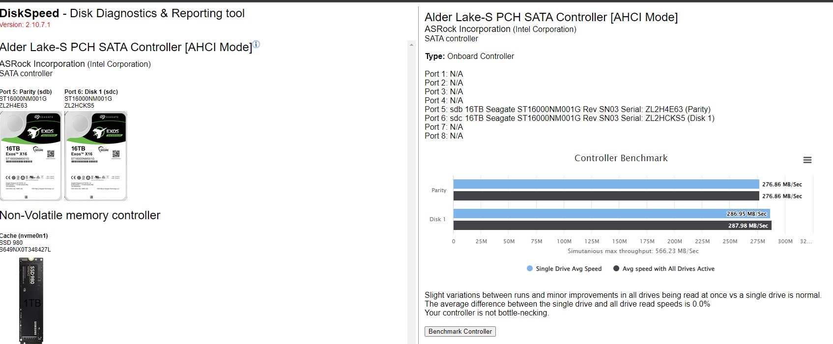

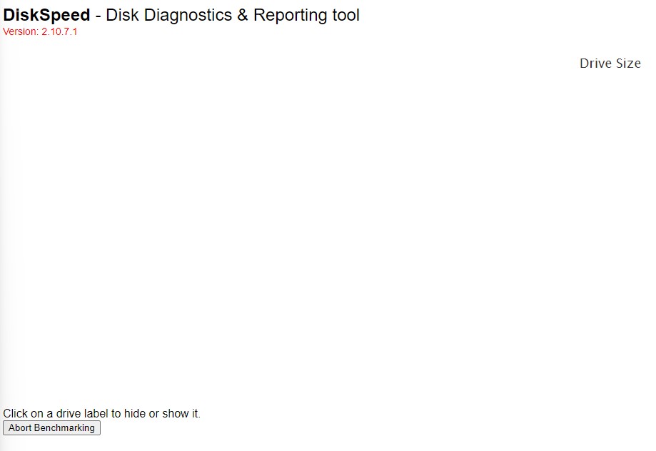

I am getting the same problem as others where I try and start the benchmark my drives and nothing happens. There also isn't and text displayed when I mouse over the end of the text "Click on a drive label to hide or show it."
I have been able to benchmark my SSD cache drive once I added the UNRAID paths so that part works.
If I benchmark the controller that does appear to be able to run some tests against the disks.
You have to click in the orange area above, just to the right of the period.
If you click the Abort button, does it tell you that it's aborting and then changes to a "Continue" button after a few seconds?
Nothing happens when I try and click the orange area I have tried multiple browsers etc nothing happens.
The abort button changes to aborting benchmark and then just hangs there.
Right-click anywhere in the browser window to bring up the Dev Tools. Using Firefox & Chrome, it's "Inspect".
Click on the "Console" tab and enter the command "ShowDebug()" and hit enter. That should make them visible.
I'm able to test my array drive fine but not the cache drives, tried a purge but same deal, I looked at the fact but didn't really get how to resolve how to test, I can't mount them through Unassigned Devices when they are assigned to the cache pool. Maybe you just can't test in this config?

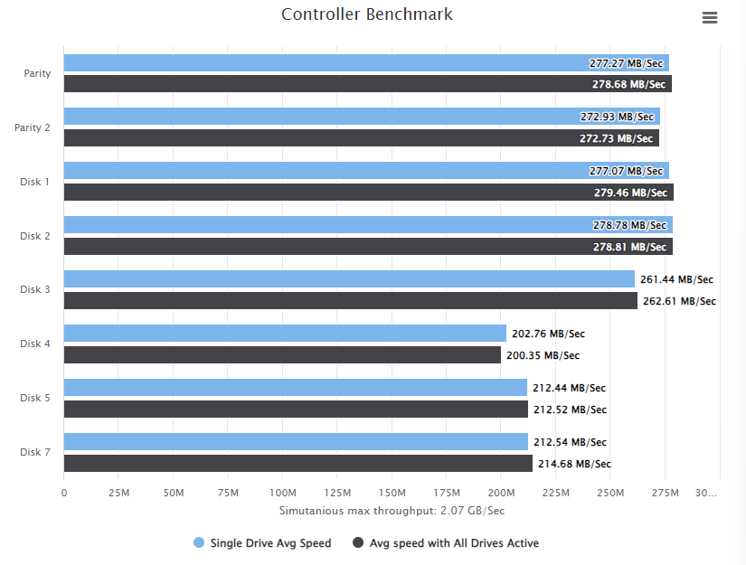

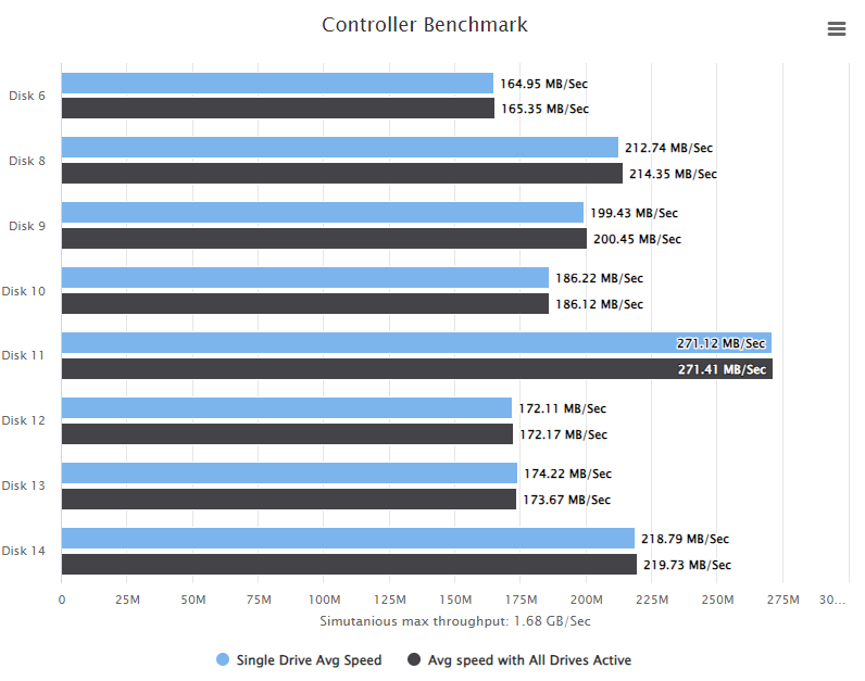

I am mainly strugglines with very long disk rebuild times. I just swapped a 4TB out for a 20TB and it rebuilt around 160 MB/s which took about two days. I have some drives that I know are slower than others but I want to make sure my controllers are setup and cooled properly so that they are not the bottleneck. Everything is pulgged into PCIE-x16 on board slots (one is the GPU slot and the other is an x4) with mini SAS to SATA cables.
Benchmarks for "ok" controller (the 20TB drives are parity, parity2, disk1 and dis2):
Benchmarks for the "downgraded" controller (the 20TB drive is Disk 11, slower than what we saw with the "ok" controller but not terrible. However overall the drives here are much slower):
Thanks!

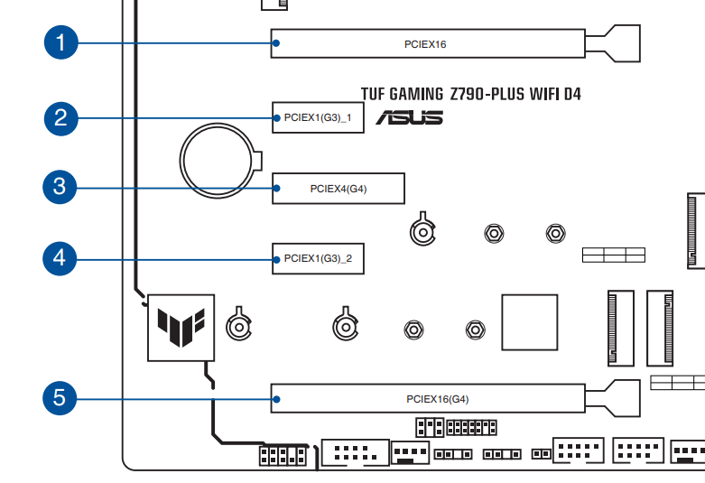

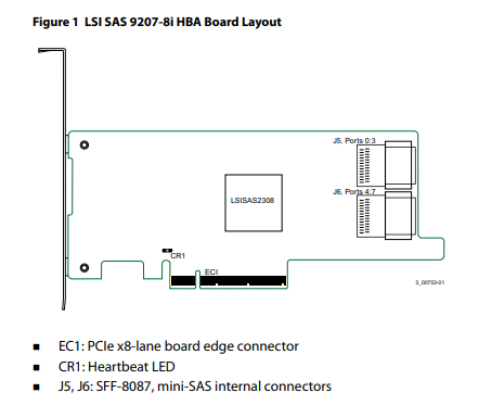

I bought these cards: https://www.amazon.com/dp/B0BVVDT4F1?psc=1&ref=ppx_yo2ov_dt_b_product_details
Looks like they are PCIE-x8, I was under the assumption they were x4.
I am using this motherboard: https://www.amazon.com/dp/B0BG7DY6MT?ref=ppx_yo2ov_dt_b_product_details&th=1
It's second x16 slot is running x4 lanes:

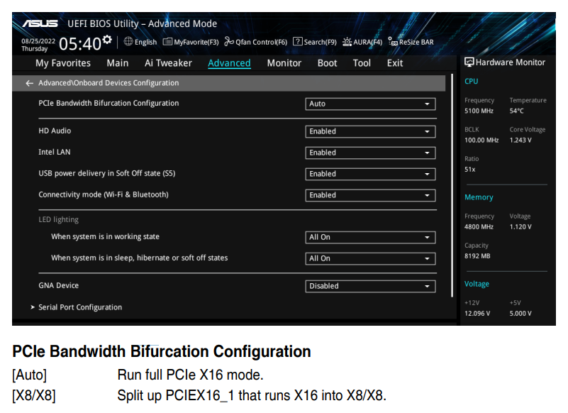

So maybe I am out of luck. Or maybe I can run bifurcate the x16 slot into x8 and x8 and get out of degrade mode?
I see this in the motherboard manual. Looks like it's intent is if you want to run PCIE M.2 controllers but this may be simular, think it's worth a shot?
