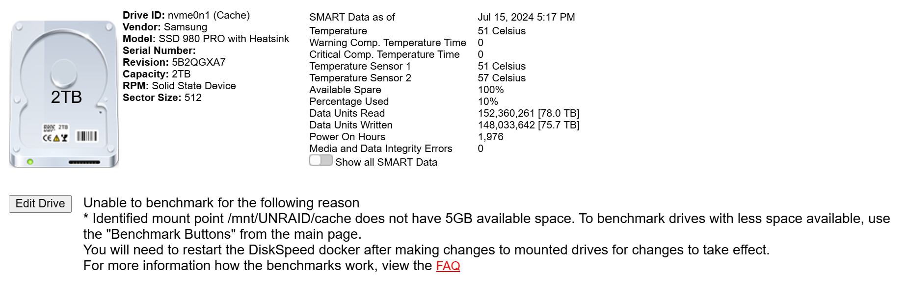

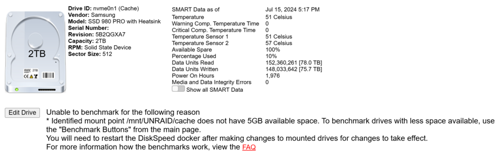

I have this error on the cache disk and I have space to spare:
Can you open a shell prompt inside the Docker container
and then enter: df -B 1KB | grep cache
Reply with a screen shot of the result

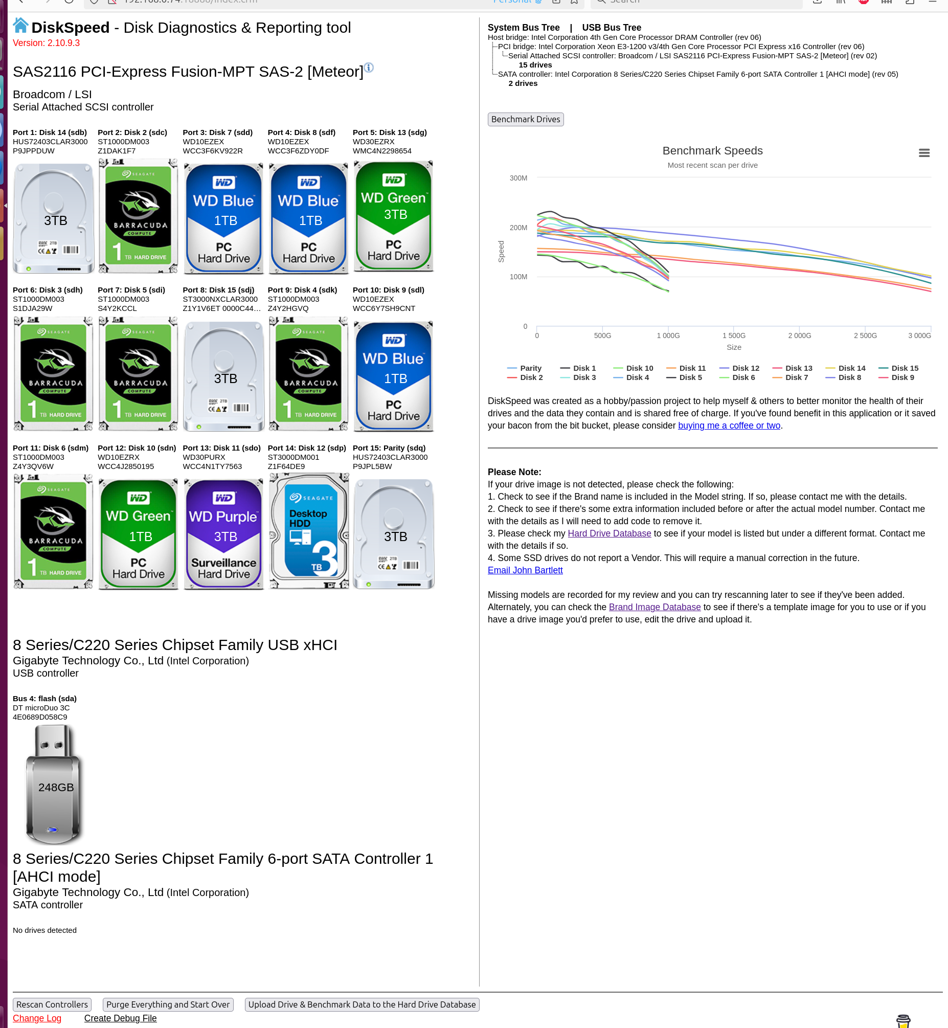

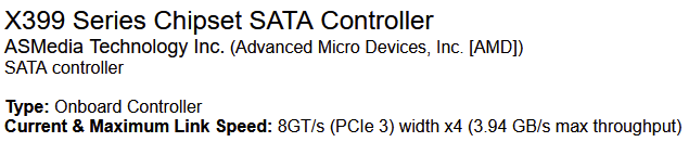

Just doing some testing and got a weird one where the controller on the motherboard lists not having any drives attached.
Disk 1 is plugged into the Motherboard and gets benchmarked but not listed
Also when trying to upload drive and benchmark data via the button at the bottom just get an error

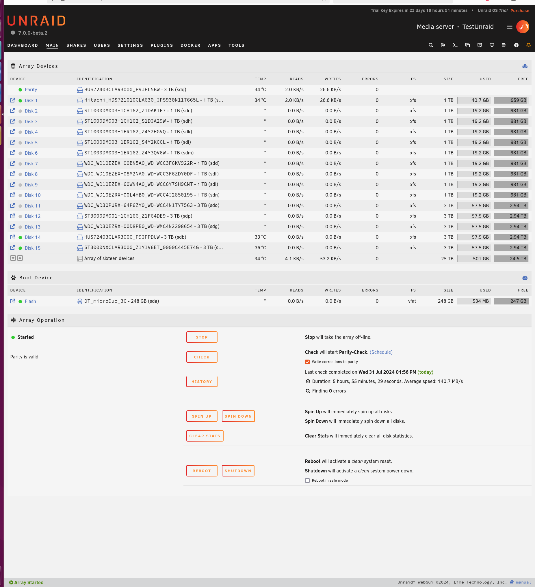

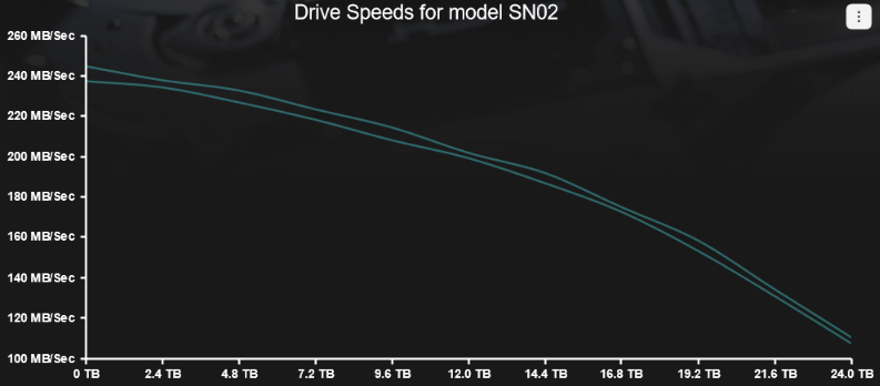

What could be the reason that the single drive speed is at about 115 MB/s but when it runs all drives at the same drive, each drives max out at about 250 MB/s?
It doesn't make any sense to me. I alreads reran the test and restarted the docker.
There is only one drive which does >200 MB/s at single drive speed.

24 drives reported a significantly slower single drive speed than all the drives reading at the same time. This is an abnormal test result. Please re-run this benchmark. If this result occurs again, restart the DiskSpeed docker app and try again.
What's wrong here?
Running unraid 7.0 beta2

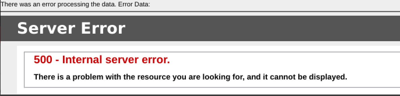

Container version: 2.10.9.3

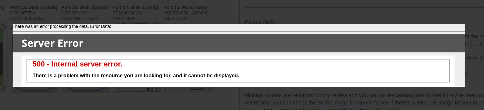

When I click on the "upload drive & benchmark data" I get a 500 error.

Are you still getting an error trying to upload the drive information?
The container log is unrelated.

Click on the DiskSpeed icon in your Docker apps and select "Console". Then enter the following command with replacing xxx with the drive ID and see if you get the expected speeds or the slower ones. Press CTRL-C to stop.
dd if=/dev/xxx of=/dev/null bs=1310720 skip=0 iflag=direct status=progress conv=noerror

Still getting the 500 internal server error here
Please try again. I believe it is resolved now. If you still get an error, please let me know what drive vendors you have (Seagate, Samsung, etc.)
Edited by jbartlett
The information has been successfully uploaded. Thank you for your contributions!

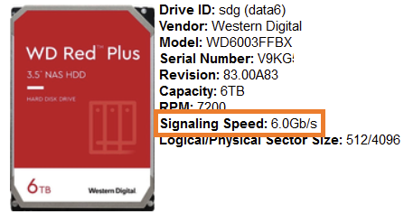

I don't know how I overlooked this app for so many years but its great! I used it to identify a few optimizations to my setup.
I did have a couple questions / comments though:
  1. I didn't see a way to test all controllers concurrently, or a way to test combinations of drives concurrently. Do you think this is feasible to implement? It would be very useful for triaging bottlenecks.
  2. I don't see the negotiated speed anywhere in the UI. I know all my disks are 6GB/s but some are negotiated at current speed of 3GB/s

I'm curious what other people get for this one since it appears to be a 24TB HAMR drive, got em from serverpartsdeals. Not impressed with speed, but I do like the density.
https://www.strangejourney.net/hddb/ModelDatabase.cfm?Vendor=Seagate&Model=ST24000NM000C

2. You can view the signal speed of a drive here
That data is as current as the last controller scan so if you suspect a drive has dropped to a lower signaling speed, rescan the controllers and then view the drive in question again.

And WOW on those speeds on the ST24000NM000C at the high end. Goes to show you that capacity isn't all that's cracked up to be.
@jbartlett - Thanks i updated but I see the same thing basically:
Current & Maximum Link Speed: 8GT/s (PCIe 3) width x8 (7.88 GB/s max throughput)
Current & Maximum Link Speed: 8GT/s (PCIe 3) width x4 (7.88 GB/s max throughput)

Yup, that looks to be a bug! The x4 should be displaying 3.94 GB/s.

Just updated the docker to Version: 2.10.9.6, and now I get this error when I open the Web Interface:
I did not change anything in the docker settings. Just updated. I can revert back to the previous version, but maybe you are unaware of this bug?
I added partial support for CD-ROM's in displaying them on the controller page but it required a lot of checks to be added throughout the app. This particular issue doesn't happen for me on my dev & prod system so not sure why it's happening for you but I added the CD-ROM check there. Please update and try again. It will reflect version 2.10.9.7

 Sorry, I probably wasn't clear. A picture is always better:
I can see its ordered by Parity, then data, then pools. But the data disks are sorted as strings instead of by disk number.
I think it should be Data 1, Data 2, Data 3, etc. instead of Data 1, Data 10, Data 11, etc.
