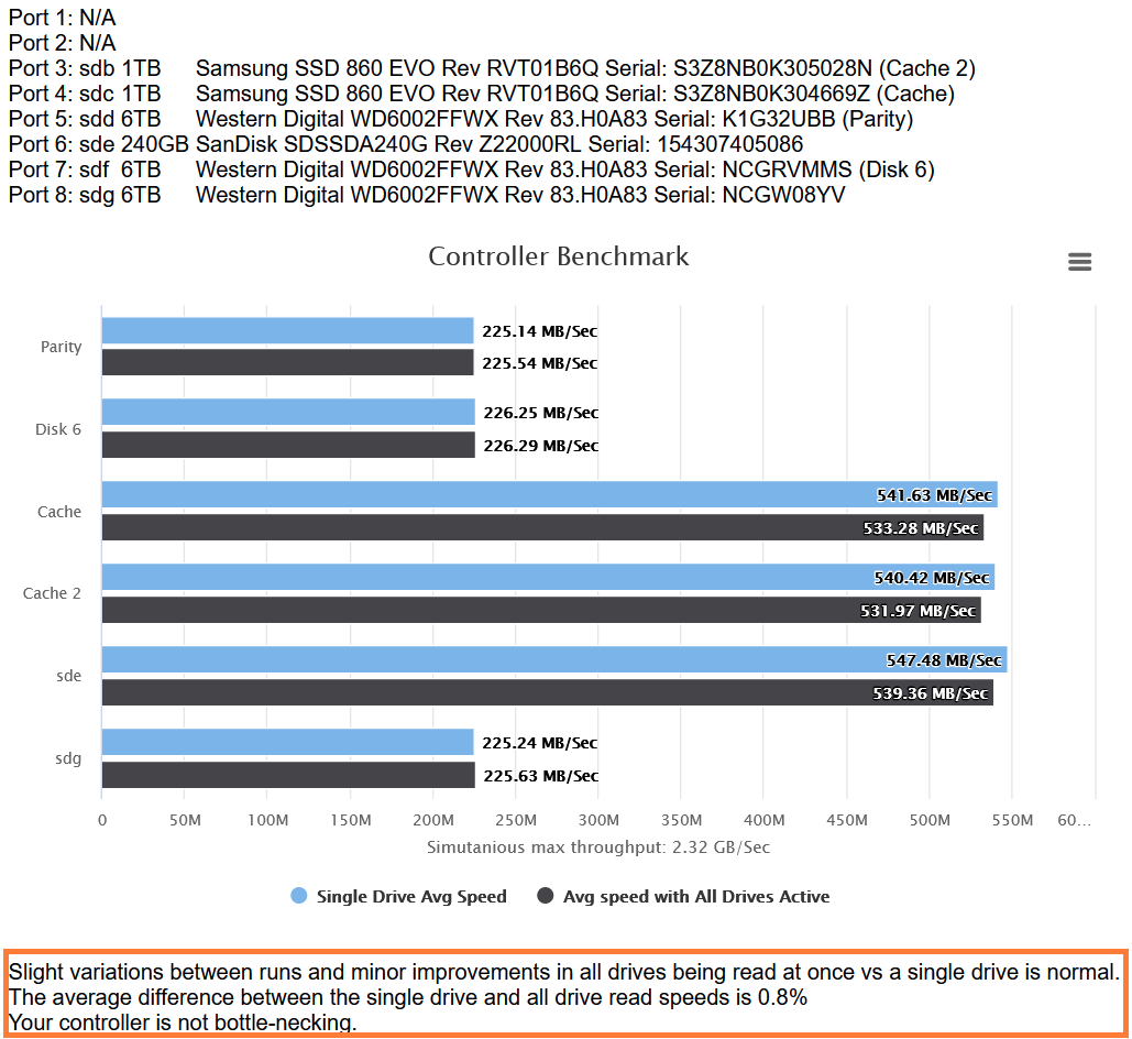

Have you tried a controller benchmark yet? It'll tell you if you are reaching capacity of what your controller can support.

It looks like the tools I use to gather the information changed their layout because I see that on my controller too. Will make it easier for me to fix.
Thanks for the tip! Looks like my controller is not the bottleneck! Just gotta replace some real slow drives...

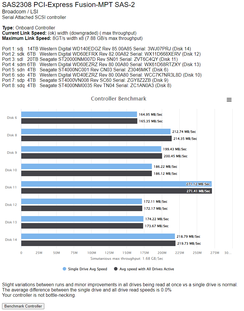

Hello all, is there a reason why I'm limited to 2 GB/s for this setup?
R730, controller is an LSI SAS9207-8e 8-Port External HBA
All drives are heavily used / refurbished HUH728080ALE604 contained in a DS4246 with an IOM6 controller connected via a QSFP SFF-8436 to SFF-8088 cable.
DiskSpeed reads the following.
Current Link Speed: (ok) width (ok) ( max throughput)
Maximum Link Speed: 8GT/s width x8 (7.88 GB/s max throughput)

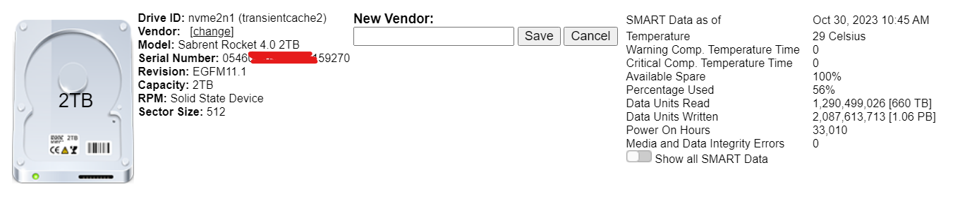

Don't know if you can do anything about it, but my Sabrent Rocket SSD's aren't parsing correctly.  I've attached a screenshot to show you what I mean.   Let me know if you need any additional info.
Thanks!
Thanks!
If you mean the Vendor, a lot of SSD's do not populate the Vendor field and I have to add logic to catch those to pull the vendor from the model, if possible. This is why I provide the option to change the vendor. If you enter "Sabrent" into the vendor field, save, and then rescan, it'll pull up the image if someone has already submitted on. Otherwise, you can edit the drive, edit the image, and provide one yourself.
If you're referring to the data units read/written, that's based off the sector size multiplied by the unit.
If none of the above are what you are referring to, then you'll have to be more specific.
It works perfectly fine and it wasn't bothering me.  My fault, I thought I read in one of the post you wanted to notified.
Thanks!
