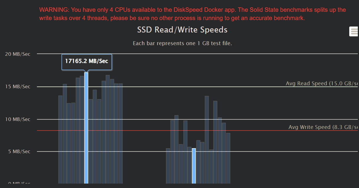

@jbartlett have strange benchmark result for Samsung 870 Evo 1TB :
should be about 500+ Mb/s
