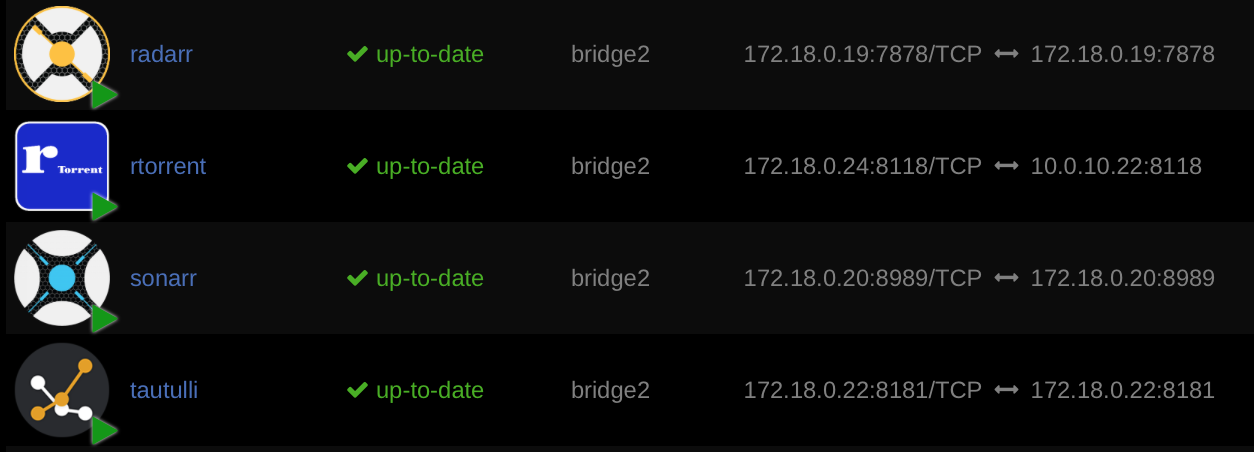

@bonienl was that fix for displaying the mapping on custom networks included? I linked the relevant convo below from the 6.5.0 release. I saw in these 6.5.1 notes it mentions the regression of Docker CE version, not sure if that affected the fix? In my case, still seeing the same incorrect output.
unRAID 6.5.1 has additional support for displaying custom bridge networks. Can you show a screenshot?
Sure thing. That's what I had thought from what you mentioned in that thread. Here is a screenshot, showing the same thing as last time - these are all showing ports that are not mapped locally, but are showing as such in the interface. Again, the actual ports are not open, so functionality is working correct and as expected. Let me know if you need any other details.
881094560_ScreenShot2018-05-01at8_27_44AM.thumb.png.e7afb67f9e66715051f74039051002dc.png
I expect to see the host address (10.0.10.22) for all these containers, like the line of 'rtorrent'. Strange the others show the internal address (172.18.0.xx)
Can you post the output of
docker network inspect bridge2
and
docker inspect tautulli
and
@bonienl - agreed, and it should also NOT be showing the mapped ports as like I said those ports are NOT actually mapped to the host. So it's 2 things not showing correctly. I sent you a PM with the details you asked for here so as not to clog it up.
