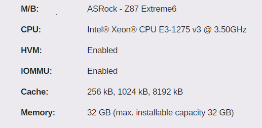

unRAID 6.5.2 ~ 50 seconds
unRAID 6.5.3-rc1 ~ 25 seconds
Cut boot time roughly in half for me on my Xeon E3-1241v3 cpu passing my GTX 970 though.

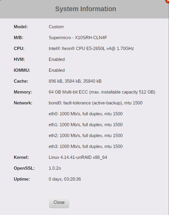

VM 1: Windows 10 VM with OVMF and Q35 2.11 for Living Room. CPU pair 2/6 (Host Passthrough) with 4GB RAM. Passthrough nVidia GT 730 and Formosa USB Remote Control device (QEMU XHCI USB 3 Controller).
Boot to Tianocore times:
unRAID 6.5.2          5 seconds
unRAID 6.5.3-rc1   4 seconds
VM 2: Windows 10 VM with OVMF and Q35 2.11 for Master Bedroom Room. CPU pair 3/7 (Host Passthrough) with 4GB RAM. Passthrough nVidia GT 710 and Phillips USB Remote Control device (QEMU XHCI USB 3 Controller).
unRAID 6.5.2          7 seconds
unRAID 6.5.3-rc1   6 seconds
VM 3: Windows 10 VM with OVMF and Q35 2.11 for Development. CPU pair 2/6 and 3/7 (Host Passthrough) with 8GB RAM. Passthrough nVidia GTX 750 ti and Logitech Mouse/Keyboard (QEMU XHCI USB 3 Controller).
unRAID 6.5.2         12 seconds
Hardware in my signature is up to date. I'll do a parity check tonight and post my results compared to previous unRAID version.
