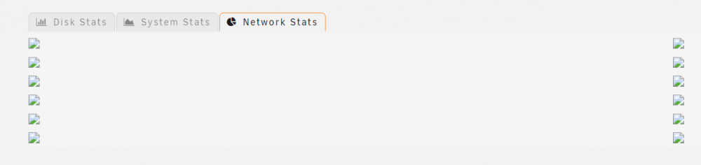

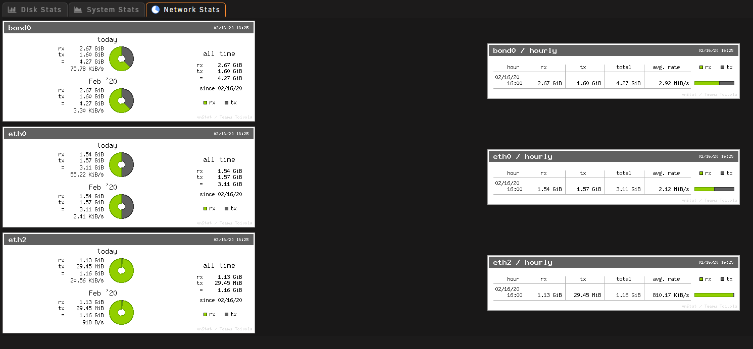

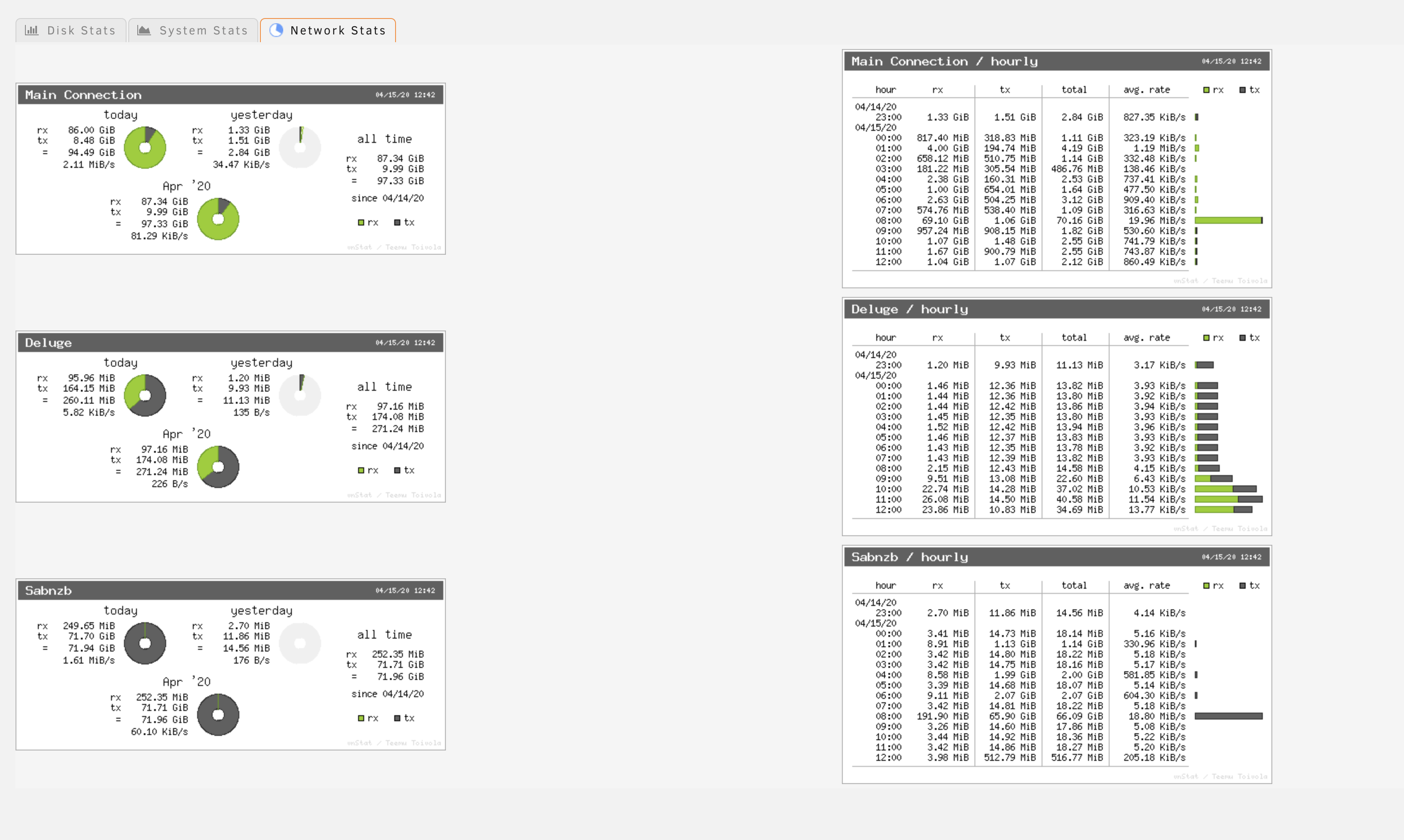

I am seeing this:
Looks like there should be images on the left but I am not seeing them and nothing is coming up in the graph.  I dont know what the graph should look like so thats why I am posting this here.  On the plus side, it does appear to install without error.  :D
______________________________
Looks like I just needed to wait about 5 minutes for it to poll the data and add it.  Works fine!  Thank you!

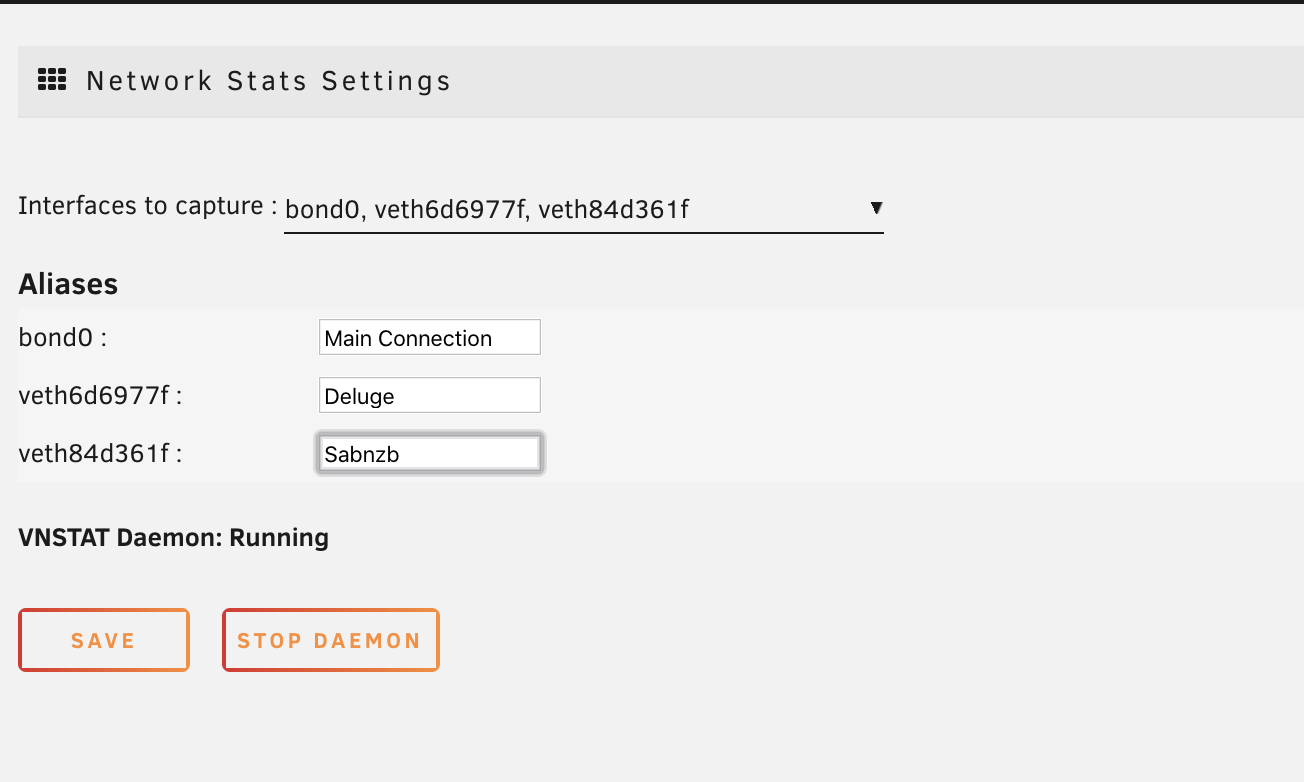

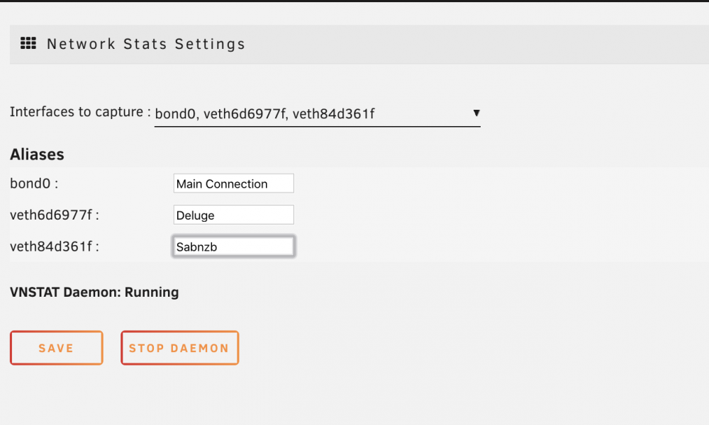

I have added the ability to add pretty much any interface to be tracked.  I have also added the ability to add an alias to an interface that is used on the graphs.  I have found some information on how identify which veth interface maps to a given docker container, but it does not seem consistent, if someone knows an easy way, then maybe I can add this to the interface.

I have added the ability to add pretty much any interface to be tracked.  I have also added the ability to add an alias to an interface that is used on the graphs.  I have found some information on how identify which veth interface maps to a given docker container, but it does not seem consistent, if someone knows an easy way, then maybe I can add this to the interface.imageproxy.php?img=&key=e5eec7c5c933ca16a412eab237de08e8def36275b4556b62c7e9c01c21a98843
That looks amazing, I wish I could help. But I don't know much. I'll see the update soon and start using it

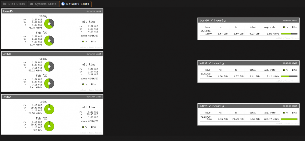

Thanks for a great plugin. I have a question though. Would it be possible to add an image for daily/monthly usage as well?
Like this one for daily:
And this for monthly:
