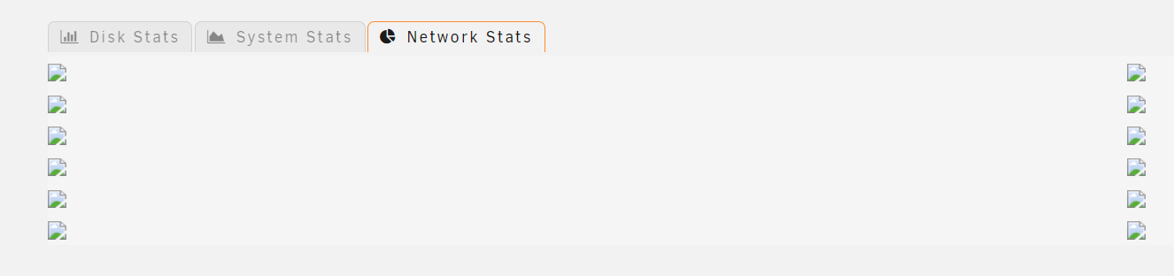

Hey Guys,
installed the dependencies.
but didnt changes the view.
On 3/11/2022 at 7:36 PM, dorgan said:
https://slackware.uk/slackware/slackware64-14.2/slackware64/x/libXau-1.0.8-x86_64-2.txz
is there any thing else to do ?

When I run my net stats, the graphics do not follow. Any help?

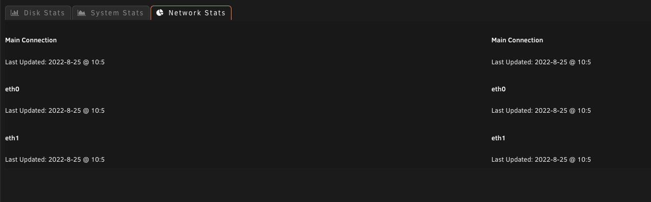

OK everyone motivated me to get off my behind and really update this plugin.  Update coming this week. It's a work in progress, but I have figured out a can get a json response from the cli tool and will use that to display some out put.  This initial release will just be text, but I'll look into putting back in much better looking graphs and such in a future release.
@Squid the dependency problem exists only when I was trying to use the vnstati commend, which is what was actually generating the images.  While that will still get installed with the vnstat package I am no longer going to rely on it/use it, thus removing the requirement to install other packages.
Edited by dorgan
typo

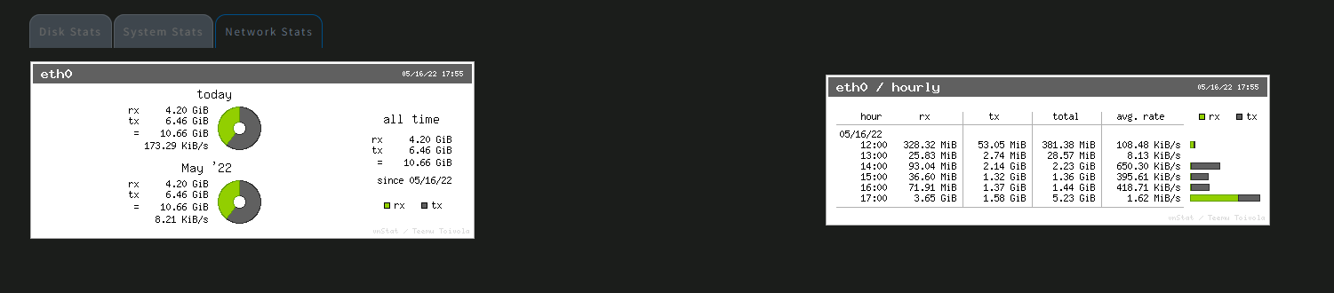

new release is out there, its rough, but it brings this plugin back to life from having additional steps to get it working.  Any and all feedback is appreciated and will be considered.

I'm not seeing the graphs populating on 6.11.0-rc4 when installing this, but IIRC my system was always having issues with this plugin for some reason.  I'll leave it in CA and continue to monitor the situation with it.
