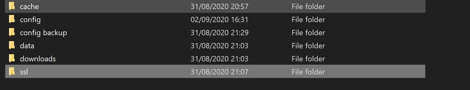

Create a necessary folder in
\\yourservername\appdata\binhex-qbittorrentvpn\qBittorrent
Create a folder called ssl

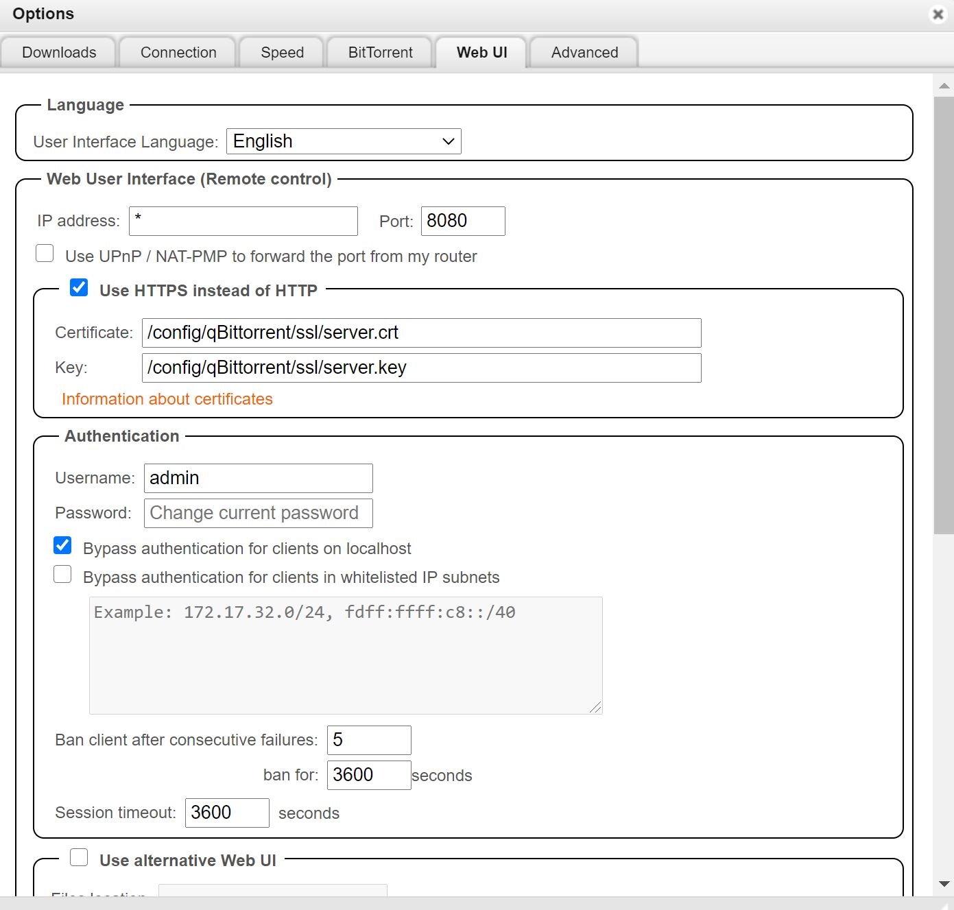

Now go to your qbittorrent web-interface then open the Tools -> Options... in the menu bar (or click the screwdriver or cogwheel icon depending on your version), and click on the tab labelled WebUI. Enable HTTPS and add the location of the files.
Add to the boxes,
/config/qBittorrent/ssl/server.crt
/config/qBittorrent/ssl/server.key

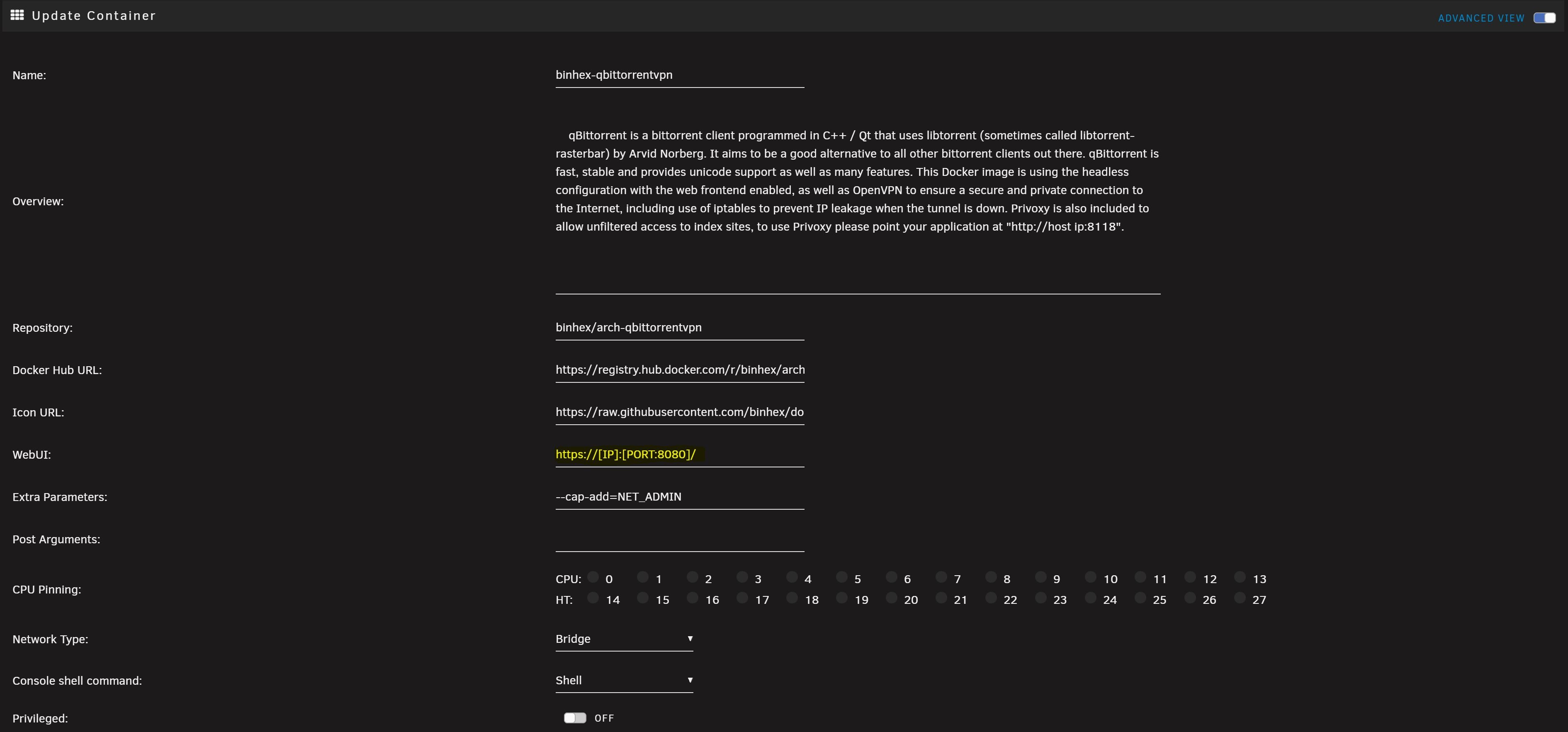

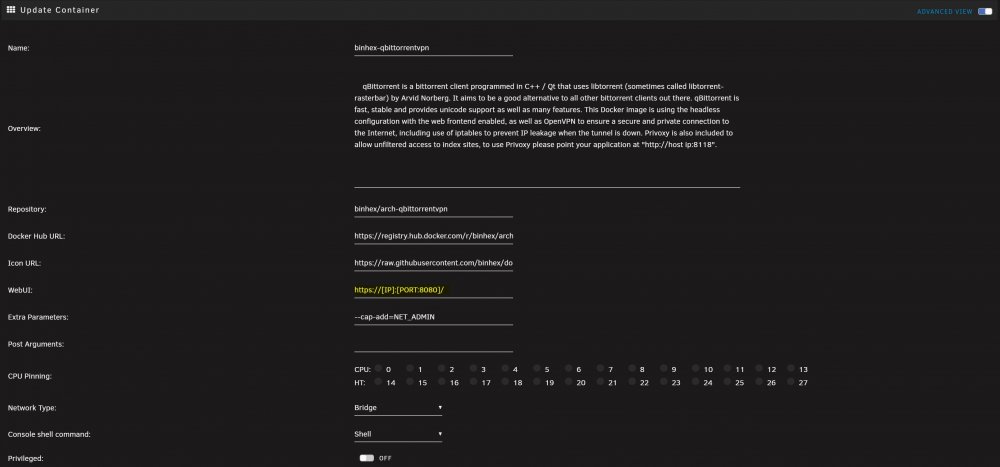

Close the page and edit the qbittorrent container in advance mode and on the line WebU:
Change http://[IP]:[PORT:8080] / to https://[IP]:[PORT:8080]/

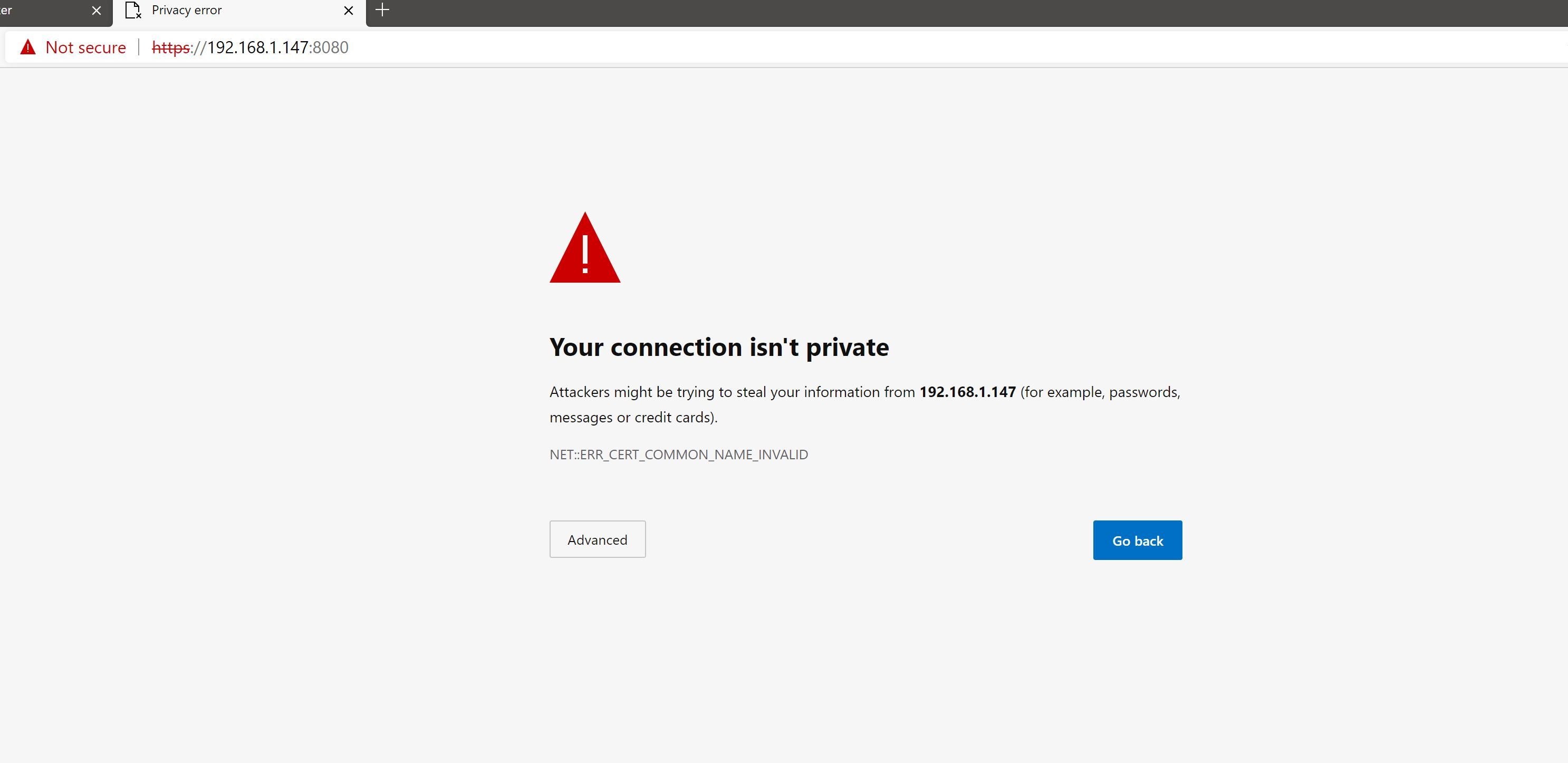

when you go to the docker webui you will now see this page.
Select advanced and proceed to the docker login page, you will notice it still says not secure ( https:// ) don't worry thats because of the self signed certificate.
Because its self signed its not been verified by a third party, so will show not secure ( to my knowledge )
