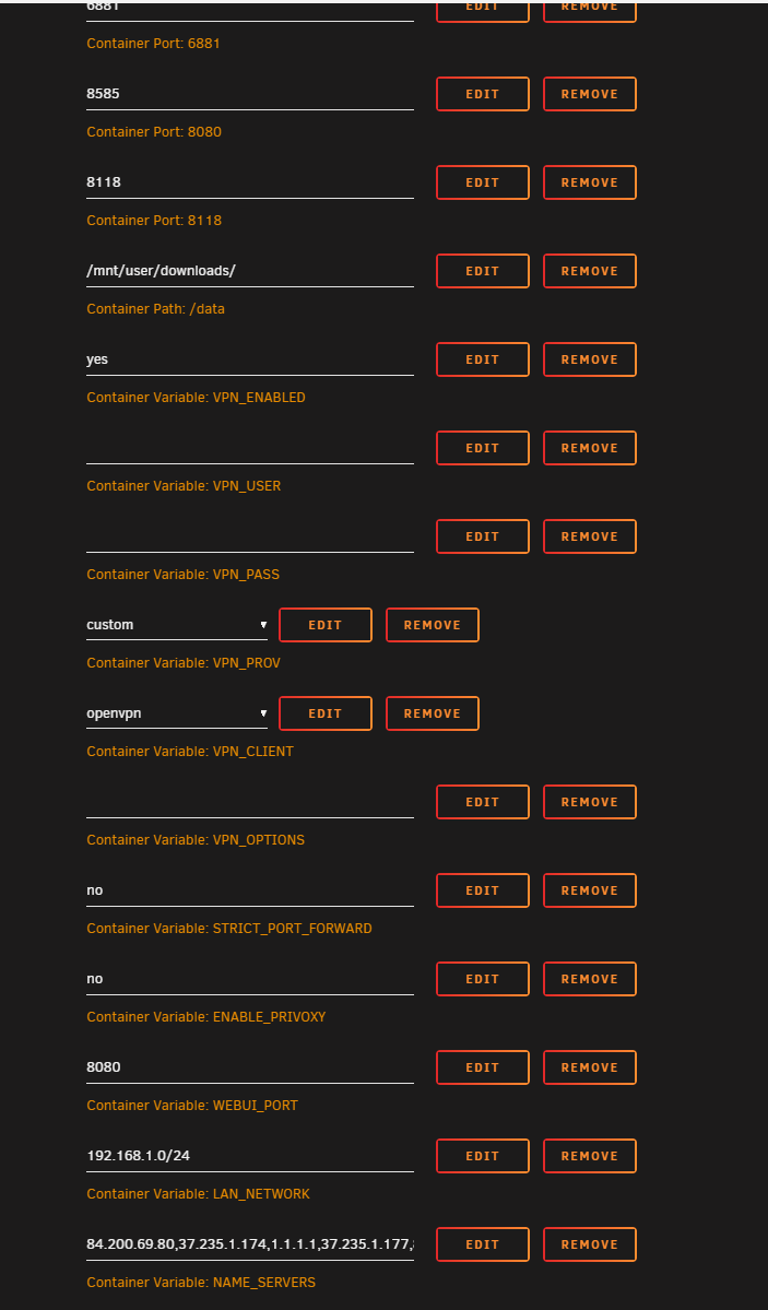

Still pretty new to Unraid, tried to install and run this docker but it won't start. Here's what I did:
  • changed ports for webUI to 8585 because 8080 is crowded.
  • Set VPN_PROV to Custom since I'm not using PIA
  • Entered my USER ID and PASSWORD for the VPN in the correct fields (Container Variable: VPN_USER and Container Variable: VPN_PASS)
  • Changed value for Container Path: /data to the Share I'm using to store my downloads
Left all the rest to initial settings, Installed the docker, install went OK
Then I try to click it and run START but it won't run. I know I need to add my VPN's OpenVPN files lateron but normally the docker should already be able to run, no?
Any idea what could cause this? Sorry for being such a noob
No
Quote from the GitHub readme-
OpenVPN
Please note this Docker image does not include the required OpenVPN configuration file and certificates. These will typically be downloaded from your VPN providers website (look for OpenVPN configuration files), and generally are zipped.
PIA users - The URL to download the OpenVPN configuration files and certs is:-
https://www.privateinternetaccess.com/openvpn/openvpn.zip
Once you have downloaded the zip (normally a zip as they contain multiple ovpn files) then extract it to /config/openvpn/ folder (if that folder doesn't exist then start and stop the docker container to force the creation of the folder).
If there are multiple ovpn files then please delete the ones you don't want to use (normally filename follows location of the endpoint) leaving just a single ovpn file and the certificates referenced in the ovpn file (certificates will normally have a crt and/or pem extension).
