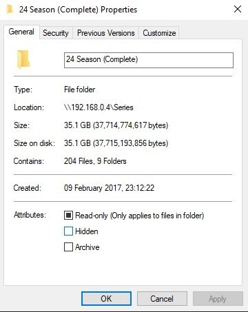

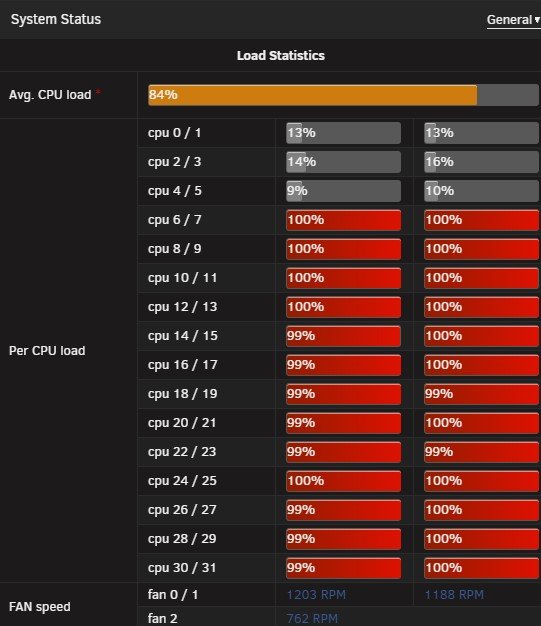

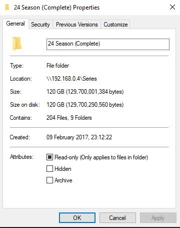

First of all I found this by looking at setting up Spaceinvaders Handbrake/Sonarr/Radarr Video but luckily I found this as with a 50+ TB library Handbraking current items will take a long time and be one hell of a tedious manual process so thank you Josh.5 for making this.
Just finished my first folder as you can see from the attachments(24 series) the before and after results are amazing with video quality perfect.
I do however have some comments/Recommendation about what this app has done for me not sure if anyone else has also mentioned this before so sorry if I am repeating stuff.

  • Some way to warn or tell people to allocate cores as it will just spank everything to 100%
