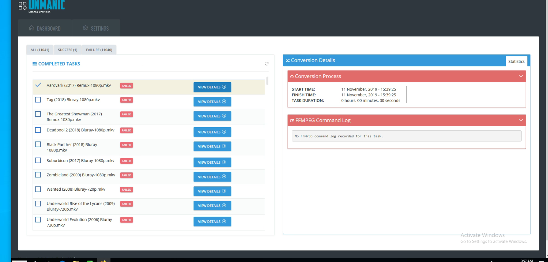

I am seeing this error in the in some video it tried to encode
No FFMPEG command log recorded for this task.
It failed at encoding so i'm not sure if its skipped or just failed?
What does the attached error mean? is not working or its already encoded and its skipping it.

What does the following error mean and how can I correct it:
I've currently attempted to transcode 1173 files.  Of that, 957 completed without issue.  But 216 of them failed with that message.  And when they do fail, it fails almost immediately, as soon as a worker starts to scan/transcode that file.
What causes this?  I see others saying they've having the issue, but doesn't seem that anyone has any answers.  Hoping now that a couple of weeks has went by, maybe we now know?

FFMPEG logs are not saved unless debugging is enabled. They add an unnecessary weight to the database for everyday use. It is possible that in the future when history is able to be cleared etc, the FFMPEG logging will be on all the time. But for now as there is no simple way to reduce the history log, this is a debugging only feature.
If you are seeing issues with files failing to convert, I'd recommend that the first course of action is to enable debugging. This will then show you the FFMPEG logs and also other key logs from Unmanic and will greatly help with determining the cause of the failure.
I'd be willing to bet you have an issue with subtitles as that is the common problem most people have with Unmanic at this stage. Flick on debugging and take a look...

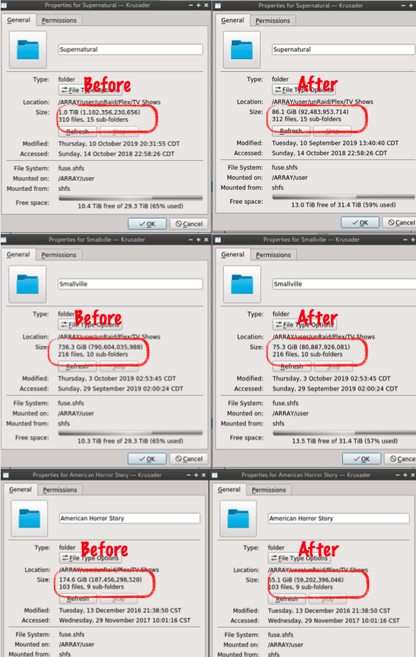

I cannot thank you enough. This docker is so much cheaper than hard drives. I posted my Before and After of a few TV Show directories. This is insane. I was nervous that I was seeing things, but I checked and the quality and audio is still all there. Unbelievable. I already had HEVC of some episodes so some directories were't as much improvement. But some were tremendous.
