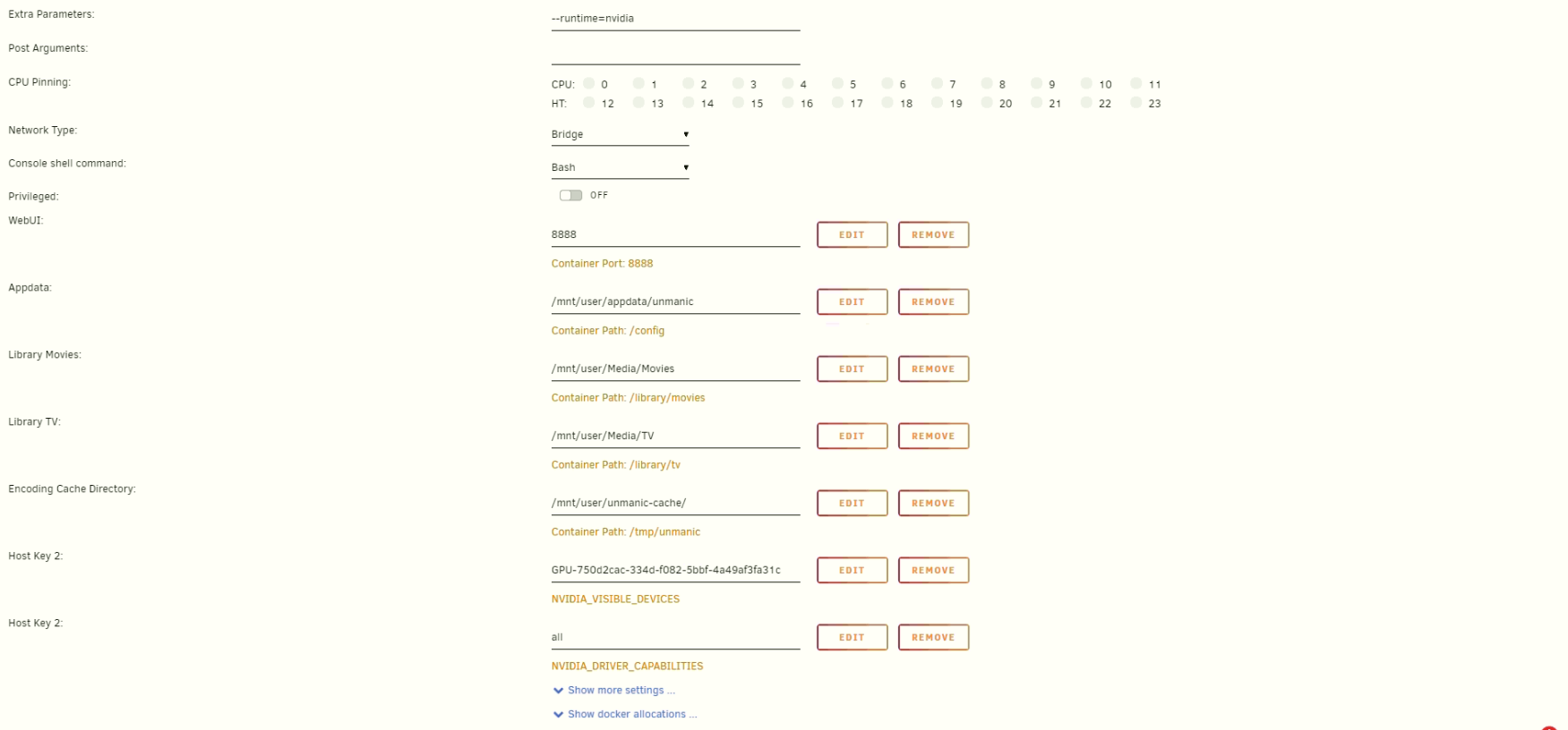

Hello all i am trying to install Unmanic and i am running into the following error when i click apply.
"usr/bin/docker: Error response from daemon: OCI runtime create failed: container_linux.go:349: starting container process caused "process_linux.go:449: container init caused "process_linux.go:432: running prestart hook 1 caused \"error running hook: exit status 1, stdout: , stderr: nvidia-container-cli: device error: unknown device id: false\\n\""": unknown. "
I am running Nvidia-unRAID version 6.9.0 beta_22 and i have an older Nvidia GeForce GTX980TI i am declaring the extra parameters and the NVIDIA_VISIBLE_DEVICES with the one Gpu UUID that i have but i get that error still. I use that gpu with handbrake and plex and even once with tdarr with no errors or problems everything works fine for those containers.
what am i doing wrong ?? is my video card even capable of doing a decent job of converting or helping to h265 so i can save some space or not really, the cpu will be the one to do the work.
thank you
Edited by richland007
