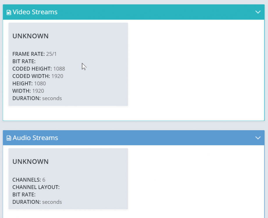

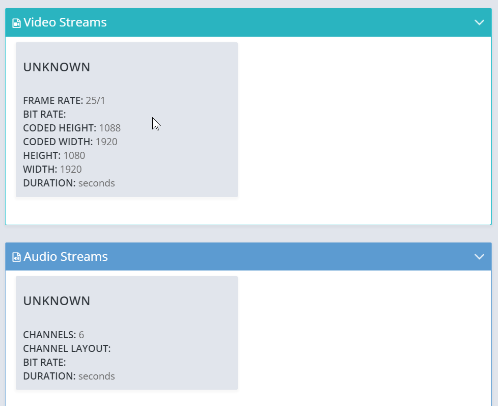

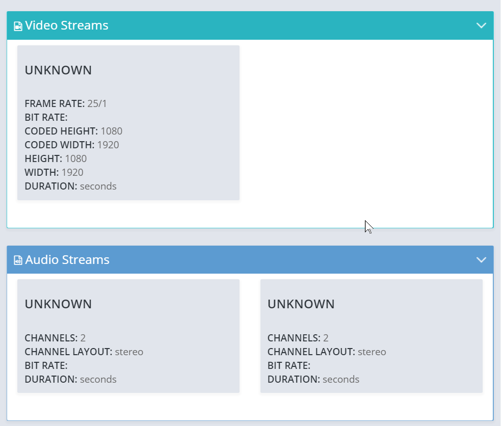

How do I keep the keep the 6 audio channel?
Before is 6 channel and after is only 2 channel. I also want to clone 2 channel for my non home theater streaming,
Settings - disable audio encoding
That will keep whatever audio is on the file intact.

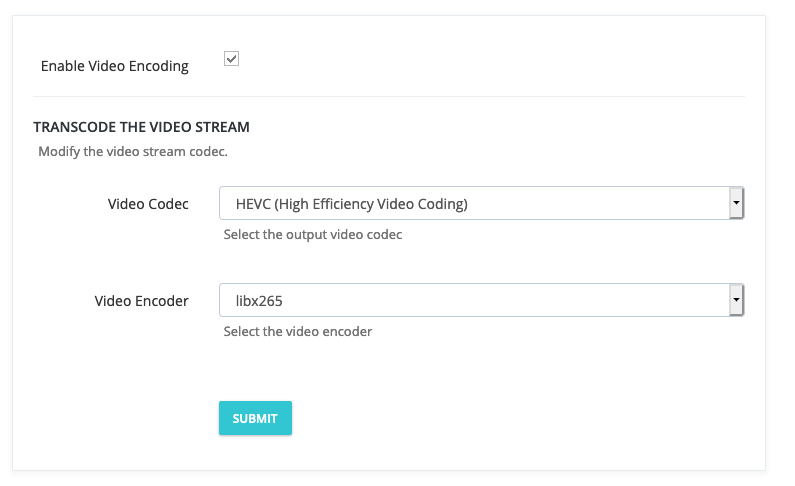

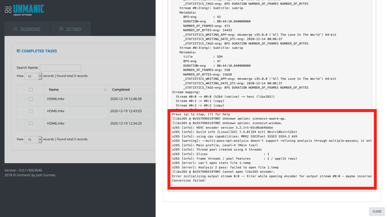

Hello, i juste installed Unmanic, and i like it.
I try to configure the conversion with :
1745288117_Capturedecran2020-12-19a12_52_26.thumb.png.9742550c1c1098e9c429ff329eb6657d.png
But when a conversion start, i have this :
1960154177_Capturedecran2020-12-19a12_52_57.thumb.png.a17b335d036e9c6fe1295279585204da.png
My UNRAID settings seems to be weel config :
1906615832_Capturedecran2020-12-19a12_56_50.thumb.png.7dcd7b88d60982540779425a21e12811.png
Did you have an idea ?
Thanks !!

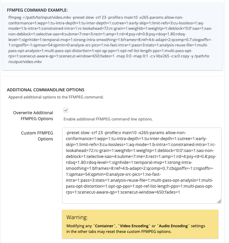

I added this line to go file on unraid using CONFIG FILE EDITOR from CA.
# enable iGPU for docker use
/sbin/modprobe i915
chmod -R 0777 /dev/dri
Which you may not have to do anymore but i couldn't get it to work without adding it.
then i added these line's to ADDITIONAL COMMANDLINE OPTIONS / Custom FFMPEG Options in Unmanic. ( I would suggest reading through http://ffmpeg.org/ffmpeg.html#Options )
-vaapi_device /dev/dri/renderD128
-vf format=nv12|vaapi,hwupload
Then i use hevc_vaapi setting for Video Encoder under the video encoding tab in Unmanic  which lets me make use of the quick sync.
I would also download intel-gpu-top & intel-gpu-tools from CA.
Hope that help cheers Tinni.
