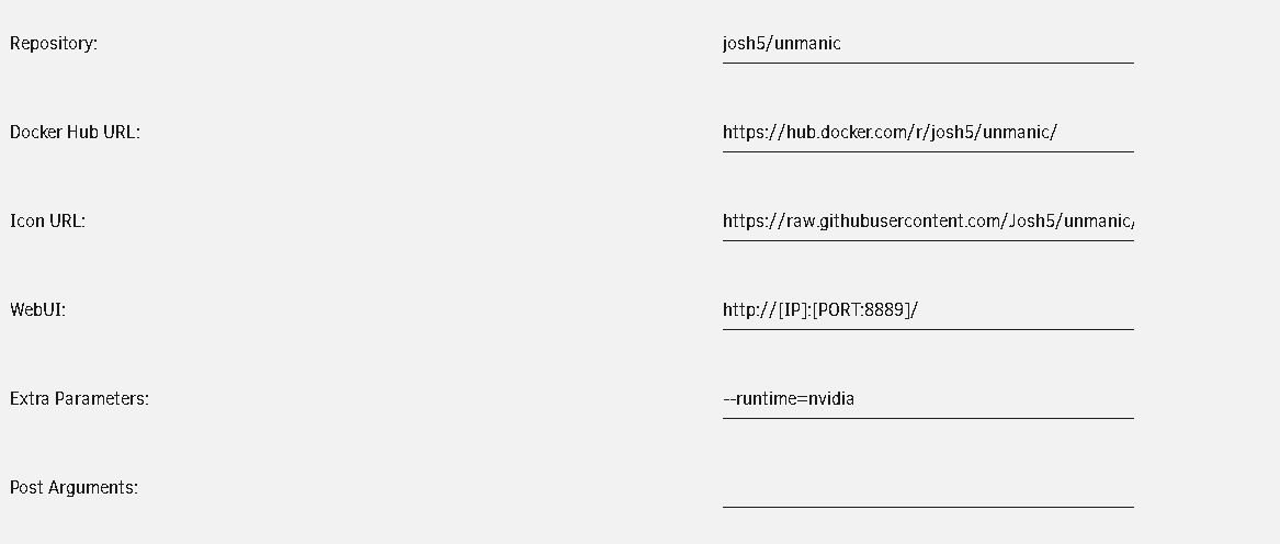

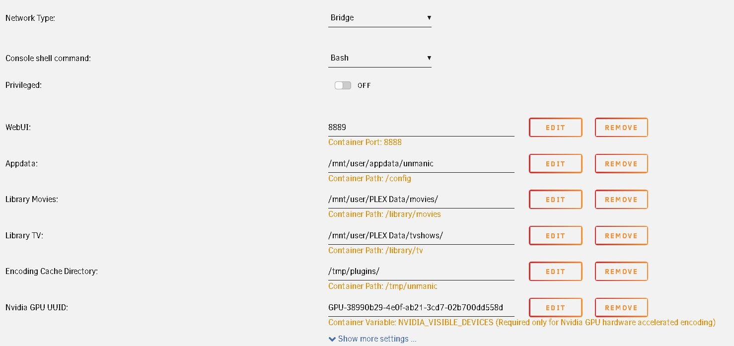

gpu not working for me   I set it with extra parameter - --runtime=nvidia
and  added the Gpu UUID
Gpu is a Nvidia Quadro p2000 and does work fine transcoding plex streams, this is not using it.
Have you installed the nvidia kernel version on unraid?
yes,,   gpu transcoding  works fine in plex
running the nvidia version of 6.8.3.

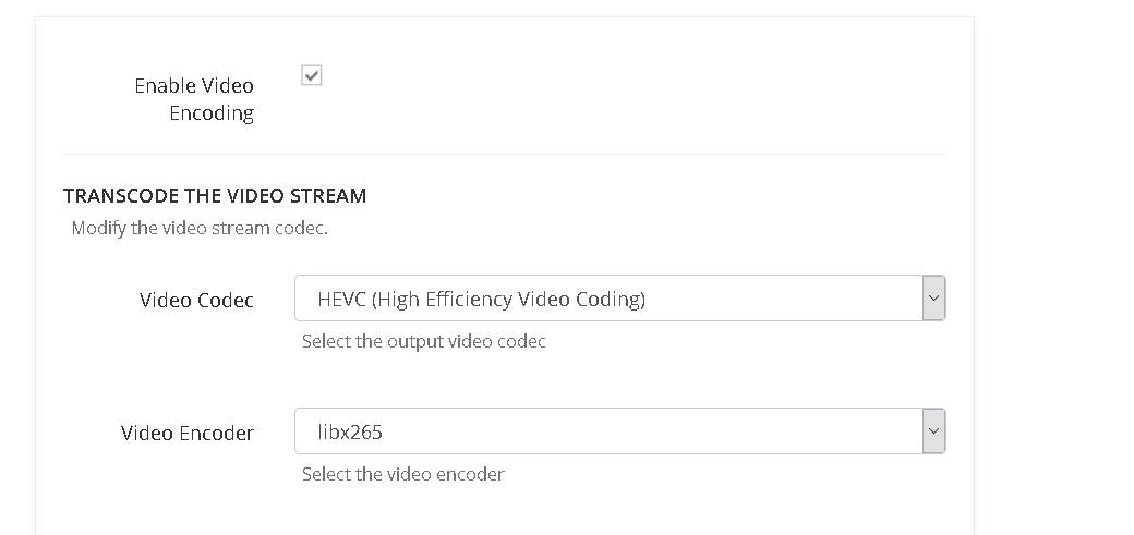

Did you change the encoder under settings, Video encoding to use one of the two nvenv options?
On 6/29/2020 at 11:00 AM, NoodleMaps said:
This is a wonderful project and I have been using it to convert all my files for the last few months. A few weeks ago, the converted files will no longer move and replace the original files. I have redone permissions. I cleared out the database file. I emptied the cache/conversion folder. I delete that folder and created a new folder. Tried pointing the Library only to certain folders. Adjusted settings in within the docker. I'm lost. It worked so well for so long and I don't know what happened. What do I need to provide for any assistance?
If anyone else was having the same problem, turns out one of my drives was placed in Read-Only mode because of an error. Once fixed the program returned to normal operation. Thanks again for a great program.
14 hours ago, RichRMG said:
Yeah, Libx265 is the Cpu encoder. Change that to one of the two nvidia ones. I use nvenc_hevc

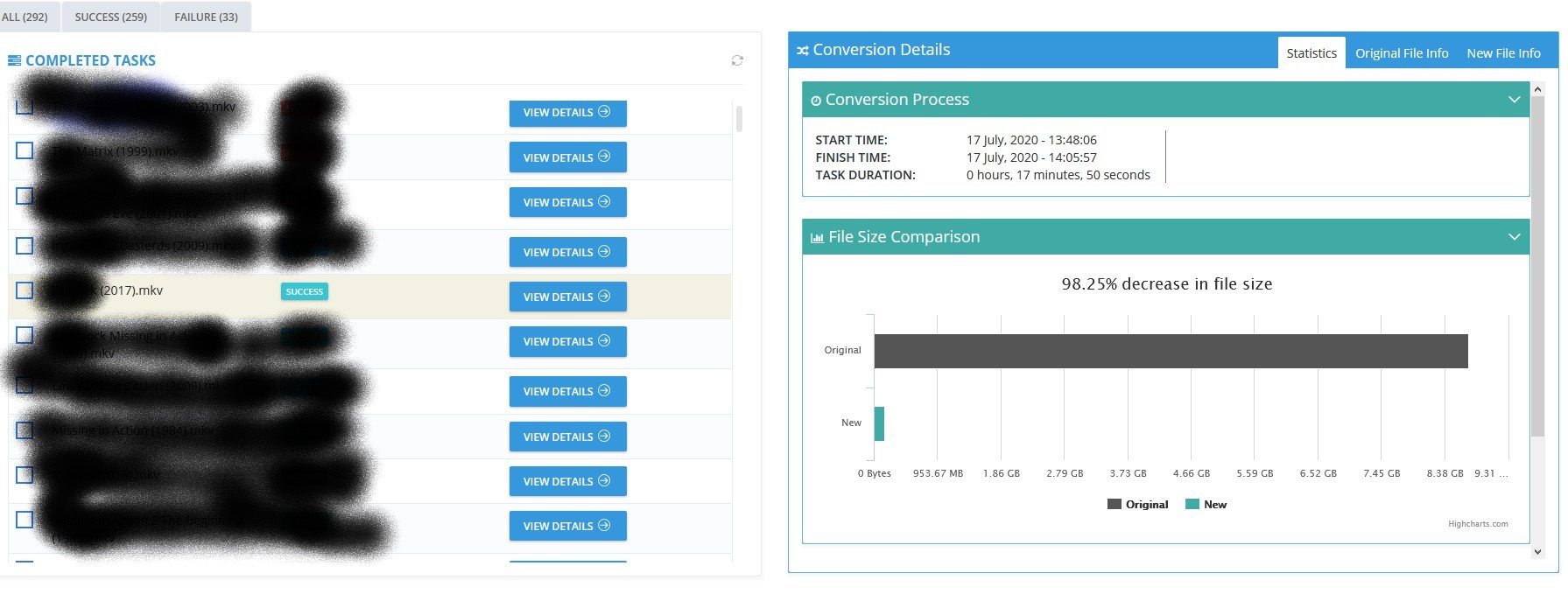

Is it normal to have this many failures? f996ccea931cae309871a748c87ab1b5.jpg
image.png.10d9a0405e1e8b570ba08ff1cae0ef05.png If its image based subs instead of text based it will fail. Mine also retry the same failures when it reopens.

Stupid question but I didn't see anybody else ask. I use NVidia encoding and sometimes the resulting file is bigger than the original. Is there a way if that is the case to keep the original file? Maybe even fallback to CPU encoding for that file?
Also, I have the audio set to convert to AAC and create a stereo track also. Why do I end up with two AAC stereo tracks if I feed it with a movie with a single 5.1 channel AC3 track?
Edited by thebaldconvict
I see the size issue as well. Usually with AVI and WMV files so I stopped converting those. I also just copy my files into a unmanic folder and see they are larger. Kind of a pain but oh well, there is an open issue on github for this
https://github.com/Josh5/unmanic/issues/118
