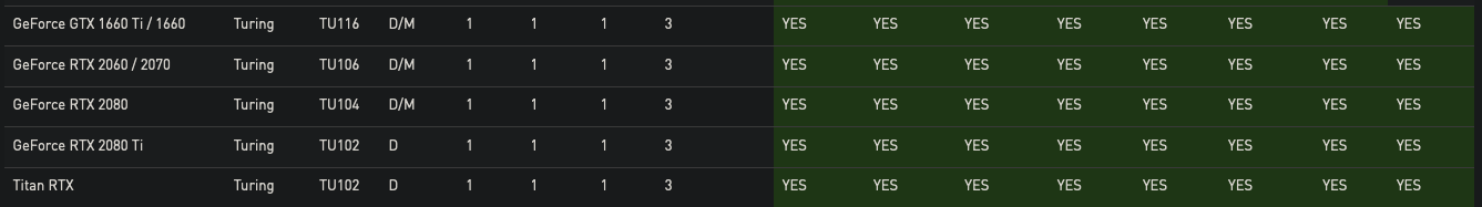

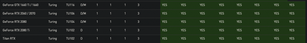

On 5/8/2020 at 9:12 PM, jmmille said:
Do you think different GPUs work better or worse at encoding?
Unless you're running the latest and greatest GPU's from nvidia, CPU gives a better encode with h.265/HEVC. Better quality and better compression. Just takes a lot longer which equates to more electricity being used.
GPU can perform the encodes a lot faster, but lacks B Frame Support for anything lower than a GeForce GTX 1660. CPU currently supports B Frame which is why we see such a reduction in file sizes. I would be curious to see 1) the final encode sizes on the Turing family GPU chipset (sans the GTX 1650) and 2) the encode quality coming from the Turing family chipset when compared to a CPU encode.
source: https://developer.nvidia.com/video-encode-decode-gpu-support-matrix

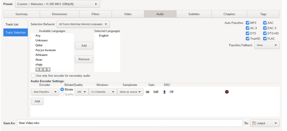

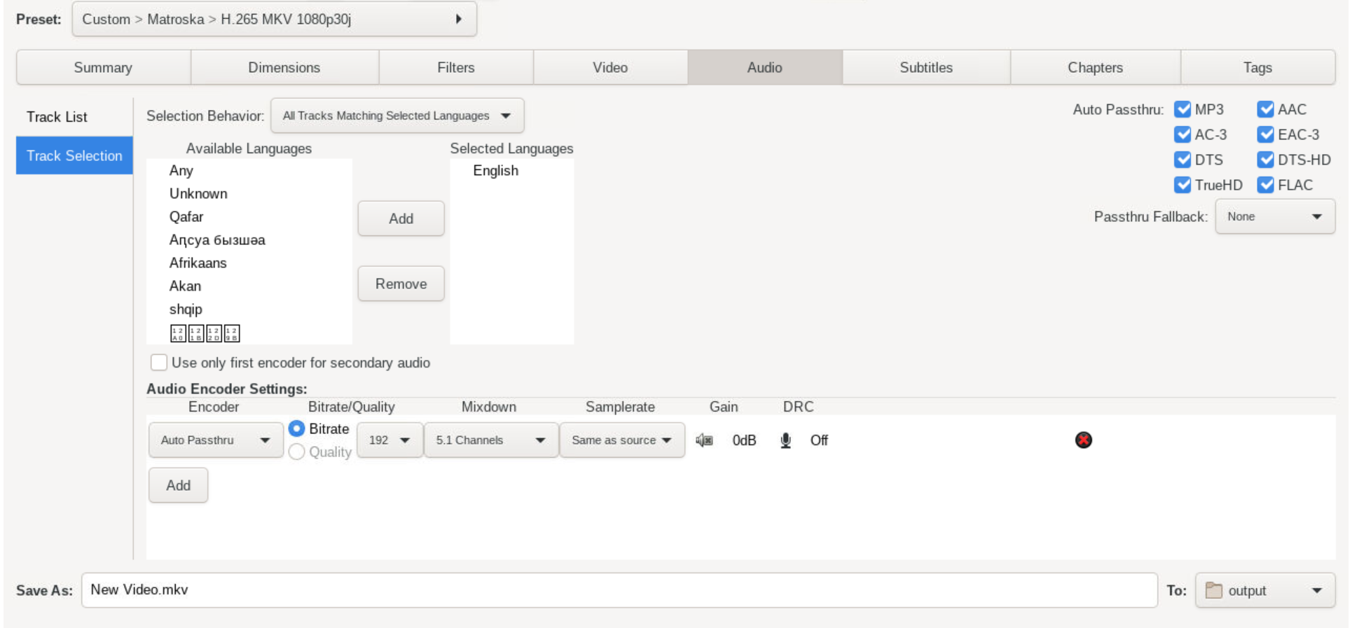

Hi Jason,
Have you managed to pass through a Dolby Atmos soundtrack in Handbrake? If yes can you let me know which version you are using?
Using the djaydev fork of handbrake which allows NVENC and removes quick sync I have been unable to pass through an Atmos sound track.
Thanks dgs2001
On 6/25/2020 at 6:35 AM, dgs2001 said:
Hi Jason,
Thanks dgs2001
I have Handbrake passing through all audio:
I'm using the jlwsage docker from the community applications
https://hub.docker.com/r/jlesage/handbrake/
I'mm only using CPU to transcode - no vid card
