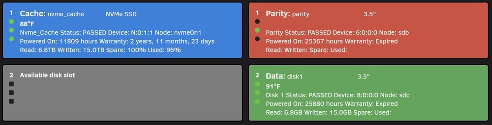

Hello all,
I'm new to Unraid and I just loaded this app to my server to find and mark down what drives I have. The server I got has two drives in one tray. When I try to add all the drives to the app, they just swap out with one another and do not add both drives to one tray. I hope this makes sense.
Am I missing something? I'd like to have where I can see what two drives are in each tray. I have a 6x4 with 48 drives.
Thank you
2 hours ago, G00se said:
Hello all,
Thank you
You can't add more than one drive per assigned slot. Rather add multiple slots if you do dual drives per slot.
Okay, when you say add multiple slots, what do you mean exactly? Thank you for your reply!
You must add 6x8 or 12x4 depending on the layout you want. No ways to assign two drives into same number/slot.
Oh I see, thank you.

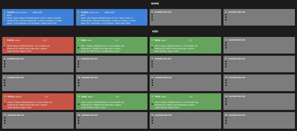

Is there a way to have the disk number in the disk location overview instead of the tray numbers?
So instead of
1 2 3 4 5
disk1 disk14 disk2 disk5
So instead of
1 2 3 4 5
No, visible via mouseover if configured so
LOL...I never tried that. Thanks...
