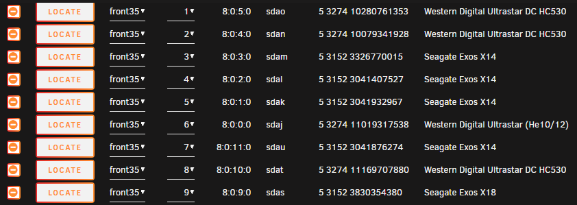

I just noticed something. Even though I have assigned the drive the picture at the top of the tray allocation tab states that they are empty.
I did a bit more digging, and it looks like something is reported multiple times:
All devices with path 1:X:X:X and 8:X:X:X matches the exact same drive state (ACTIVE/IDLE/STANDBY) when putting them up side by side for comparison.
E.g.:
  • 1:0:0:0 -> 8:0:0:0
  • 1:0:14:0 -> 8:0:14:0
  • 1:0:32:0 -> 8:0:32:0
This will create a conflict as it sees itself double. I don't know WHY this happens, but this is kernel level or so. Are the drives passed through VM or something like that?
It looks like your drives are assigned multiple times: PATH 1:0:0:0 and 8:0:0:0 are /dev/sdd (sg3) AND /dev/sdaj (sg37) it also matches the serial numbers.
This has to be the issue and why Disk Location don't wanna add it because of that conflict. I didn't think this would be possible, so maybe you know what's going on with your server. And please share if you know why this happens or why you need it (if).
I will have to open up the server and take a look at the SAS backplane on my supermicro cse-847. It has been awhile and I really can't remember how it is hooked up, But I do remember it working with version 2024 of disk location. I haven't changed anything, since 2024 version. But, it might have the cables in a way that it's creating a loop of some sort.

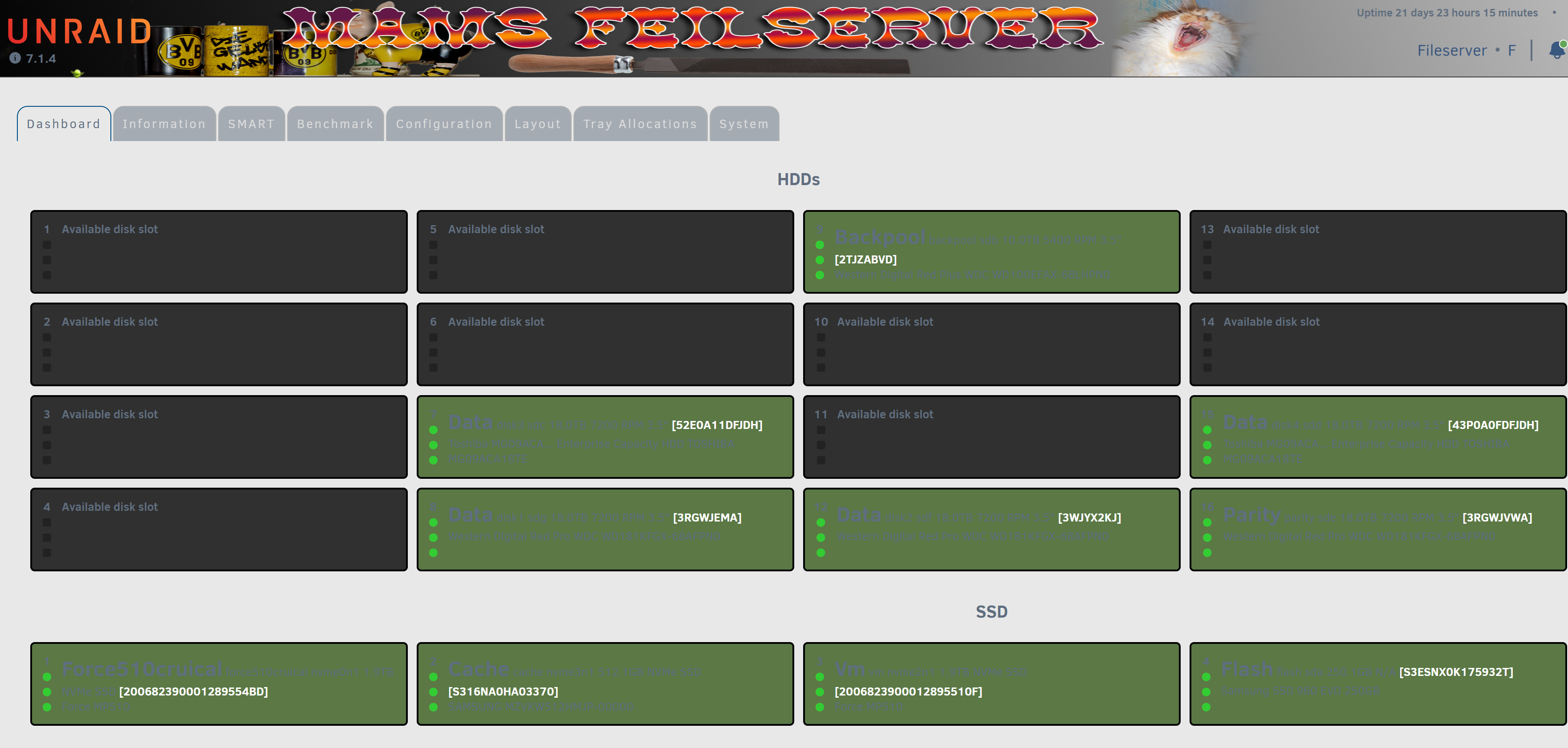

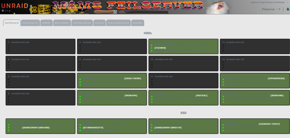

Color Scheme somewhere?
When running UNRAID with skins beside "black" and "white" this plugin is barely readable :-(
Example (with "Azure"):
There should be a way to configure text and background colors somewhere (yeah, I know "green" means "ok", but the text colors should give at least a little bit contrast...)
Edited by MAM59
Not going to go through all the themes, but you can change the background colors under Configuration, Layout and Tray Allocation, depending on how you wanna change the colors.
tnx.
switched to the brightest green, now the text is readable.
But you might consider to add config for the text and background colors and do not use the theme values that might be invisible.
52 minutes ago, MAM59 said:
tnx.
It's sort of impossible/inconvenient to do so. The text follows defined values by the themes. The background does not because it can't use ready defined "logic" colors. It's a small thing users have to configure themselves.
