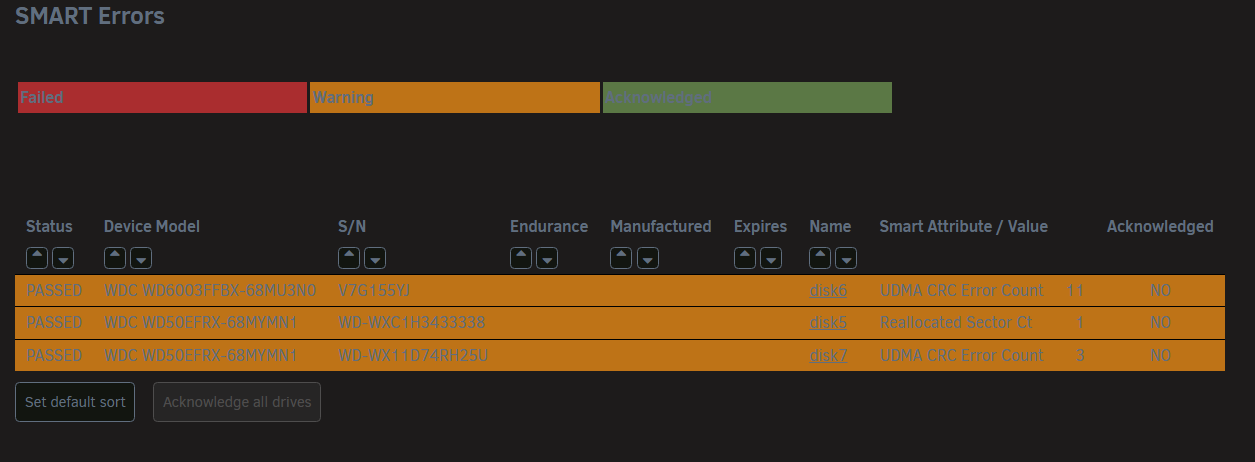

Would there be any reason why I cannot seem to acknowledge these errors and acknowledge all is greyed out?
Sorry if this has been answered elsewere, but I couldn't find the solution.Screenshot 2025-06-20 152240.png
Need to Allow editing of Unraid config in "Configuration" tab.
