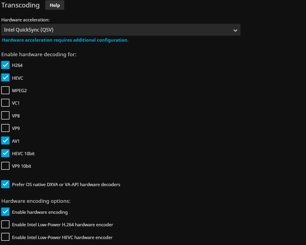

I am having issues with getting transcoding to work:
Playback Error
This client isn't compatible with the media and the server isn't sending a compatible media format.
I know it's an issue with the setting because turning off hardware transcoding lets me play the file.
CPU/GPU: Intel i5 12600k
File Type: MKV
Settings:

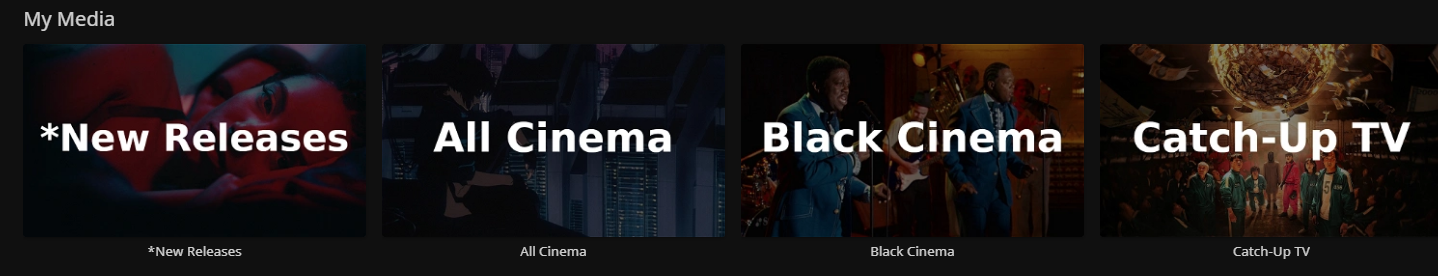

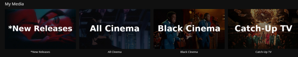

Wondering why my binhex Jellyfin doesn't have the catagory labels like the image below? How do I get my binhex Jellyfin to look like this?
Playback Error
File Type: MKV
Settings:
Did you ever find a solution to this? I'm having the same problem where turning off HW transcoding works in WEBUI, but turning it on, gives me the same error. Running i5-13600k.
