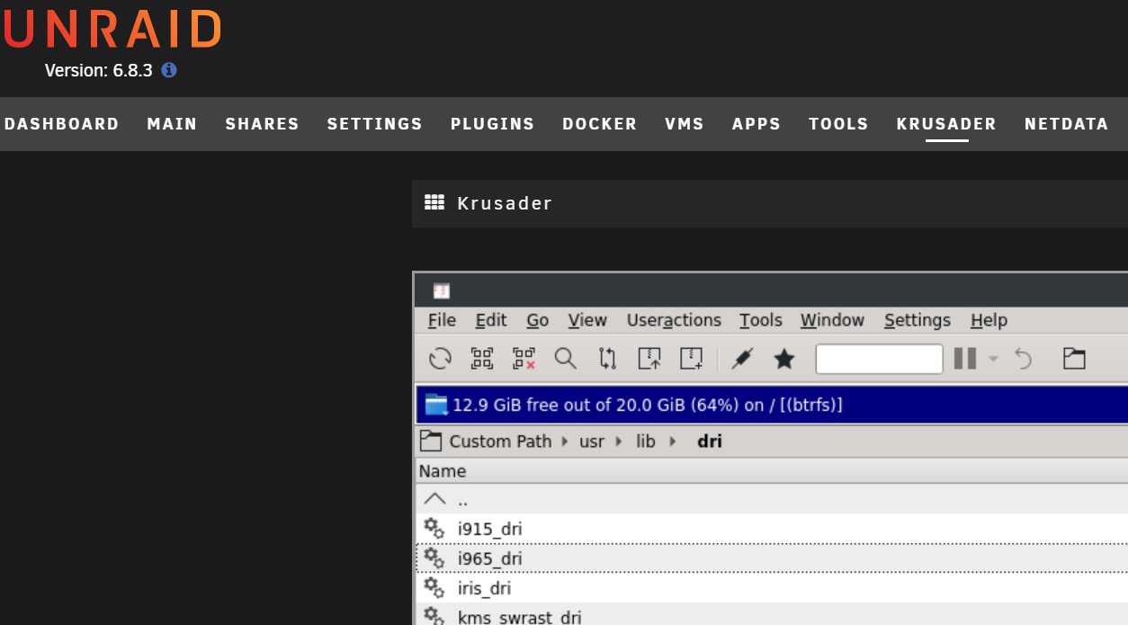

Looks like it uses the i965?  I tried this:
root@unRAID:~# modprobe i965
modprobe: FATAL: Module i965 not found in directory /lib/modules/4.19.107-Unraid
root@unRAID:~#
I checked and I don't even have a "lib" directory, just some other directories that start with lib.
Do have the i965 driver in unRAID though.
Edited by craigr
Just too tired...
So changing the CPU caused the MB to also automatically change settings back to defaults in the BIOS.  I just had to go back in and turn on my onboard graphics.
The i915 and i965 both use the same module so that could never have been it.
