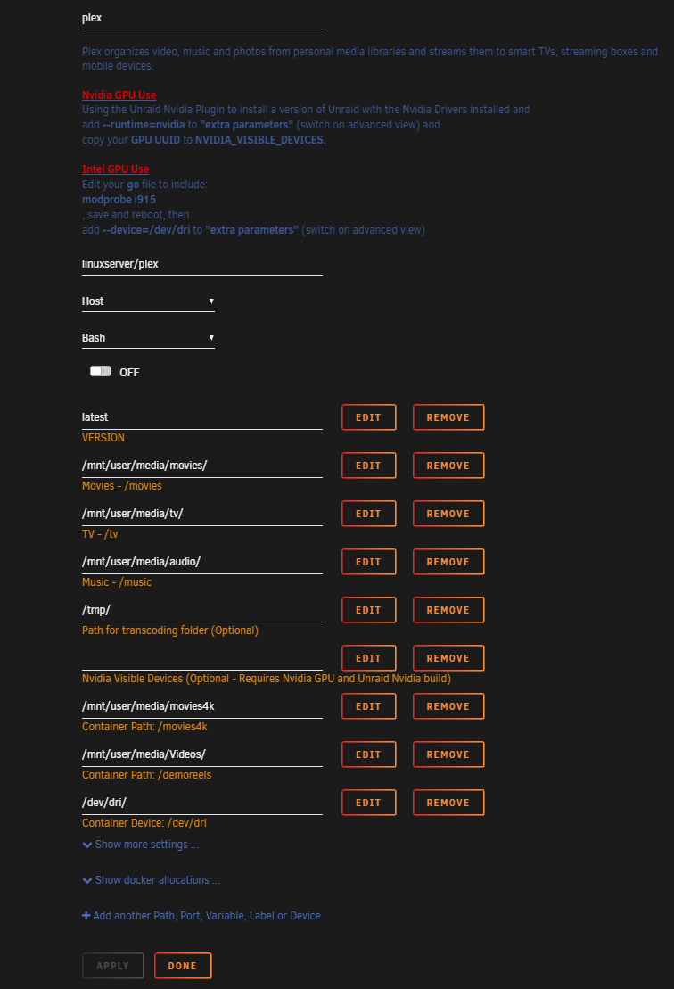

docker setup;
(i have tried public/docker/latest/plexpass though i think thats not for linuxserver)
(i have also tried setting --device blahh:blah as an extra paramater but im led to believe this method is broken/outdated)
(added as an extra device both as /dev/dri and as /dev/dri:/dev/dri neither work)

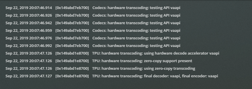

since downgrading to 6.6.7 the logs show it has a VAAPI provider and is using it before it would say hardware accelration is enabled but not hardware device exists (or something like that)
but both plex and tautulli show no HW decoding is present (again changed since going back to 6.6.7 before hand it would show HW in the dashboard but would play nothing, now it doesnt say HW but it still plays nothing)

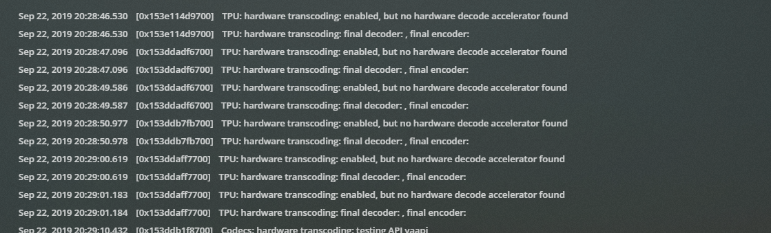

so i noticed that /dev/dri wasnt set to 777 even though its in the go file so i manually did it restarted the plex docker and it still doesnt work but now the logs show this;

It's late, I'm tired but; "no hardware decode accelerator found" - You can't hardware decode on Linux, end of. Hardware Encode fine. Which is what Transcoding is doing so that log means very little here.
Also "Throttled" suggests Plex is throttling the data due to bandwidth restrictions not transcoding. I mean it LOOKS like your trying to play a MKV in 480p, but I don't know the original video and I don't know the source and the destination for the network.

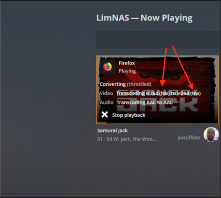

It looks like you've done everything right with regard to the setup for Hardware Acceleration, so I'd be concentrating on why Plex is Throttling not transcoding. I have attached a screenshot of what a 1080p => 480p Hardware Transcode should look like.

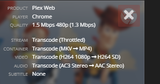

And in the Guide it shows a picture of the "throttled" status and underneath it:
"As you can see this file is being direct played, so there's no transcoding happening."
So -1 for Speed reading when tired. Still I do think the issue is with Plex, not this guide. I can't see the sharing of this device going that badly wrong that it's intermittent.

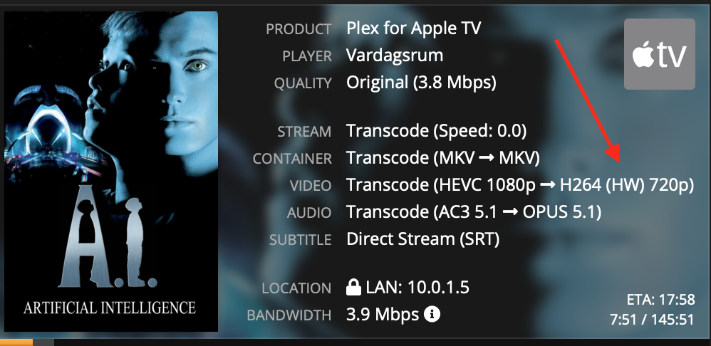

I have followed the guide without problem. But I'm not sure it works anyway.
Because when i compare how it looks i see only one hw and others have two.
Why?
916765143_Skrmavbild2019-10-09kl_15_44_33.thumb.png.cb2b675456c85269df7f3974da969459.png

25 minutes ago, Taddeusz said:
@Lappen71 What CPU do you have? To support HEVC hardware decoding you need at least a Skylake CPU.
No i have Inte Xeon. But why does it show hw anyway?
Which model of Xeon do you have? If you notice it shows “hw” for the H.264 video just not for HEVC. It’s a newer technology that requires a Skylake architecture or better CPU.
Its an Intel Xeon E3 1225 v3
It you look at the picture it shows hw even with HEVC but only in one place.
@Zonediver Just to discount Quick Sync hardware acceleration out of hand because it doesn’t meet your own quality standards doesn’t mean it wouldn’t be acceptable for others in different situations. Coming on here berating others for using it is rather rude.
The left side is the original video format, in this case HEVC. That’s what it is decoding. The right side is showing that it is encoding to H.264 using hardware.
 Your E3 is a Haswell architecture CPU so it cannot decode or encode HEVC in hardware.
