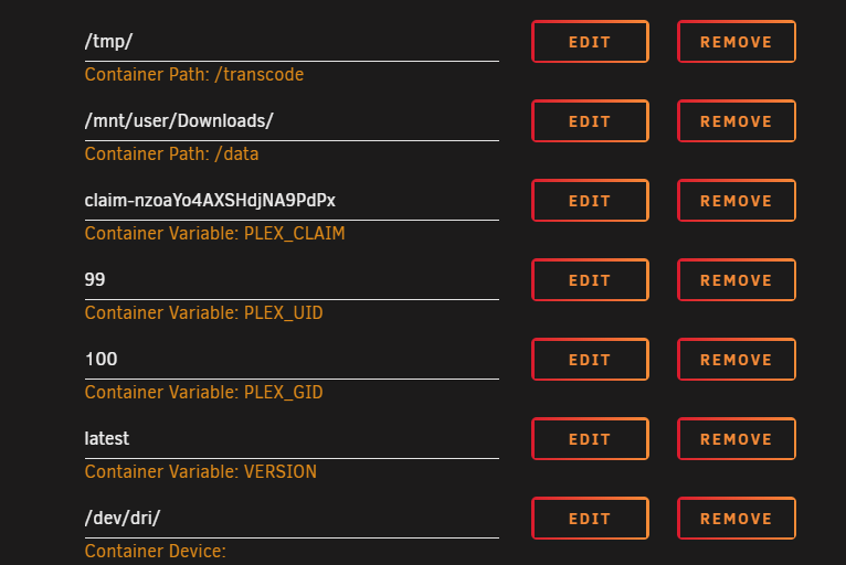

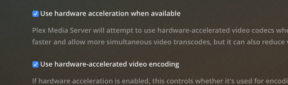

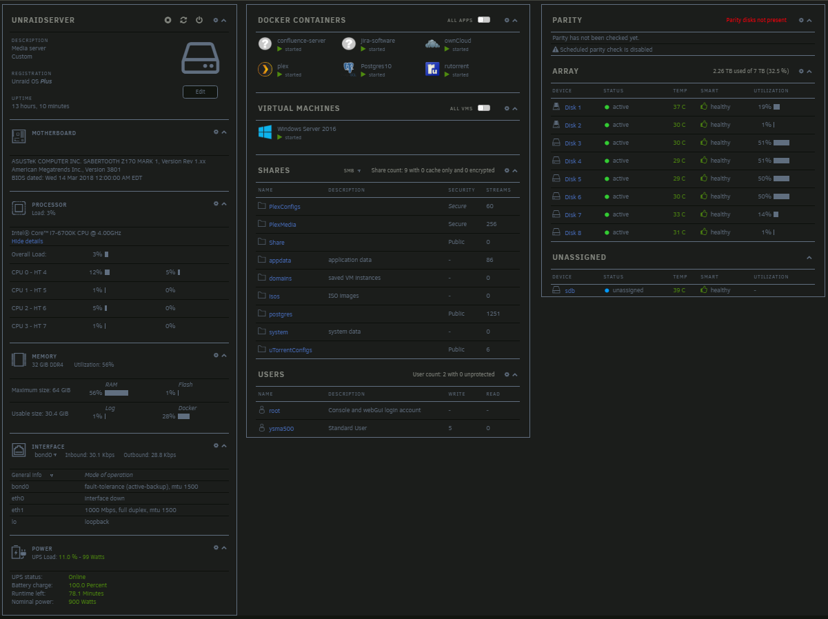

So, I've been trying to make this work for 2 months now using tutorial over tutorial and always leading to the same weird issue. New to Unraid and new to Plex but I have some knowledge on Ubuntu, docker and networking.
Machine hw is:
i7-6700k running at stock,
On a Asus z170 Sabertooth Mark 1 on most recent bios version,
32 Gb of Ddr4 at 2133Mhz,
With 6 hdd and 2 ssd in an array.
All of that on a 650w psu.
My problem:
I can do every steps and validate that they are done by having the device in the container's file system. As soon as I setup hardware decoding in plex's settings and test it with any file, server crashes, immediately close and has a bad time booting back up (some times taking 3-4 restarts before starting bios and then unraid). I can transcode on cpu fine but to a max of 2-3 streams and my other containers (which I disabled to test plex) can become slow-ish. I really don't know what I'm doing wrong and what logs or screen captures I could give to diagnose this as everything instantly closes.
Ysma500
A sad Canadian.
Edited by ysma500
added motherboard's chipset and dev/dri bypass in terminal.

So yeah, I was wondering if I was doing something wrong before putting the blame on hardware.
I didn't explained my idea clearly about "cpu transcoding". What I meant was that I can transcode using cpu cores instead of Quicksync, but then it is making my machine slower because of cpu usage. I've been using this method for the last 3 weeks without any crash.
For the "clean power" part of things, my box is connected to a UPS CyberPower 1500VA battery side to keep it running clean:
here's Unraid info read of the ups.
Really tried stuff over here... wondering if my "iGPU enabling" in BIOS isn't done the right way. I'm more of a AMD guy and not that familiar with Intel Bios setup. This was my brother's PC, and this motherboard is like no one I've ever seen, wondering if Asus played a little with the standard feature sets of z170 bios.
Here's my dashboard to have an overview of my setup:
Thank you for the fast reply,
Ysma500
A slightly less bummed Canadian.
Edited by ysma500
Added dashboard snip-it

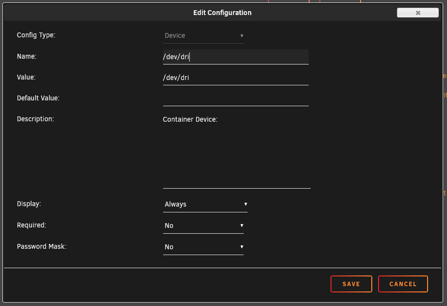

Do you have a link to a guide on how you got handbrake to use the iGPU for transcoding?

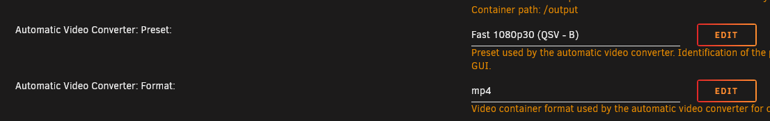

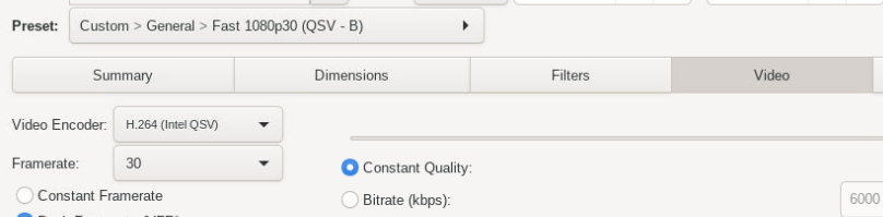

1. Configure /dev/dri as a container device in the HandBrake docker container configuration:
2. Create a preset in HandBrake that uses QSV as video encoder (will only appear if /dev/dri is passed through as a container device):
3. If desired, set the custom QSV preset as the Automatic Video Converter Preset in HandBrake container:

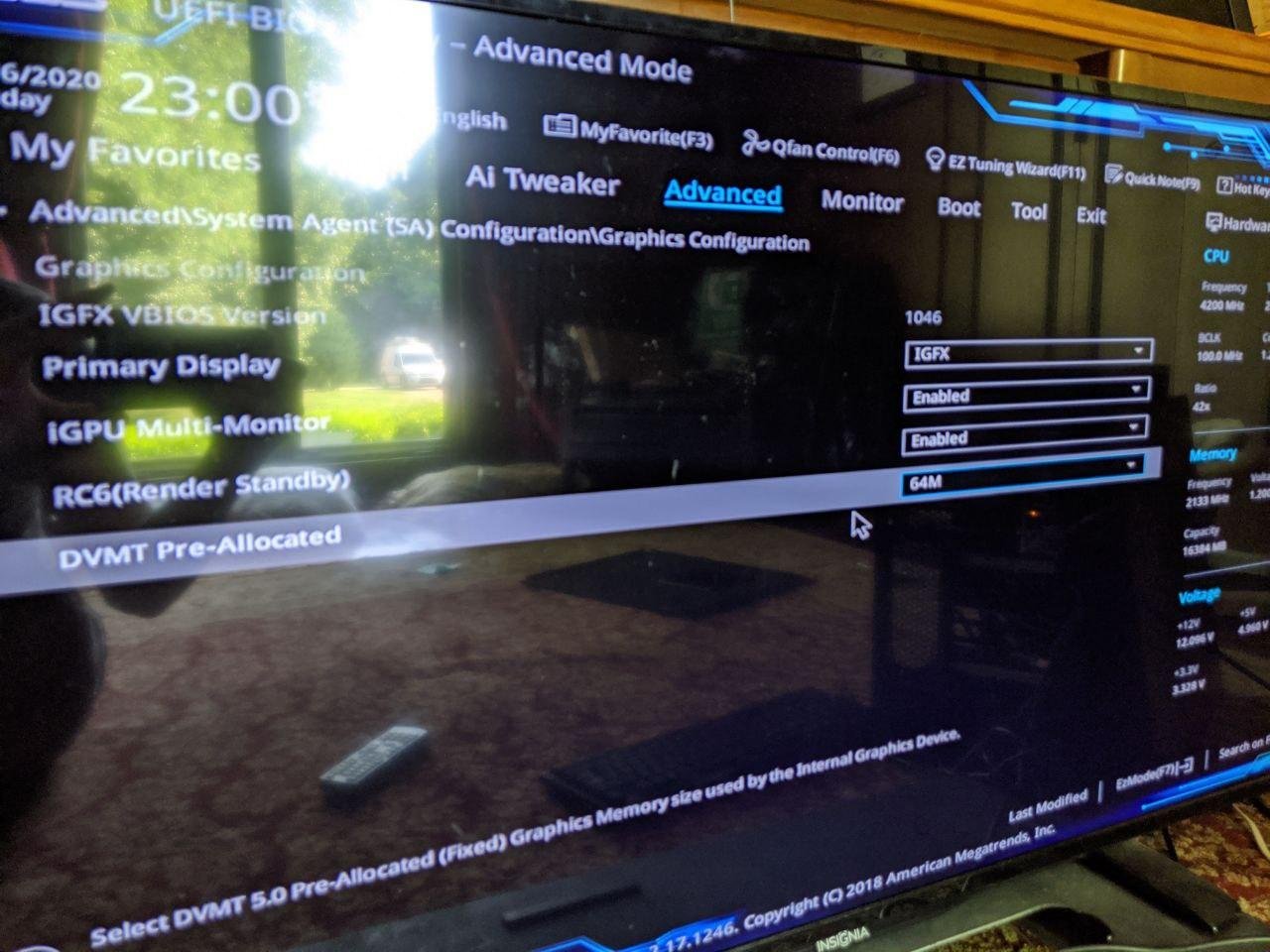

In your BIOS, you need to set your Primary Display to IGFX (Auto will not work):
You should also enable IGPU Multi-Monitor
iGPU needs to be the primary (or only) graphics display in order to load /dev/dri drivers for transcoding.  Auto is going to select a different graphics adapter if you have a PCIe adapter installed and it doesn't work to load drivers even if iGPU is only graphics display.
With IGFX as primary and other PCIe graphics cards present, you should be able to assign PCIe graphics cards for other uses.
@DannyDonahue It may also be necessary to have a monitor attached to an iGFX port. When no monitor is attached to an iGFX port my motherboard will auto select the PCIe graphics card even though it's set to boot with the iGFX as the primary. What I ended up doing was connecting the VGA port to the motherboard and HDMI to the PCIe graphics card for my VM.
