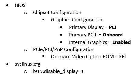

So I tried this and everytime I turn on Hardware transcoding it kills the Plex Media Server application.
What all did you do? What exactly did you change in your BIOS and syslinux.cfg?
Edited by ramblinreck47
@Geran, did you do any part (or all) of what’s pictured below?
