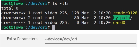

terminal commands in UNRAID execute correctly.
edited Plex container and added Drive with mapping
Value:/dev/dri
Transcoding doesn't show (hw)
Also tried
Value:/dev/dri/     (note ending forward slash which was auto added, since I picked the folder from a dropdown list)
doesn't work.
Also tried
Value:/dev/dri/
doesn't work.
Any help?

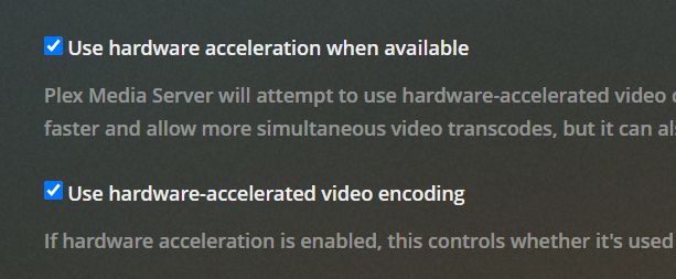

You have Plex Pass and have enabled hardware acceleration in Plex server, correct? I assume so since it is mentioned in the guide. but we just need to verify this.
I use the Extra Parameters method, but, the device method should also work.
Edited by Hoopster
Ops. I don't have Plexpass. I'll get one though.
Edited by tmor2

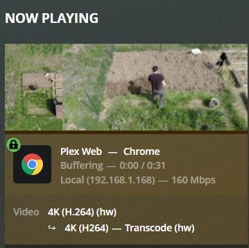

I can transcode in hardware 5 4K HDR streams concurrently on my i5-9600k with embedded UHD630, as I mentioned a few weeks ago:

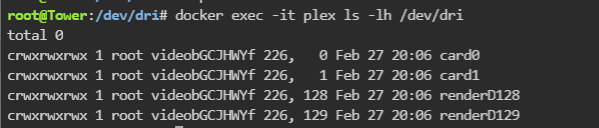

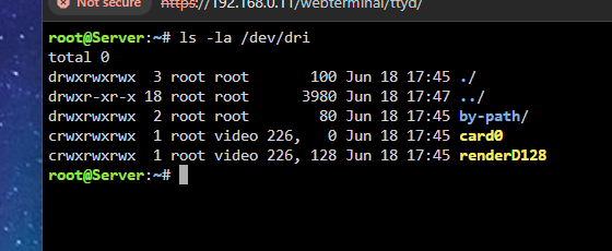

Gah; I can't get mine working! I can see the listing in /dev/dri -> ls, did a modprobe i915, added the /dev/dri to devices in the settings. When I used "docker exec -it plex ls -lh /dev/dri" in the console, it returns both my iGPU as well as my PCIE GPU: image.png.e327778a0e94457b582364e6159cef2c.png
Still, it doesn't work off the iGPU and instead continues to software transcode. I made sure to as well establish the transcoding is enabled in Plex.
For context, I'm using the ASRock C236 WSI paired with the i7-7700K, with my 3060ti thrown into the PCIe slot.
I assume that the iGPU does exist and is usable, since I went ahead and installed Handbrake and added the /dev/dri to its devices. It does show it as an option in the Video Encoder: image.png.1cff21d5af87789384fd34596bd2265a.png

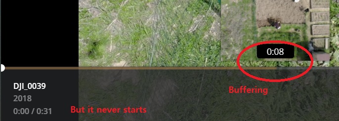

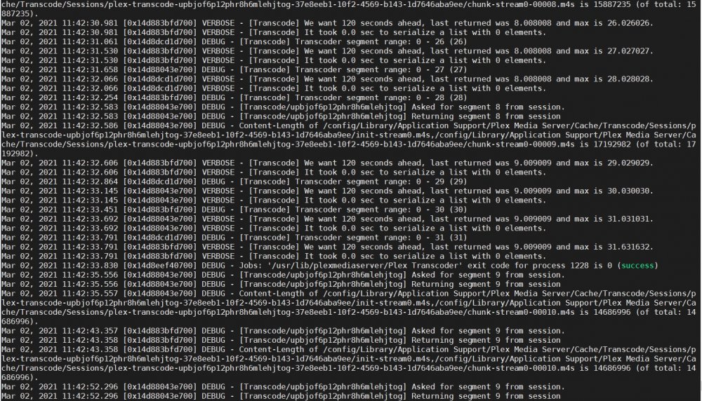

hi, sorry in advance for my english, i hope to be able to explain myself well.
I have a problem with plex transcoding.
my build is:
Unraid 6.9.0 (i had the same problem with 6.8)
linuxserver/plex
ASUS Prime H310I-PLUS R2.0
I3-9100
Crucial RAM CT16G4DFRA266 16GB DDR4 2666
I believe I have configured everything correctly as follows:
The appdata use cache pool.

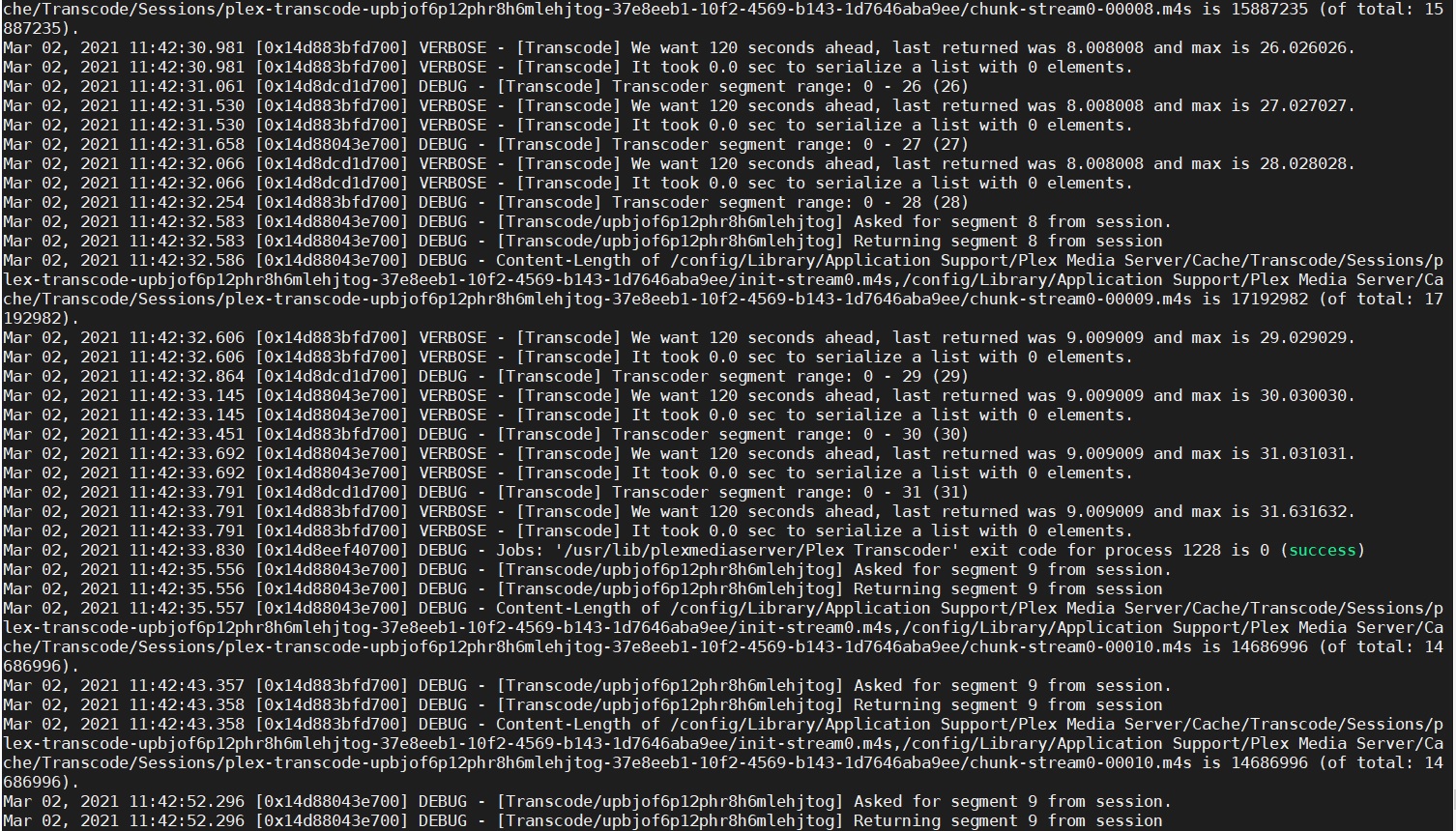

But it doesn't work, i see the trascode in plex
the stream never starts and seems just to buffer up to 8 seconds.
I tried to look for the plex logs a bit (tail -f PlexMediaServer.log | grep Transcode
), below a printscreen
Anyone have any suggestions?
