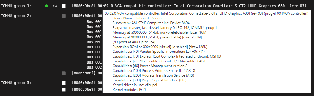

Thanks for the tip. I took a look at cragr's post, but my \etc\modprobe.d folder does not have any of those "blacklist" files. It's an empty directory.
I also don't have any of the directories \flash\config\modprobe.d\ to create an empty i915.config file, and am unable to create these directories in Krusader.
Any ideas?
Here's what I have listed in Tools > System Devices if this is any help.
Edited by MuNaught

Problem solved. I'm documenting this in case someone runs into the same issue.
The last 2 lines had already been removed from the go file.
touch /boot/config/modprobe.d/i915.conf worked, and I've rebooted since just to be safe, but the graphics card was still not working with Intel GPU Top nor GPU Statistics.

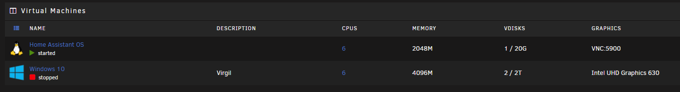

I then noticed that my Windows VM was set to iGPU. I stopped the VM, changed this to VNC and re-started the VM.
Boom. Everything is working. So there you go, if you're having a similar problem, make sure your VMs aren't using the iGPU.

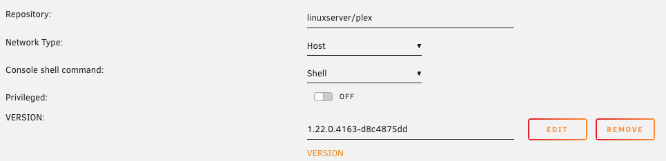

39 minutes ago, TopherHax said:
If you have an issue HDR to SDR tonemapping then downgrade plex to version 1.22.0.4163
There's a bug in plex, they are currently working on fixing it but until then downgrade is best solution.
But, how do I do that in Unraid with Plex in docker? Is there an easy way?
Edit: I'm using this docker (are there any differences on the dockers, anyone I should use instead?). https://hub.docker.com/r/linuxserver/plex/ and when when changing from "latest" to "1.22.0.4163" in VERSION on the "edit docker page" in Unraid and press Apply, I'm still on Version 1.22.2.4282 in app.plex.tv when I'm checking from a browser.
Edit2: Is it version-1.22.0.4163-d8c4875dd I shall write instead? Or do I need to specify more?
Edit3: 1.22.0.4163-d8c4875dd was the exact line. Now I'm down do the working version.
When Plex has fixed the problem, what is the best version to be on then? docker, latest or public?
/Söder
Edited by soder

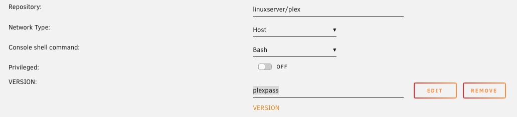

I can also confirm this is now working correctly! My unraid is still 6.9.1 but running the "plexpass" version or Plex.
If you are running the official PLEX docker and want to run the PLEXPASS version, you should also change your repository to:
plexinc/pms-docker:plexpass
/Söder
