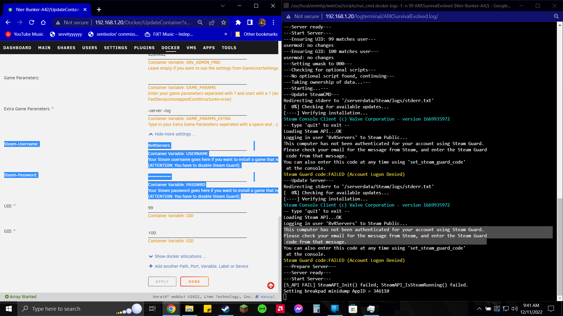

It shows it over in the logs. I know it works without I just thought I needed it to access configs.

Can you share where it says that maybe a screenshot?
Have you put in your Steam credentials in? If yes why? The Steam credentials are only needed of they are marked with the red asterisk and not under the show more section in the template.
I did but it's more or less a rando account I made thinking it was need at first. But since I had it I was going to see about using it.
No, please remove the user from the template, Steam credentials are only needed when it explicitly mentioned!
Why? This will only cause trouble.
Please stop the container, remove everything that was created so far in the ark directory which is located in your appdata folder, remove the credentials from the template and then start the container.
Please note that the first startup will take very long and you may see nothing in the log for a few minutes.

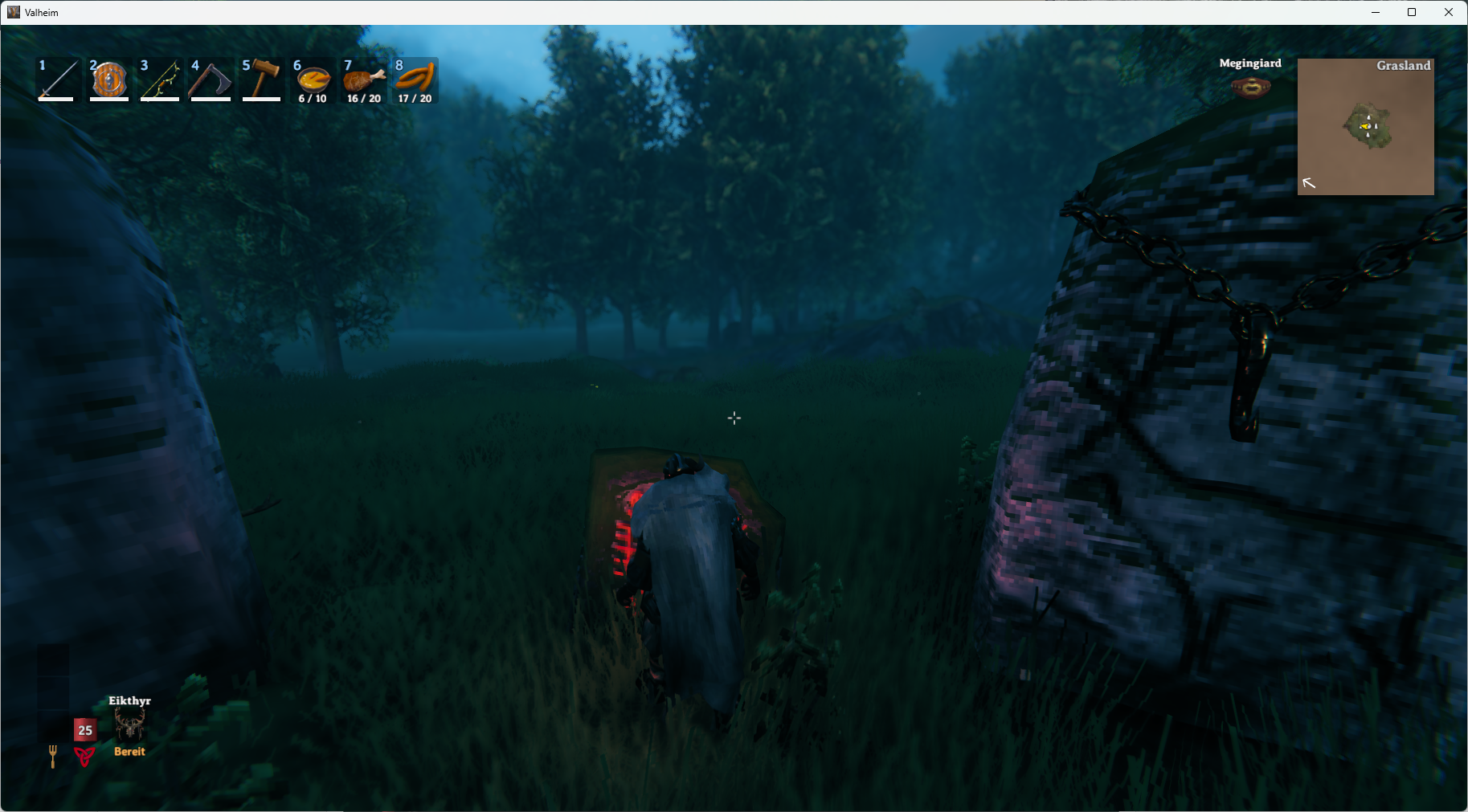

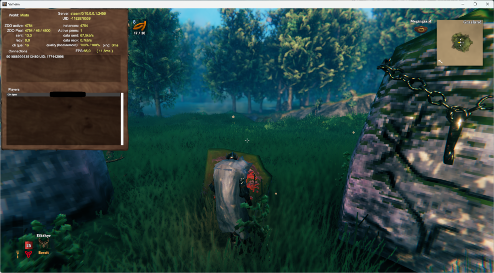

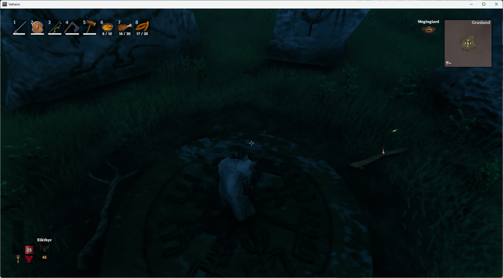

1. Valheim Docker stopped and files I sent you copied over
2. Start Valheim Docker.
3. Seed it should have loaded (khryss)
4. Seed it actually loaded (eqCUjmcgsd)
5. Correct file with seed I want.
5. .fwl file with wrong/random seed that it loads and appears after renaming correct/wanted files.
So weird.
