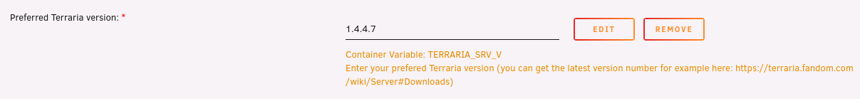

Hey, I'm having an issue with my Terraria server mismatching my client version (the server, 1.4.4.7 is a few updates behind, 1.4.4.9). Is there some way I can update the server myself?
Edited by Snortiblog
Added some more info that might be useful
To what game version is it set in your Docker template?

I feel like an idiot for not noticing that lol, but it worked perfectly thank you!
