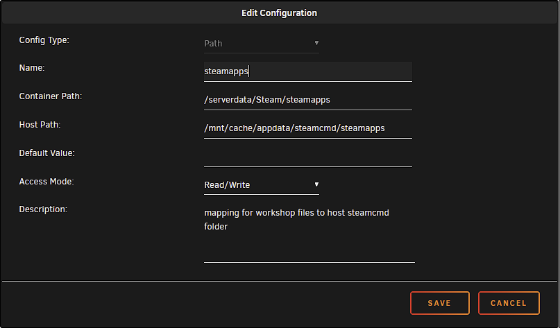

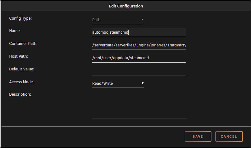

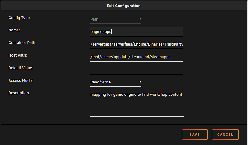

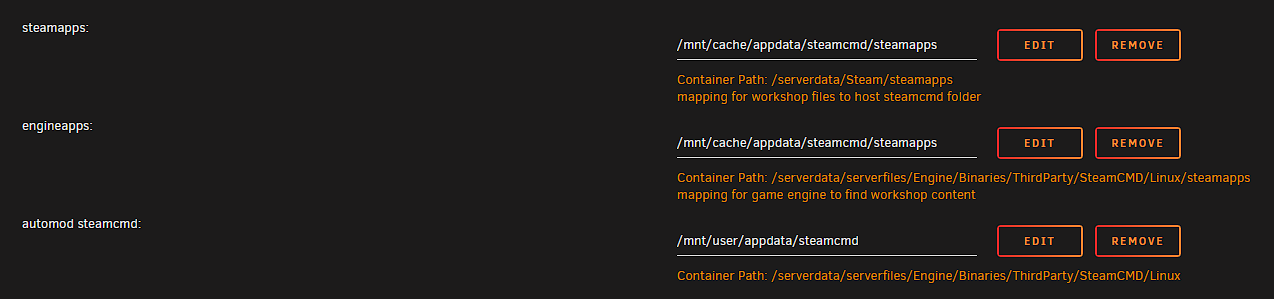

Hello @KyrVorga, yes, you are able to use mods with this container.  It has been quite a while since I set this up so please bare with me, there is more detail somewhere within this forum topic which is how I was able to get this working, if I come across the posts, I will be sure to share them.  In the meantime, here is some information on my current setup that has been working for quite some time.
Within the Docker setup in the "Extra Game Parameters" you need to make sure to include "-automanagedmods", if you are setting up a cluster you will want to make sure this is only on the first map to startup within the cluster, also make sure that you give the first map plenty of time to startup before the next map in the cluster starts to give the mods enough time to update.
You will also need to add extra parameters to the Docker template for the steam workshop, again, this will only be setup on the first map that starts up in the cluster if applicable.
Full container path in the below screenshot is:  /serverdata/serverfiles/Engine/Binaries/ThirdParty/SteamCMD/Linux/steamapps
I hope this information is useful and is able to get you up an running with mods.
Edited by DBone-Unraid
Fixed a typo for "-automanagedmods"

Bless you good sir, that is so helpful. that should be all I need to get it running : )

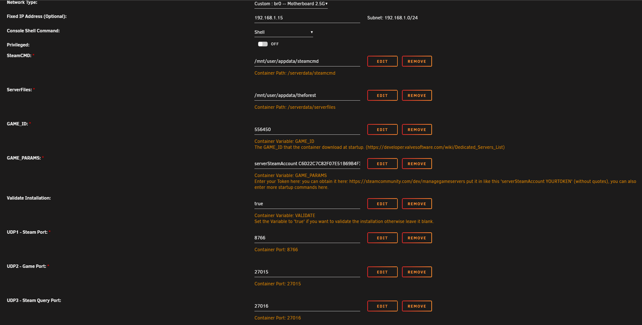

Hello,
I'm currently trying to run the "TheForest"-Docker, but I'm getting some errors.
Some general information of the system:
- UnraidOS Version: 6.11.5
- Ports 8766, 27015, 27016 are opened on the router and forwarded to the game server
- Created token for App '242760' and pasted token in GAME_PARAMS like mentioned in the docker description: 'serverSteamAccount C6Dxxxxxxxxxxxxxxxxxxxx'
- Created the docker with the other parameters like in the image shown below
- The docker uses custom network type with a fixed ip address
- Internet-Provider: Vodafone (GigaCube --> no public IP)
- UPnP enabled
The problem is:
- server is not shown in the multiplayer list (also not LAN)
- ports 27015, 27016 are open, but 8766 is closed (scanned with nmap)
- getting errors according to the startup log (I assume Wine?)
- the steam service can't be loaded (maybe that's why the port is not open), see service_log
- the steam page with all game servers (steamcommunity.com/dev/managegameservers) shows that the token was never used
Some ideas from my side:
- Steam Service didn't start up, that's why port 8766 is not open
- Because of Vodafone-Provider Steam can't directly connect
(I heard some time ago that Vodafone uses an additional Firewall;
I had some problems with that already during setup of a WireGuard VPN but couldn't connect / ping to my router)
Has anyone an idea why the server is not working properly?
If you need any additional information, just let me know.
Thanks for your help!
If you are behind a CG-NAT there is nothing I can do about reaching it from the outside world, I would recommend that you ask your provider if they have a plan with a static IP so that you can forward ports to and form the outside world.
Why? This is not necessary.
That's just normal because the game servers use a proprietary protocol and don't answer to default requests.

The container is definitely working properly and running, how much CPU and RAM does the container use?

Do you have a cache drive installed? Please use the path /mnt/cache/appdata/... instead of /mnt/user/appdata/... if possible but please also make sure that you've set Use Cache to Prefer in the Share settings. The use of /mnt/cache/appdata/... is not done by accident.
Yes I have two cache drives installed. Use Cache of 'appdata' is set to 'Prefer'. There are two paths to appdata within the docker template. One for SteamCMD and one for theforest itself.
Shall I change the path of both entries or just the one for 'theforest'?
For the testing now I will set - as mentioned in the template - only the ServerFiles (theforest) to the given path (/mnt/cache/appdata/...).
Thank you for your help and have a nice evening!
The SteamCMD path can use (and is set by default to) /mnt/user/appdata/... but I recommend for the game files to use /mnt/cache/appdata/... to avoid some weird issues.

Just tried again with network type = 'host' and the docker gets stuck just after DS configuration tests. The whole startup is attached.
I can't se anything obvious why it shouldn't work but TBH I've never tried to run the container in host mode and I would never recommend doing that because I see no point why you would even do this.
Anyways did you turn on validation in the template? If yes, please turn it off again since this is only meant to be turned on when you have some issues and the container is not updating the game properly if the developers release a update.

Thanks for the reply!
I will change the network type back to standard 'bridge'. I thought there could be some issues if running the docker in bridge mode.
I have validation enabled, but I'll change it back to disabled.
Good to know that it's only for updating the container, thought it couldn't hurt to enable it :-)

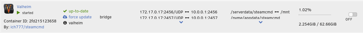

I'm getting the following error when running the Valheim SteamCMD server:
/opt/scripts/start-server.sh: line 255:    65 Trace/breakpoint trap   (core dumped) ${SERVER_DIR}/valheim_server.x86_64 -name "${SRV_NAME}" -port ${GAME_PORT} -world "${WORLD_NAME}" -password "${SRV_PWD}" -public ${PUBLIC} ${GAME_PARAMS} > /dev/null
Trying to run it on an OVH VPS (1 core 2GB memory). Is there somewhere I can trace the log and see what is causing this issue?
What OS are you running on that Server? Keep in mind that you need to run something recent like Debian 11 or on of the newer Ubuntu releases.
1 Core and 2GB of memory are way too less resources for Valheim and I think that it crashes because of too less RAM.
For example this is my container (with Valheim Plus enabled) and no one is playing on there currently (i5-10600):
(this is even without system resources, this is only the container)
Within the Docker setup in the "Extra Game Parameters" you need to make sure to include "-automanagemods", if you are setting up a cluster you will want to make sure this is only on the first map to startup within the cluster, also make sure that you give the first map plenty of time to startup before the next map in the cluster starts to give the mods enough time to update.

So it seems there is a space in the name for this path.  This prevents the volume from being mounted as the volume path has to be absolute.
Not sure where the name Linux is set nor by what or how but it will change how we have to map the volume.
/mnt/YOURCACHE/appdata/ark-se/steamapps/ will now have to be mapped to /serverdata/serverfiles/Engine/Binaries/ThirdParty/SteamCMD/Linux /steamapps
