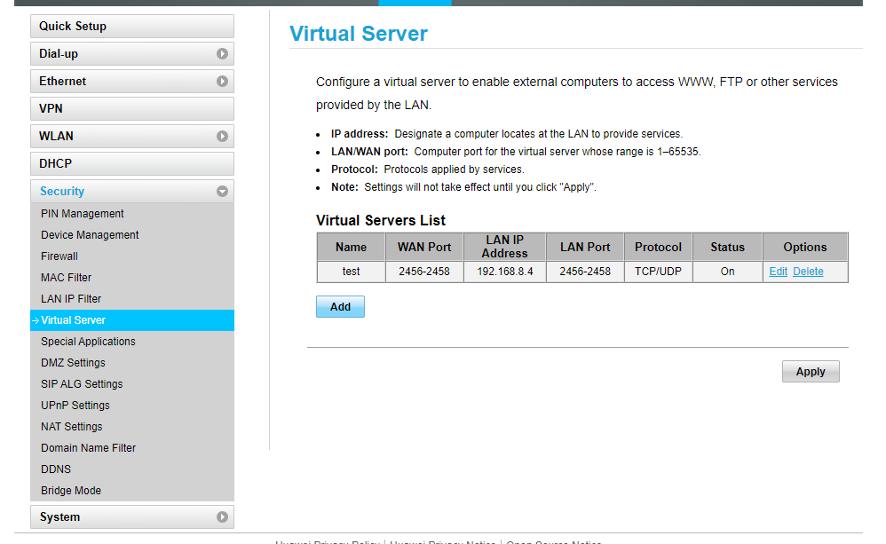

I got it up and running on local, but I can't get it working on WAN.
I have a Huawei B529s-23a router with static public IP
If you got it running locally then the server is definitely working.
I really can't do or say much hwy it isn't working. Are you sure that you have a static public IP address an you don't have a CG-NAT?
It could also be the case that you hair pin NAT is not working correctly, have you yet tried it to connect to the server from the outside world so to speak from not inside your LAN with your public IP address?
BTW please only forward the necessary protocol which is in this case only UDP, reason behind this is that some game servers won't let you connect if you forward TCP too for example.

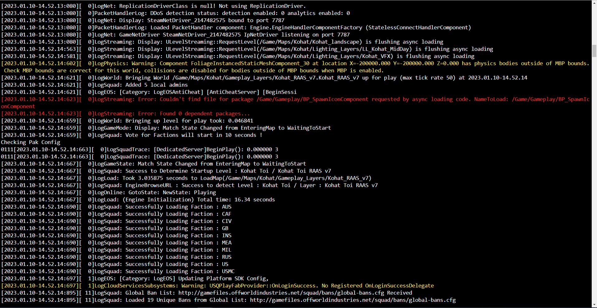

@ich777 I'm not sure if these screenshots help at all with troubleshooting:

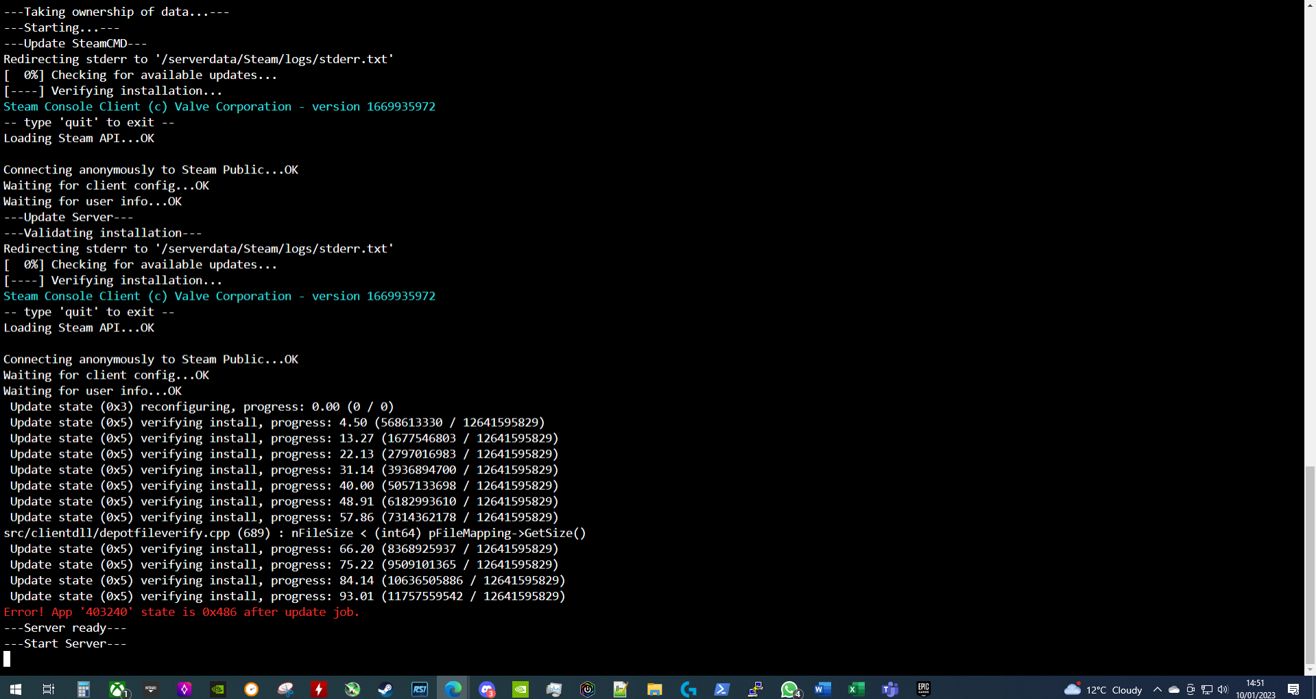

I just tried now, today. Also tried yesterday, didn't work.
No adblocking I am aware of. See previous post.
Something seems off with the files when verifying the installation, can't tell what this error is exactly because I've never seen such an error before...
Do you have enough free space on your device?
Is it possible for you to stop the container, rename the folder for squad to something different like "squad-backup" in your appdata directory and start the container again?
With this the container will pull the files again from Steam so that you can see if a fresh installed container is working and you have all your "old" data in the backup directory as mentioned above.

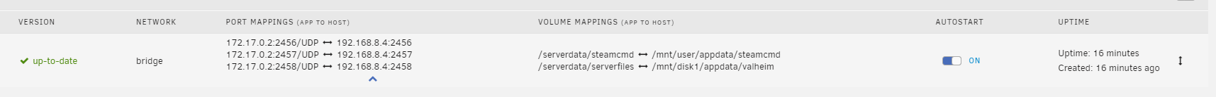

2 minutes ago, kjpolker said:
As for CPU and RAM here is the following:
Please turn on Advanced View on the Docker page and send a screenshot from there.
Have you yet tried to disable BepInEx and try to run it without any modification?

Default port is 27015
CS Source showed up instantly upon forwarding the port (or perhaps coincidentally between it not showing up initially and me forwarding the port). Even more interesting...
Valheim stopped to test this (I have not made changes to Valheim since last post and it still resides at complete default settings when spooled up).
If curious, I did spool up Valheim again after this screenshot (with CS Source running), refreshed the Servers list and no difference.
Edited by kjpolker

Tried all the following and nothing 😕 to include the ServerIP and tried my ExternalIP. I even removed all mods from my valheim game folder and reset it to new with no luck, deleted the port forwarding rule and reimplemented it. Verified in the Unraid directory the app ID and game ID was accurate. At this point I will try on another computer and see if that makes a difference.
Edited by kjpolker
@ich777 Okay so on a second computer I was able to see the server populate in the Steam browser for a short few seconds then hide, but I CAN connect to it via there as well as within Valheim by entering the Server IP on my local network. At this point I am not sure what's going on with my desktop computer. I couldn't ask for any more information from you unless you have any expertise on what could be going on or for me to look into, I am at a loss why this would be any different... The docker seems to be fine and I do really appreciate your assistance and time. Unfortunately something seems to be off on my desktop network or configuration.
Edited by kjpolker
Are you sure you have all the Valheim ports forwarded for Steam?  I looked them up on Port Forward dot com and it said the following:
  • TCP: 27015, 27036
  • UDP: 2456-2457, 27015, 27031-27036
