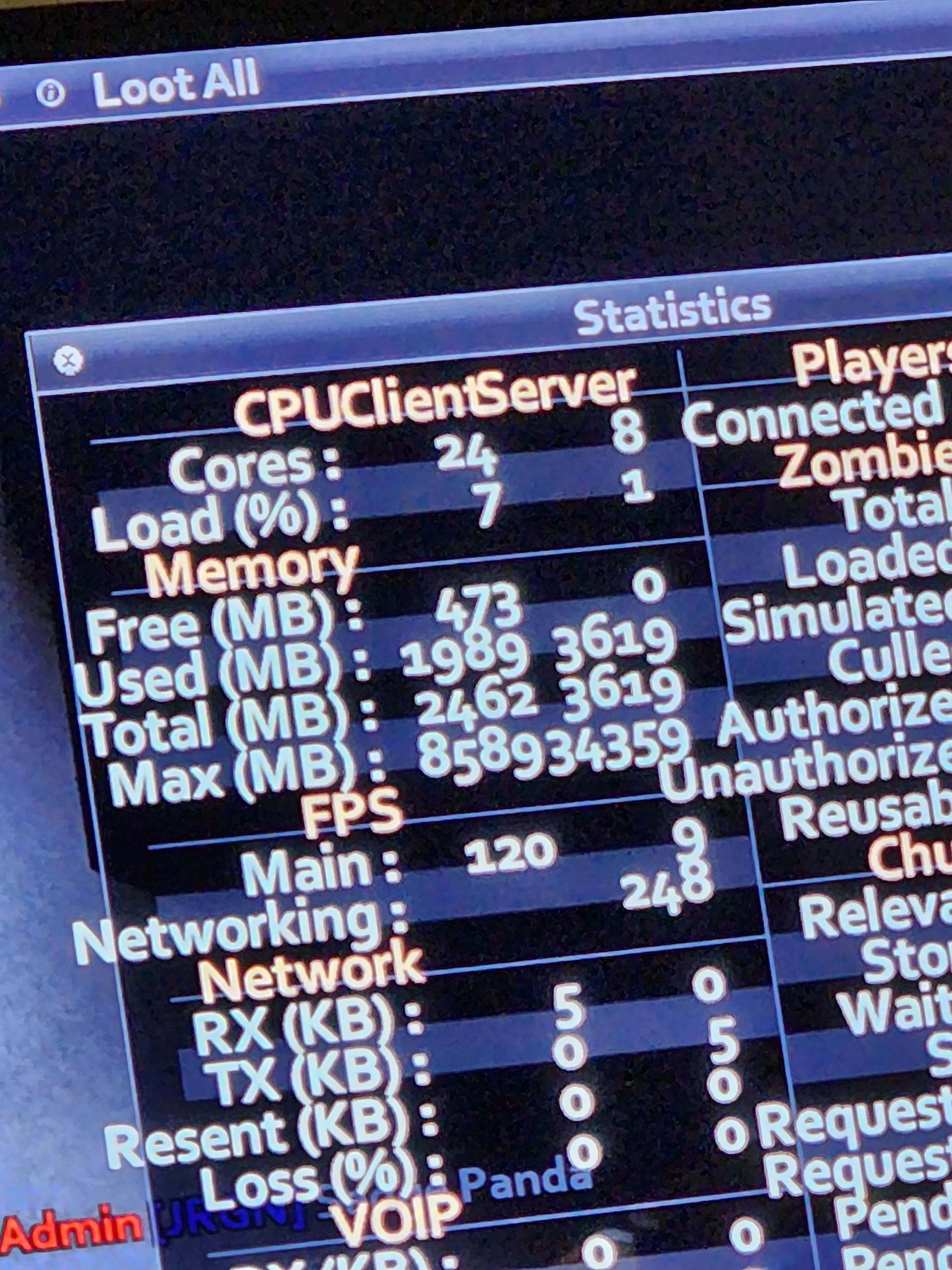

Hello,
I am using your Project Zomboid docker container and am curious how to allocate more RAM to the game instance. I have tried editing the .json on multiple occasions.
10 minutes ago, SadgePanda said:
Hello,

57 minutes ago, ich777 said:
The container or better speaking the game server should automatically manage it's RAM, why do you need more RAM?
IIRC the game is Java based, you can play with this values and append them to the GAME_PARAMS:
"-Xms" is the minimum ram assigned to java (but don't expect that if you set it to 10G that it actually consumes 10GB, it will only consume as much as it really needs but 10GB are reserved)
"-Xmx" is the maximum ram assigned to java
Append something like this to the GAME_PARAMS to set the minimum assigned RAM to 8GB and the maximum allowed RAM to 16GB:
-Xms8G -Xmx16G
I actually don't know if this will work but you can try, but as said above, the game should manage it's RAM allocation automatically.
That's the method I tried. And our group "needs" more max RAM allocated due to the events we run that are mod intensive.
The problem is when I make those edits and then start the container, the file reverts to 8gb max RAM allocation.

Absolute genius! I knew it would be something simple that I didnt check.
Turned off validation and reapplied the template, the changes stuck in the .json and when I logged into the server the new values are reflected in the server statistics on the admin panel.
Why did you even enable it? I think you also don't validate all games that you play on your local PC before playing... :P
Ha! No I dont, but I had initially followed the SPX Labs forum & video guide for setting up the container and server. Now I know!
