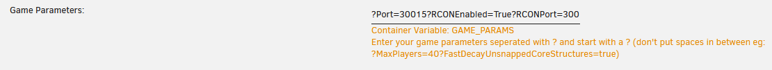

I have it installed and it shows that it's running just fine. However, I cannot get it to show up in the server browser.
As I'm looking through the GameUserSettings file, it doesnt seem to have a"listen" port listed, only the RCON Port.
So I added in the the port under the the ServerSettings portion of the file on line 27 as, "listen=30015" which is the port I assigned and forwarded.
Is this where I'm supposed to add it so that it shows up in browser..? Or what? Thanks in advance!
Because the container uses the basic listen and RCON port as it is specified in the template.
You should be able to do it like that but I would rather recommend doing it in the template like:
But please keep in mind that you have to delete the old port forwarding in the template and create new ones with the appropriate ports set with container and host port to the same as you've specified.

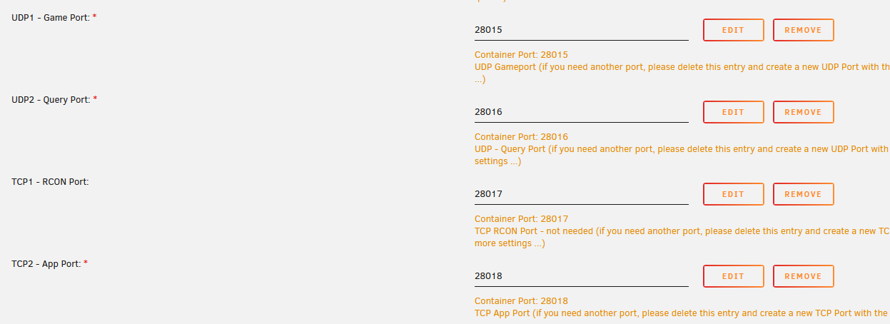

7 hours ago, bmayne81 said:
Hello, so I am to understand that Rust has changed networking settings with the latest industrial update that requires additional ports to be opened.
Thank you for the report, I've pushed an update to the container itself so that it supports the new ports too, please update the container first after that make sure that you have the following port mappings in your container:
Protocol   HOST Port         CONTAINER Port
UDP        28015     <->     28015
UDP        28016     <->     28016
TCP        28017     <->     28017
TCP        28018     <->     28018
I've also update the template now too, but existing installations have to create the port mappings on their own.
UDP        28015     <->     28015
UDP        28016     <->     28016
TCP        28017     <->     28017
TCP        28018     <->     28018
Thank you for updating this. I'm still having this issue with the server not showing up in the list though. Here's the error I'm getting right as the server finishes booting up. Does this mean anything to you?
  Yes when that pops up in my commands list it basically just as failed to connect to API The issue I'm having is I'm not connecting correctly to steam through anything I've just taken everyone's advice and deleted all the containers and all the data out of app data but still same results
In which list? The in game server list? Have you yet tried to add it to the Steam Server Browser as a Favorite (in Steam View -> Server Browser -> Favorites -> Add) with your LAN IP?
I haven't played RUST in a long time but I will try it today evening and report back if the new ports are working.
