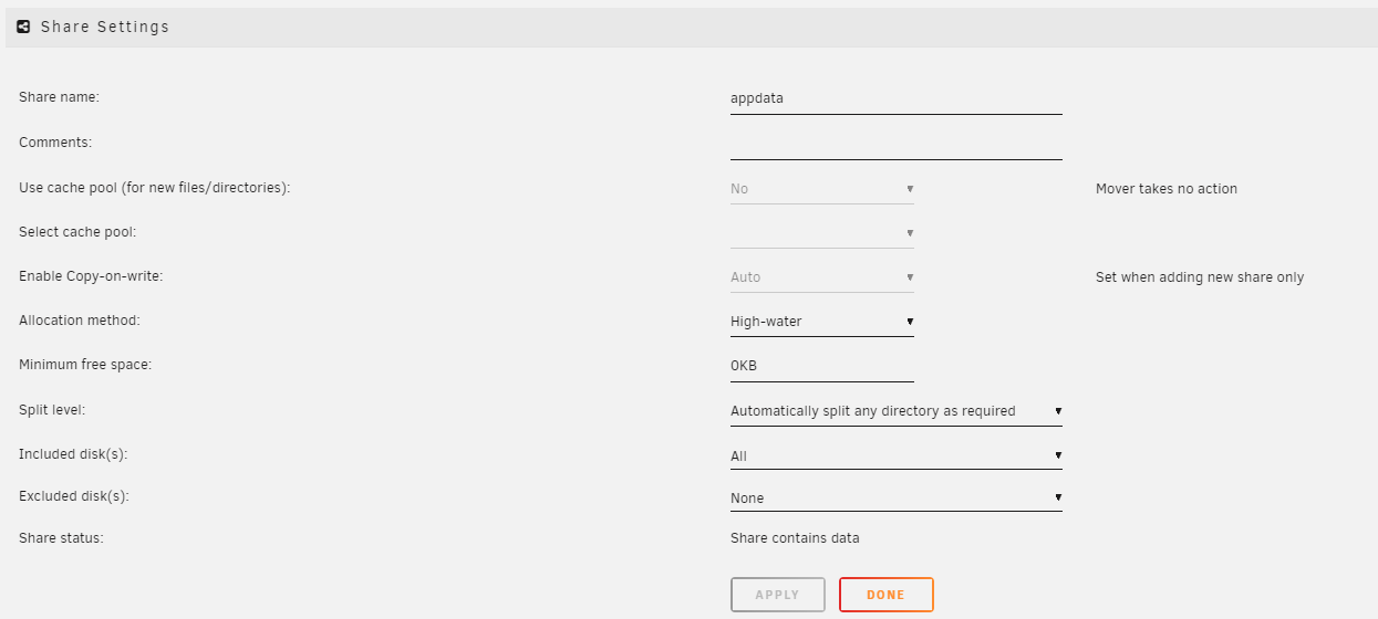

Hello, I am new to unraid and am having trouble setting up a Conan exiles server. It loads everything and then after downloading all workshop content is says "Something went wrong cant find folder 'ConanSandbox' putting server into sleep mode. Just attempted again without workshop content and got same result.
Edited by Zodicalpeak
Did you add your Steam credentials? If yes please remove it and start over.
Are all paths in the template set correct and is your appdata directory set to use cache only or prefer in the share settings?

Attached is my appdata share settings. I reinstalled the docker and am leaving all the settings as default do I need to change them do something else?

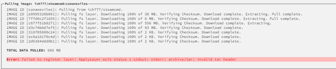

Just now, Zodicalpeak said:
Attached is my appdata share settings. Also attempting to reinstall the docker and got this error
