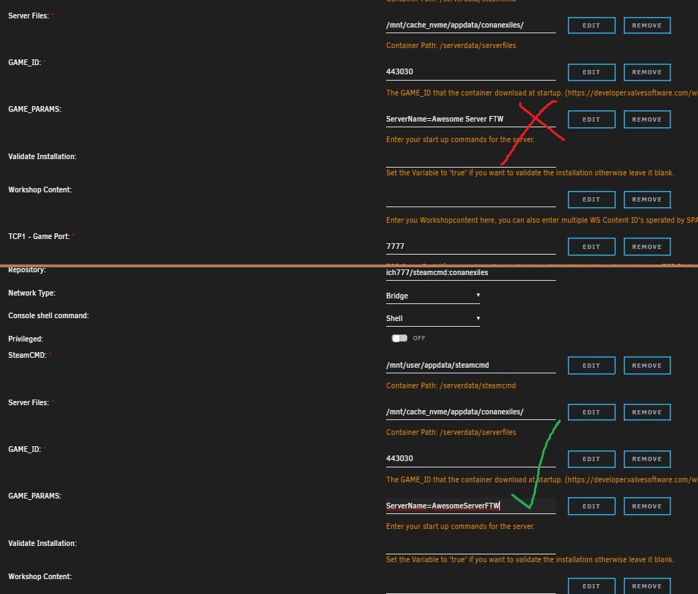

How do I pass additional server specific parameters into the Conan Exiles docker?  There is some sort of formatting issue I am running into
GAME_PARAMS takes "ServerName=test111" just fine, but not "ServerName=Test TEST".  No spaces.
Ich , do you know how to pass more than one set of variables to the Conan Exiles docker, which may or may not have spaces?  I don't want to have a server without spaces!  And I also need to pass other variables like serverRegion=US
May I ask why do you want to do that in the GAME_PARAMS?
Just edit the Engine.ini and it should work just fine and it should have all the parameters in there by default if I'm not mistaken.
By default the file is located in:
.../appdata/ConanSandbox/Saved/Config/WindowsServer/Engine.ini
This is way easier and not that tedious.
Anyways you should be able to pass it over with:
-ServerName='Name with spaces' -ServerRegion=US
(but I'm not too sure if these are the right parameters for ConanExiles, it should also work with:
-ServerName=Name with Spaces -ServerRegion=US
You are missing the -

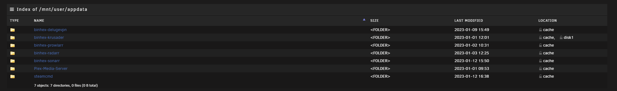

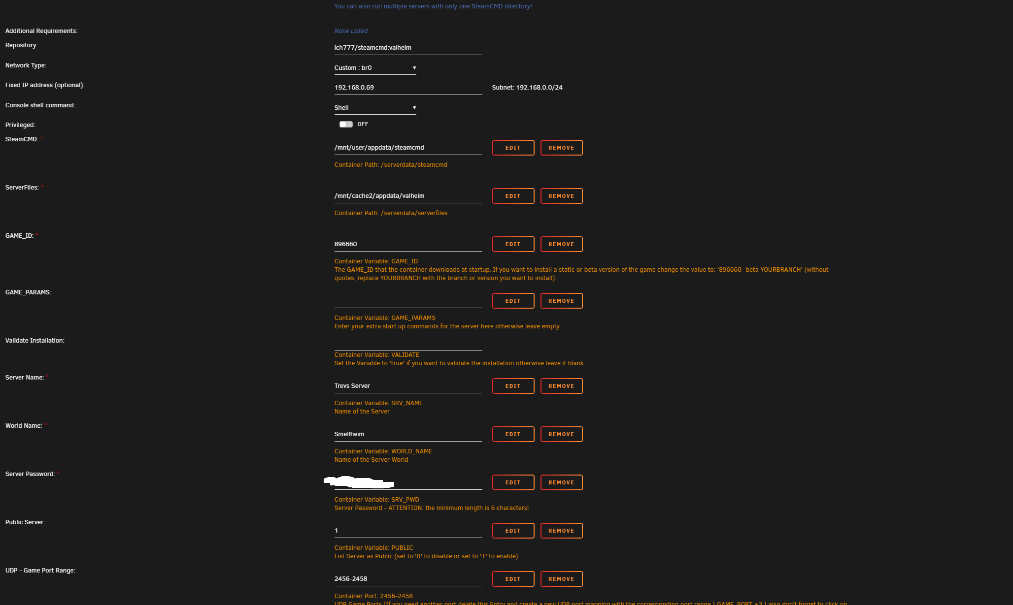

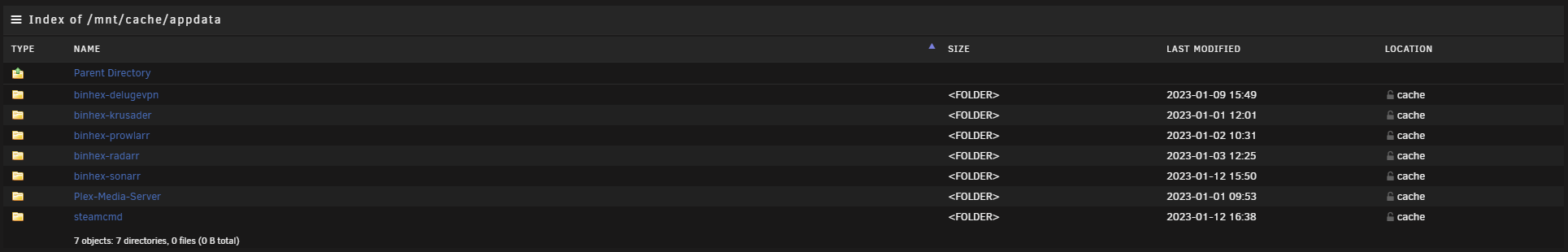

Apologies if I'm dumb or this has been answered before;
I can't access any of the server files, or even see a location that matches what my container path is set to, picture belowimage.thumb.png.3204cc4aa494c3bbb65b2aaf5ec6be99.png
below is a picture of the directories in my appdata, as you can see there is no valheim directory
and here you can see inside the cache drive appdata directory that there is still no valheim sub folder
None of the steamcmd folders have a valeheim directory. The server is currently functioning fine, but if I ever have issues and want to restore a backup I have no way of accessing the files. Can anyone help me figure out where it is reading and writing to? My only other hint is that my cache drive generates read/write numbers while the server is running, indicating that the files are in there somewhere. I just cant find them.

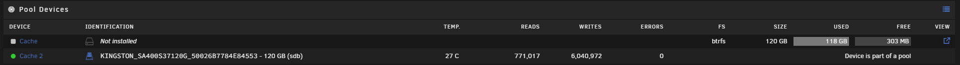

Are you sure you actually have a pool named 'cache2'? Usually cache2 would be the 2nd disk in a pool named 'cache'.
my cache pool is named "cache" and I only have drive 2 installed right now, "cache2"
A multi-disk pool is a single volume. You can't access these disks separately. So /mnt/cache2 isn't a path to storage (it would be a path created in rootfs, which is in RAM). The correct path to that pool would be /mnt/cache
Thanks, I can't messed that up. After fixing the path, I can now see the directory. Lost the world on the broken filepath though. Sucks but it was only a couple days of play.
