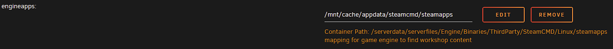

On 1/7/2023 at 7:38 PM, devnet said:
BTW,
I was unable to mount to the path for engineapps...Error message was as follows:
Error response from daemon: invalid volume specification: '/mnt/smbcache/appdata/ark-se/steamapps/: /serverdata/serverfiles/Engine/Binaries/ThirdParty/SteamCMD/Linux/steamapps :rw': invalid mount config for type "bind": invalid mount path: ' /serverdata/serverfiles/Engine/Binaries/ThirdParty/SteamCMD/Linux/steamapps ' mount path must be absolute
Here's the issue once I connected to the docker console:
# ls
'Linux '   Win64
# cd Linux
sh: 7: cd: can't cd to Linux
# cd 'Linux '
# pwd
# ls -lrt
total 4
-rwxrwx--- 1 steam users 1212 Oct  6  2021 steamcmd.sh
drwxrwx--- 1 steam users   14 Nov 25 16:23 siteserverui
drwxrwx--- 1 steam users 1690 Nov 25 16:23 public
drwxrwx--- 1 steam users   28 Dec  2 18:42 linux64
drwxrwx--- 1 steam users  224 Dec  2 18:42 linux32
drwxrwx--- 1 steam users  728 Jan  7 20:32 package
So it seems there is a space in the name for this path.  This prevents the volume from being mounted as the volume path has to be absolute.
Not sure where the name Linux is set nor by what or how but it will change how we have to map the volume.
/mnt/YOURCACHE/appdata/ark-se/steamapps/ will now have to be mapped to /serverdata/serverfiles/Engine/Binaries/ThirdParty/SteamCMD/Linux /steamapps
@devnet When you did the mappings for the engineapps, did you accidentally include a space after Linux?
The container path should be:  /serverdata/serverfiles/Engine/Binaries/ThirdParty/SteamCMD/Linux/steamapps
From what I can tell that is the only place where the space could have been added that would cause this issue.

@devnet can you check your path setup to make sure there isn't a space at the end of the container path?
There definitely is...because inside the container, the directory is 'Linux '
root@86753OHNeeeeeyeeeine:/serverdata/serverfiles/Engine/Binaries/ThirdParty/SteamCMD# ls -lrt
total 0
drwxrwx--- 1 steam users  24 Jan  9 15:05  Win64
drwxrwx--- 1 steam users 118 Jan  9 18:48 'Linux '
Tested something on this...renamed my /mnt/cache/steamcmd folder and then edited my container to remove the spaces.  This time around I get 3 directories in that path:
total 0
drwxrwx--- 1 steam users   0 Jan  9 12:19 'Linux '
drwxrwx--- 1 steam users 118 Jan  9 19:01  Linux
Edited by devnet
Just as an FYI...I changed all my /mnt/user paths to /mnt/cache...I then deleted everything to start fresh.  I was able to manually load the plugins by copying them over from my Windows Steam client after hosting a local game with the plugins I wanted enabled.  To do that, I had to subscribe to the plugins in the Steam workshop and then enable them when hosting the local game.  Then I did 'Manage' on the game in my steam library and was able to browse the file location, grab the mods, and copy them to the container.
Still can't do -automanage....it just causes an infinite reboot loop.
Edited by devnet

Good call on changing to /mnt/cache, I didn't even notice one of my paths was setup that way until it was pointed out in a previous post, thank you @ich777 & @devnet.
I cannot say that I have ever run into the loop issue you are having.  Just a little bit ago a started a brand new server from scratch installing it to a completely new folder for both the server files and steamcmd.  I put in all the custom path mappings making sure to modify them to my new paths for the new server and steamcmd directories and used the same exact settings in my Game Parameters and Extra Game Parameters including the -automanagedmods flag.  Here is what I have for my "Extra Game Parameters":
-server -log -automanagedmods -NoBattlEye -crossplay
If it still gives you the loop, then take the -automanagedmods and then continue on as follows.
After the docker template is setup, let the docker launch so that it can download all the files and start the server.  The first run you will not have any mods because the GameUserSettings.ini file will be generated upon the first startup.
Once the server starts up, I check to make sure it shows up in the server browser in game.  You will note that the column "W/Mods" will be blank at this time.
Then stop the server and edit your GameUserSettings.ini file adding the ActiveMods= along with all the mods you want separated by a comma.
Launch the server now and give it some time to download the mods.  You should be able to open the logs of the docker while it is running and see messages like "Downloading item 1999447172 ..." for each mod you have listed in your GameUserSettings.ini file.
I'm wondering if one of your other custom paths still has an extra space after Linux.
After the new server was setup I checked my directory and this is what I have:
total 0
drwxrwx--- 1 steam users  24 Jan  9 17:14 Win64
drwxrwx--- 1 steam users 118 Jan  9 20:21 Linux
After booting the server with mods, check this folder from the console of the docker to see if you have the "workshop" folder.
/serverdata/serverfiles/Engine/Binaries/ThirdParty/SteamCMD/Linux/steamapps# ls -lrt
total 8
-rwxrwxrwx 1 steam users 220 Jan  9 20:21 libraryfolders.vdf
drwxrwx--- 1 steam users  84 Jan  9 20:21 workshop
If the workshop folder is not being created in the "Linux" no space directory but is going into the "Linux " with the space directory then there is most likely an extra space somewhere in one of the custom path configurations.
Your container mapping in the template seems off.
As @DBone-Unraid said, check if you don't have a space at the end of your path mappings in the template, most likely that you've copy pasted it and a space at the end at the container path.
