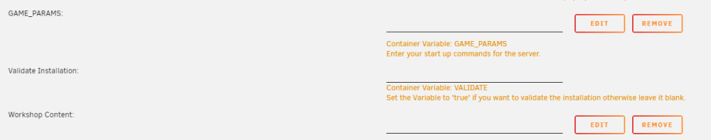

When you say the Variable WS_CONTENT in the template your just referring to this rightimage.thumb.png.07bb564a0e9e7ed9d810913dd0f13e37.png
I tried it with some mods but yea it got stuck in a loop so now I am going to try each mod until I find the one thats not working. Is this all I need to do for ws content though? Just add the Mod id?
Yes.
Yes.
17 minutes ago, ich777 said:
Yes.
Yes.

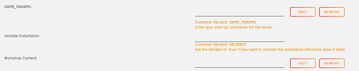

Ok sweet before I get off for the night are either of theses important or need to be changed? I have just left them blank. Thanks for all your help!image.thumb.png.d3c1f45a131e8f10bc852e52096d83df.png
Depends, GAME_PARAMS are appended on start from the dedicated server, usually you don't need anything in there, this is just if you have some weird mod or want to add a start parameter for whatever reason.
Validate installation is basically the same as if you validate the game files on Steam (please never set this to true without a good reason because this will slow the start process from the container because it checks the game files if set to true on every container start).
Explained WS_CONTENT above, if you don't need it, let it empty.
