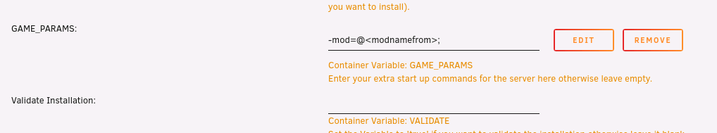

DayZ server-
How exactly do I add mods and have them load during the startup of the server? Any help would be appreciated, total noob with DayZ and it's hard to find help since I am running it on unraid.
Can you give me a guide on how to install mods so that I can look into it, but basically it is not different than doing it on a bare metal Linux server, you just have to put the files in the right directory in your appdata folder.
Now that I think of it, I might have answered this question at some point in the past here.
How-To Add Mods To A DayZ SA Server – The Dead Return (wordpress.com)
here is one example, I think I am just confused on where to store them, and then how to activate.
42 minutes ago, Neldonado said:
here is one example
But that's for Windows from what I read...
Anyways, from what I see, download the mods locally on your PC, go to the download location, grab the folder named <publishedid>, place them into .../appdata/dayz/<publishedid>, then go into the folder .../appdata/dayz/<publishedid> open up meta.cpp file and locate the modname, go back to .../appdata/dayz, rename the folder <publishedid> to: @<modnamefrom_meta.cpp> and then finally add this to your GAME_PARAMS:
if you have more mods installed it should look like that:
Please note that things in < and > are just placeholders and everything including < and > alongside with < and > needs to be replaced with the publishid and/or modname.
I'm also not too sure if mods for Windows will work on the Linux server which my container is using.
Hope that helps (that is basically what this article tells you).
I found this: https://steamcommunity.com/sharedfiles/filedetails/?id=1517338673
in this Linux guide it says It will look for the Workshop ID in the '.workshop.cfg' file.
do I just need to create that file?
This won't work because this is a completely different script that is custom and not part form DayZ itself.
You have to do it manually like I've described it above.

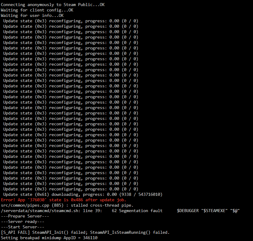

Anyone else having issues with V Rising since last major GLOOMROT update?
I had a server with this docker running about a year ago and now wanted to give it a go again with the new update. I can join from LAN however my friends cannot join from WAN. Only getting "Authentication Error" and in log file from docker i see "src\steamnetworkingsockets\clientlib\steamnetworkingsockets_lowlevel.cpp (794) : Assertion Failed: GetBestRoute2 failed with result 50 for address 'XX.XX.XX.XX:0'" Ip redacted with XX.
Have tried multiple different settings but nothing that solves it. Any ideas?
I will try that when I got home from work today and report back.
Thanks  @ich777 I even tried renaming both SteamCMD folder and vrising folder so the Docker would redownload everything from scratch, but that did not solve it unfortunately. Running the V Rising Dedicated Server from Steam on my main Windows 11 PC works. So my spontaneus guess is that it has something todo with Linux SteamCMD, but I don't know. Please report back when you can, add me on Discord if you like to troubleshoot together. #truetype @ discord.
Edited by truetype
I have now tried it and I can connect just fine, please note that I connected directly to my public IP and that I not waited to search in the server list for the server to appear.

Thanks for testing. But strangely I tried that yesterday aswell.. So how did you make the fresh install when you had a previous install? Did you delete the old V-rising Docker template on the USB aswell? But I will give it another go again in about 2-3 hours.
I have a second instance on my server but not running, you just have to change the path to the game files if you want to test a second instance, of course the name and also make sure the first instance is not running because otherwise you will have a port conflict.
Maybe you also have to allow installations from multiple instances from a template in the CA App Settings (you find that directly in the CA App on the left menu where it says Settings).
No, this would make no difference if you pull a fresh copy from the CA App. But anyways, this would also change nothing because the template never changed since I've made it back then I think.
