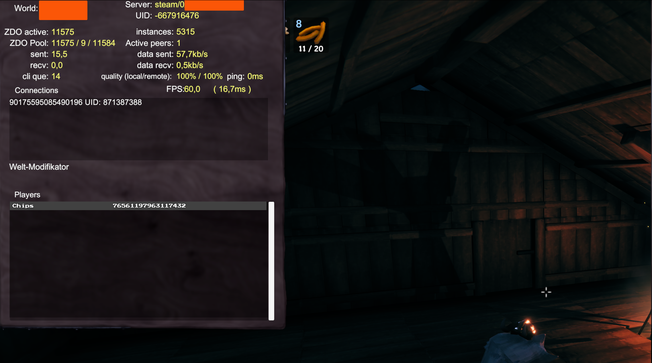

I have now tried it and I can connect fine to the new version.
Are you sure that it doesn't show up in the steam server browser? How much resources does the container use?
If it looks like this it is running and waiting for connections:
Here is also a screenshot:

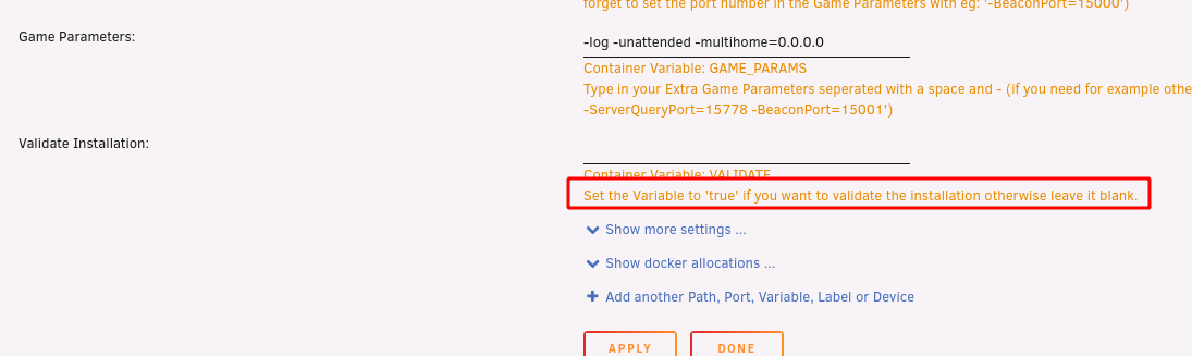

Have you yet tried to force a update by setting validation to true (please don't forget to disable it again after it pulled the update)?

Have you yet tried to force validation?

Please go into the Docker template and see this:
